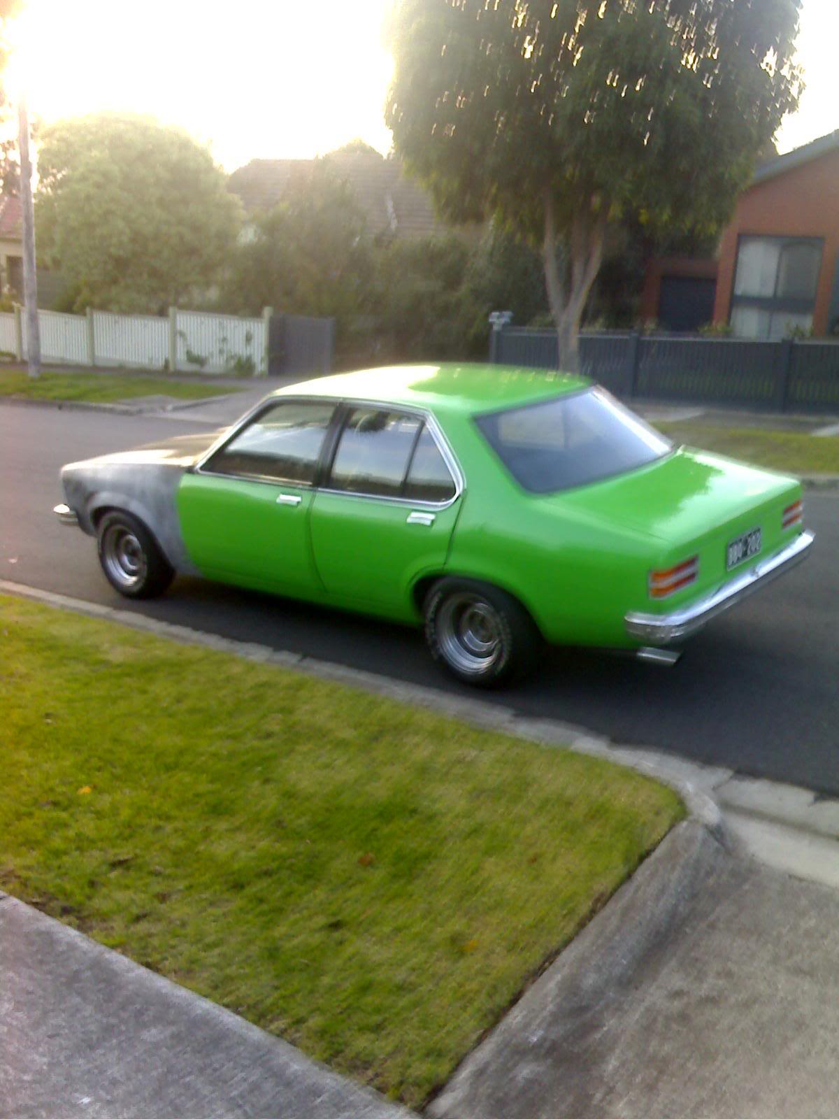

Changed my front springs and shocks... I didn't have a spring compressor and I just did the best i could manage with basic tools
Basically, the springs were 1/4 of a turn (90deg) from sitting properly in the bottom wishbone... they aren't properly seated. I may have been able to improve that if I had nice compact spring compressors, but I don't know if it would have made a difference.
When I initially dropped it on the ground, it sat very high, as I expected. After a 5min drive to the girlfriend's place though (over lots of speedhumps), it seemed to be sitting better, at least on the passenger's side.
Will the springs turn, and work their way into the correct position, by just going over lots of speedhumps and shit? Or will I need to pull it apart and try and get them to sit properly?

What size springs did you put in? Standard ones are near on impossible to get in without help... But shortened ones are normally a piece of piss to change. By the looks of it though.. The car is sitting pretty well on that side.

Yeah well sitting next to the original springs, they were missing about a coil and a half i think... they were fairly short, but i just couldn't get that tang sitting at the back; i couldn't turn the spring far enough, pushing the wishbone down further didn't help, it was just because of the angle between where the spring sits in the top, and in the bottom.
I thought that part of it would have been a lot easier, but i thought the job wasn't as hard as people explained it to be. It does take a long time though hahaha i just sat there and tinkered away for ages until it was back together.
