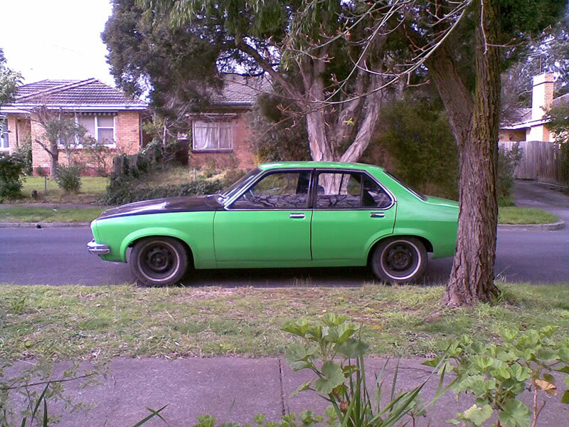

Matt, in response to your comment. This is how low the car was:
lol

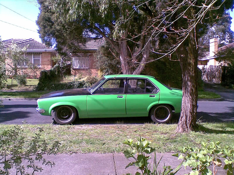

This is it fixed:

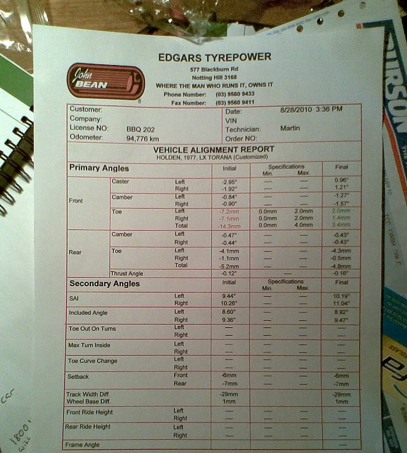

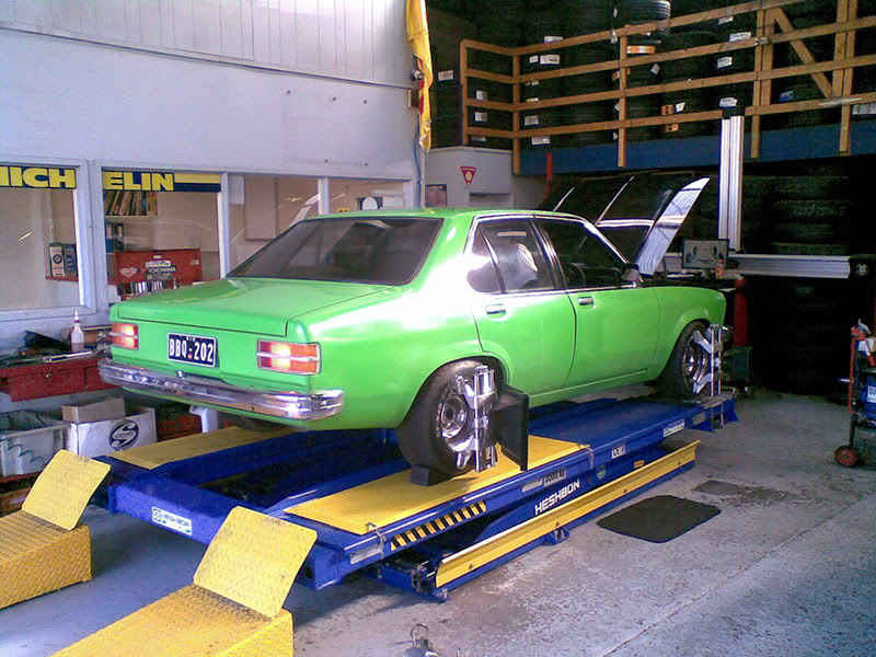

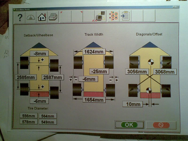

Yesterday I took the car in for a wheel alignment. The third time I've paid someone to do work on my car. After buggering around with the upper arms and putting them on left to right (they are theoretically symmetrical - not UC arms - just obviously distorted a bit from braking forces I dare say) it was pretty clear I had some negative caster, and I could see the toe was up the shit because of the tie rod angle after altering the ride height. Good thing I didn't piss fart around or I would have stuffed a pair of tyres haha
So yeah, a bit of toe-in (which I can easily adjust myself if I want to follow 76lxhatch's advice), some positive caster and negative camber (all around lol half a degree on the rear wheels wooo!)

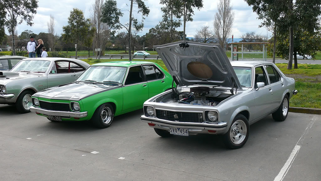

So that and the polishing overall puts me in a position where I am pretty happy with how things are with the car. Because I was so happy with the car, I took it down to a car show in Narre Warren today at the Retro Speed Shop (where I organized to meet BlownOutlaw too as he was in Melbourne today)
And to avoid confusion, I should say that no that isn't his car, just one that parked next to me at one point during the day - his is still in the works :)

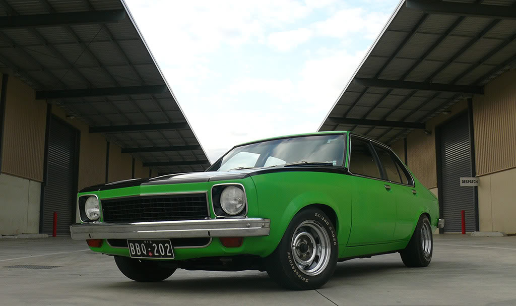

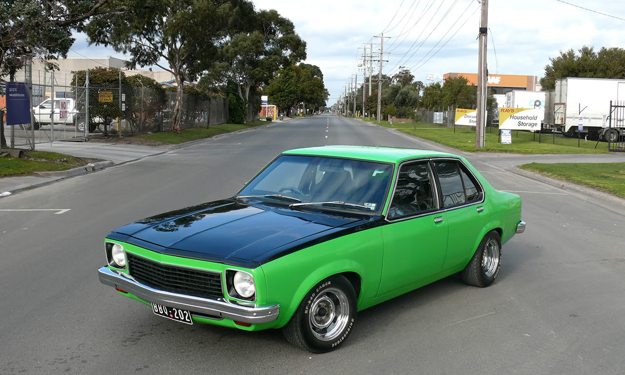

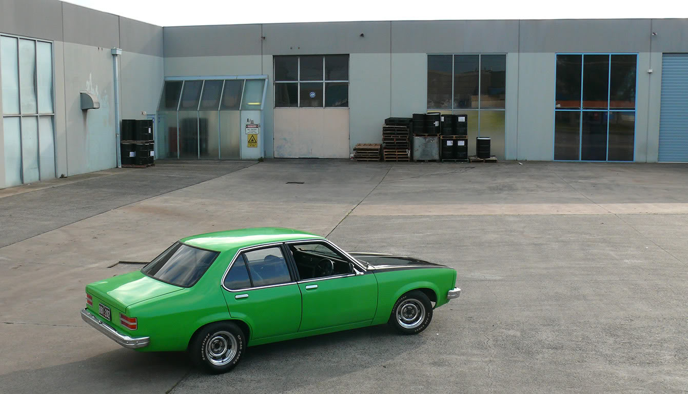

Ohh yeah and on the way home I went through an industrial area and got myself some photos that I think are alright. I borrowed my friend's Lumix - it's just a bridge of some description and just did some really basic editing in Photoshop
