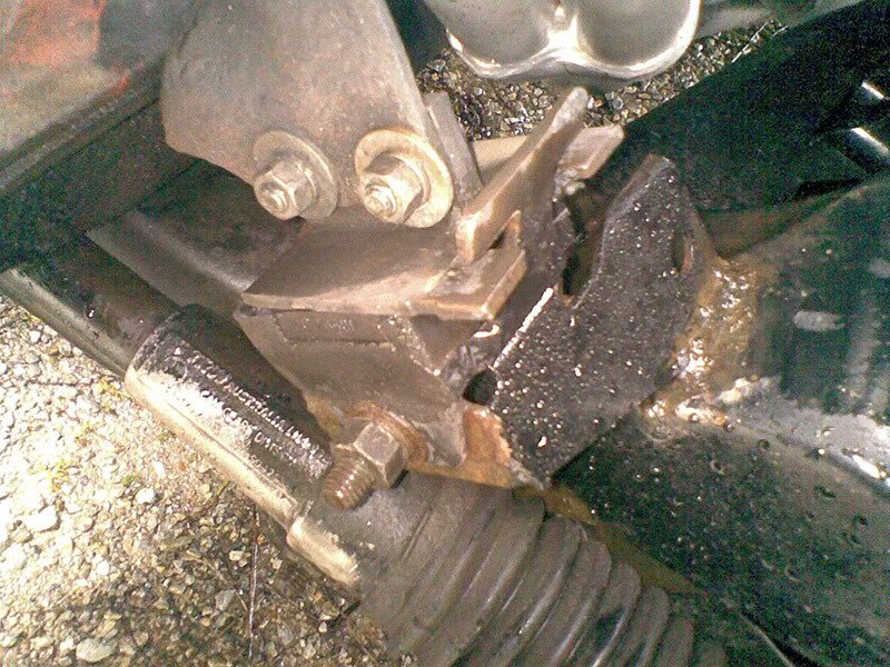

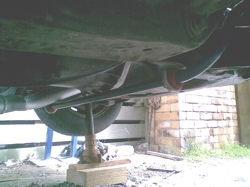

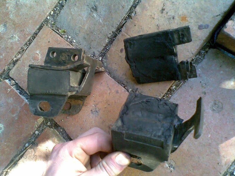

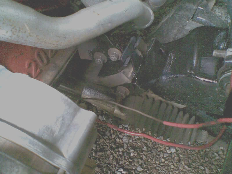

As Rob kindly pointed out on the last page, I managed to break an engine mount from too many burnouts. Before I installed the replacement, I 'adjusted' it a little bit as per rodomo's suggestion, this is just to limit the movement in the rubber joint before the T-joint jams tight. I'm not sure if the forces & vibration will open this back up again but I won't know until I do more clutch dumps and see the results. Anyway, the idea is to avoid over-stretching the rubber joint on the 'tension' side (pass side).

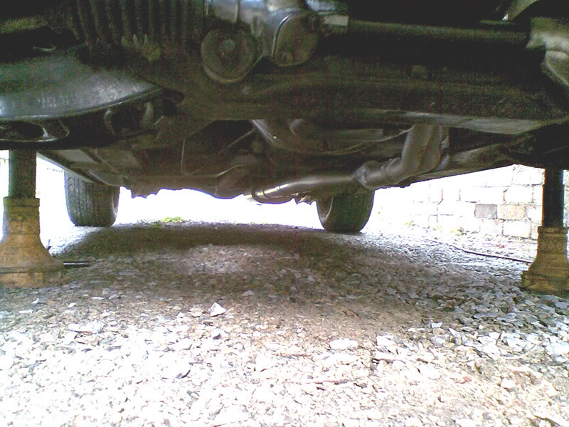

This is just a photo of the adjusted exhaust with Brad's old extractors which provide much better clearance near the engine mount, bellhousing, swaybar and general ground clearance.
And this is just the swaybar bolted on

Jesus! Nice work Heath! Could you feel that it was broken?

get a small chain maybe 5 links long and bolt it to the inside and bottom engine mount bolts, it'll stop the travel and will catch it if the mount breaks.
its more painfull when su's or webers come up and smack the bonnet hehe.
#1754 Heath
Posted 09 September 2010 - 10:32 PM
Mick, there was just a 'tick' sound when you got on the loud pedal. That was why my bonnet is a bit dinted as well :(
Kevin, if I get some proper power I will probably just make up a proper engine mount for the tension side. But your suggestion isn't a bad idea for simplicity's sake.

whats the rest of your exhaust Heath? size/muffler?

Ohh didn't you tax my 173 engine mounts? Are they the ones that broke or are you replacing the broken one with mine or something? I remember they were in pretty good nick.
#1757 Heath
Posted 10 September 2010 - 10:29 AM
Yeah one of your old 173 ones broke, the driver's side one is still fine. Swaybars are the same colour as each other. MCH11N, just a pretty generic 2-1/4" single system with some semi-straight through at the arse end with a flanged turn-down. I had a full tail-pipe on it but it made it sound a bit muffled so I put the turn-down on.

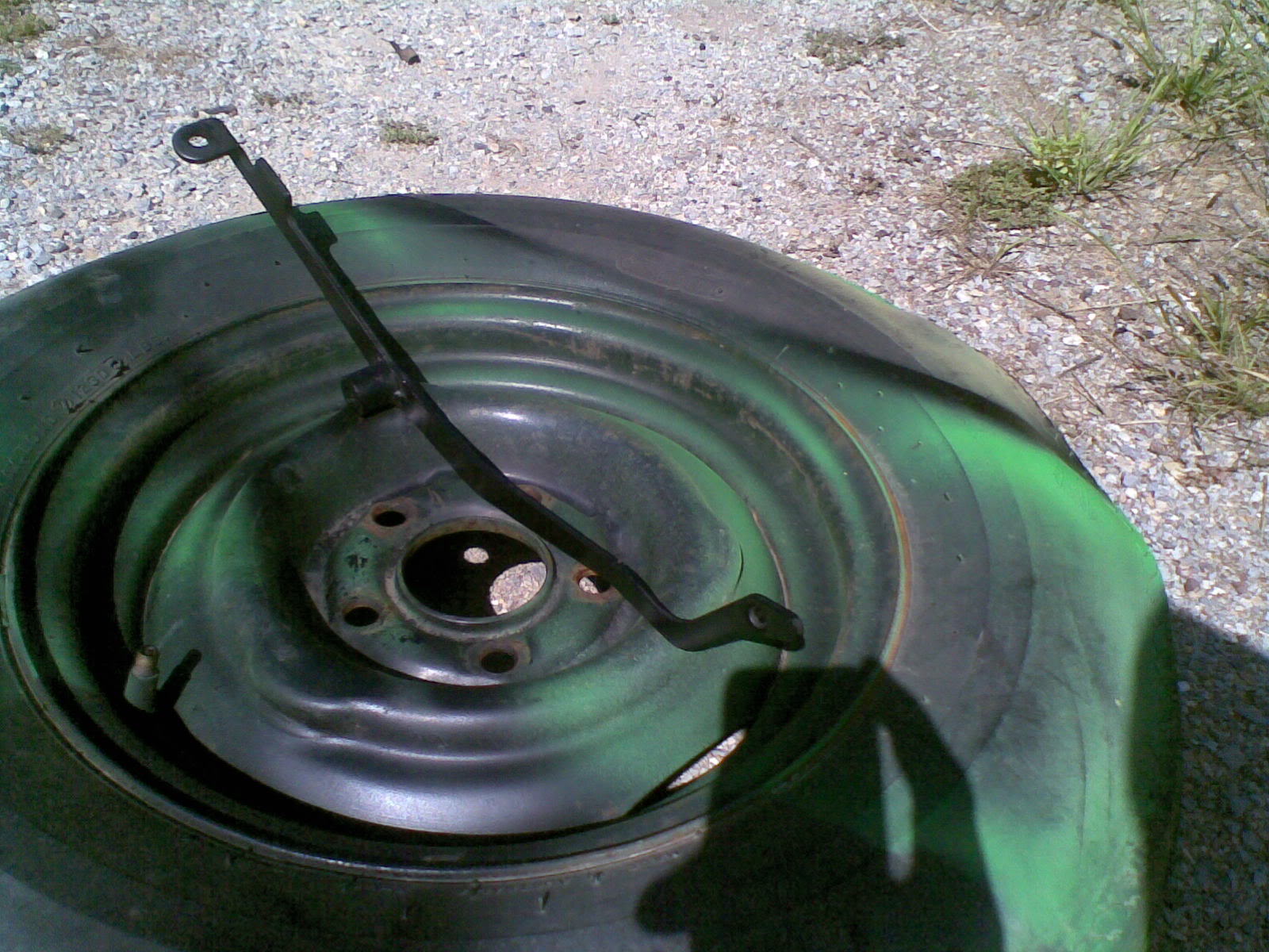

Ok Heath, time to do some measuring. We need to find out the size of the centre hole on your rims.
I just stumbled across these beauties, they are steel, push-through bullet caps. They come in 3 sizes:
Small: diameter 74mm
Medium: diameter 80mm
Large: diameter 83mm
Height is approx 115mm
$45 a set!!! CHEAP AS!! What are the chances they might fit??? If not, it shows the right style to suit your rims...
Thoughts??

I think I already said this to Brett in person (clearly not here), but that style of centrecap definitely won't fit on the front of my car, as the fitment is hub-centric. And honestly, I reckon that style is a bit tacky on anything but a custom. Still looking for some cheap standard style centrecaps and I'll paint em up & make up some nice buttons for the centre of them if I get bored.

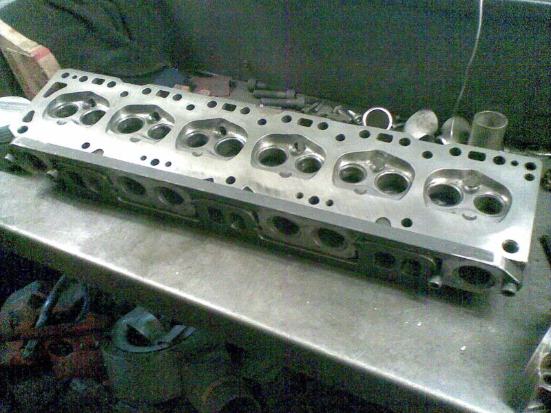

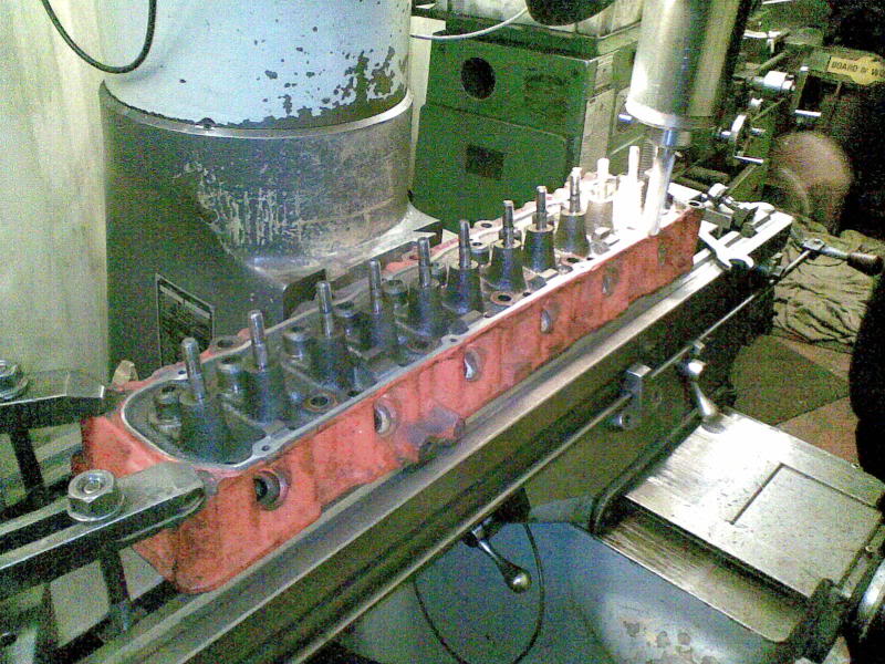

This is an old 173 head I got my hands on. This was just set up on the mill to skim the rocker cover mounting surface. The head has been ported & modified in the combustion chambers now, the valve guide axes have been shifted and it's going to be fitted with bigger valves and hardened exhaust seats obviously. Will have to get some photos later on but that will be bolted on before March next year, with a lump stick.

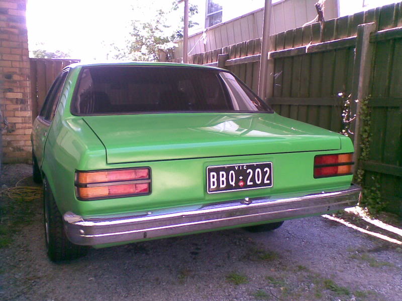

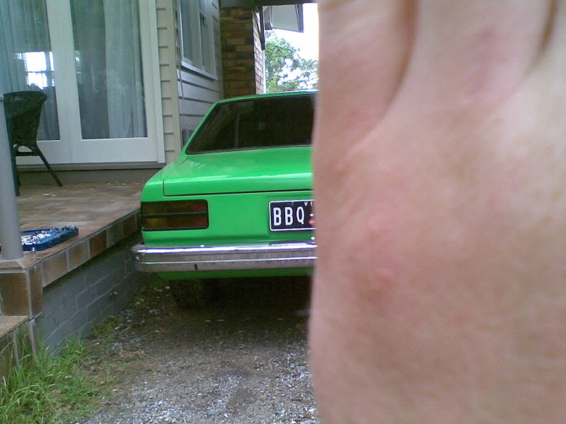

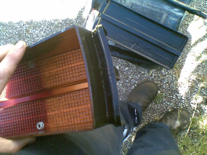

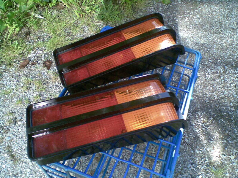

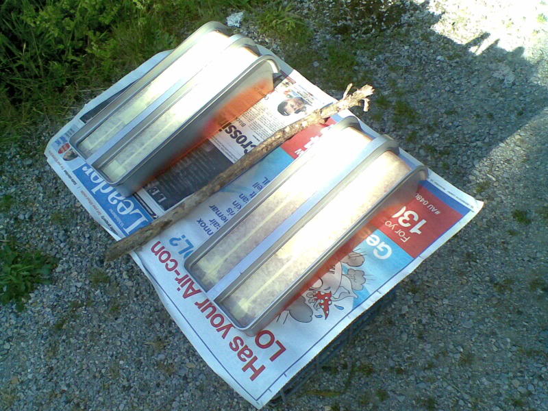

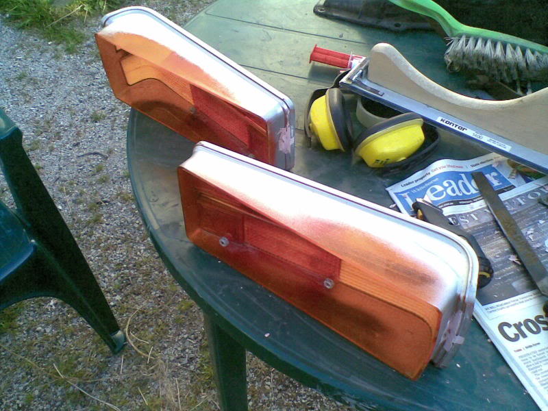

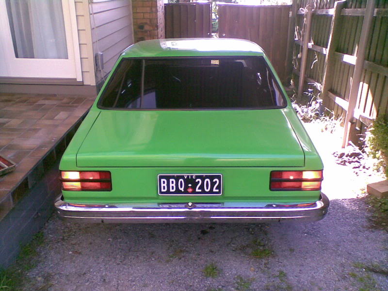

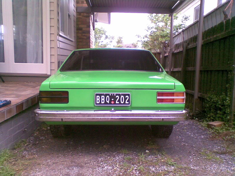

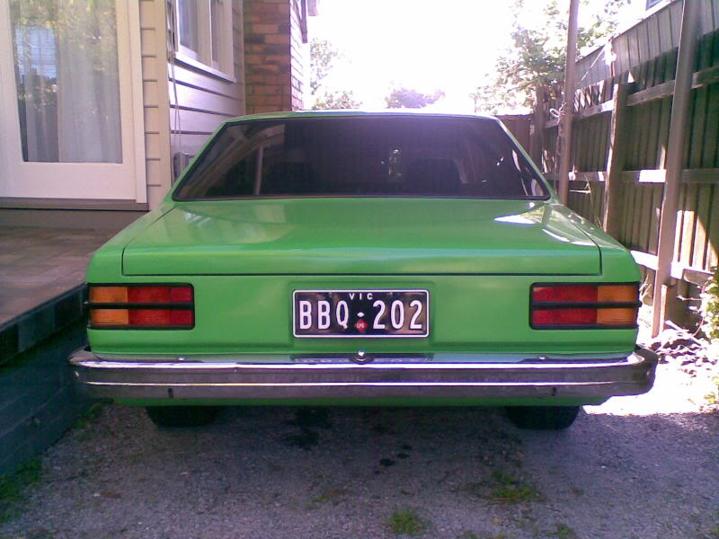

What do you think of tinted tail lights? They are some really stuffed lenses that I did up and I reckon it looks pretty mean (would look better if the light wasn't stuffed beforehand but I didn't wanna destroy a perfectly good one for a test)
Anyway, for now I just yanked out the silver ones, filled the holes on the back and gave them a squirt with a rattle can. Shoulda got the gun out, spraying with cans is shit as on this kinda thing

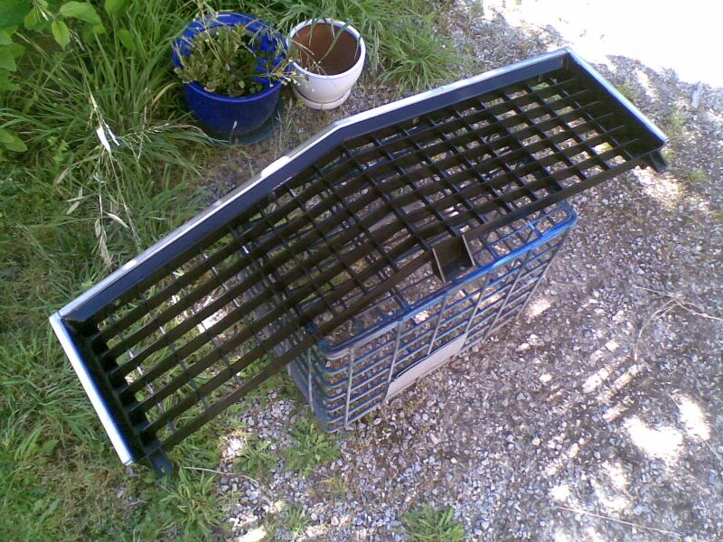

Also spent a long long long time sanding this grill back and painting it again because lots of highway ks had chipped it real bad.

Tail lights came up really nice. Mine are tinted a bit and I like them
#1763 Heath
Posted 21 November 2010 - 12:32 PM
Yeah I think I'll darken a pair of light backing things (where the globes clip into) and see if that gets the desired effect. I don't want it to be over the top, like those black VYs you see with lights that blend in with the body. Ugh!

I think the cleaned up untinted lights look best.

why does your 173 head have the press in studs Posted Image
wadda ya mean valve axes have been moved?
ive always wondered whether machine the rocker cover sealling surface would actually help.
and did you get my last pm?
#1767 Heath
Posted 22 November 2010 - 10:00 PM
Yeah it definitely does but some rocker covers don't like you taking away the height of the surface if your gasket isn't thick enough to hold the edges/border away from the cast area of the head. And oops that work was done to a few heads in the one session that day hahaha, now that you mention it, I'm not even sure what head it is but I think it's off a 186, musta got my photos mixed up. It's not one that I own anyway. How's this instead - this one is definitely going on my car :)
By valve axes being moved I mean the valves now sit in a slightly different place in the head lol, helps when you are installing large valves that the shrouding isn't as severe, amongst other things. That photo is pre-seat-work (like... the seats don't even line up with the guides)
I replied to the PM you sent me on the 7th. If there have been any since then, I don't think I've received them.

Yeah haha well I'm not that sneaky. They aren't canted or anything, just offset a bit on the mill.

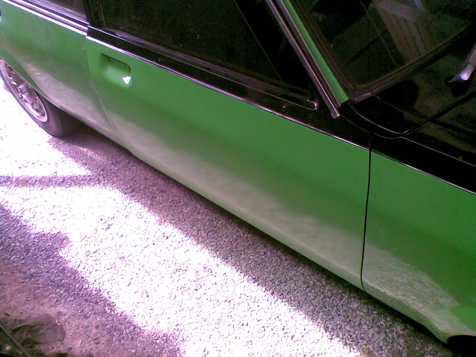

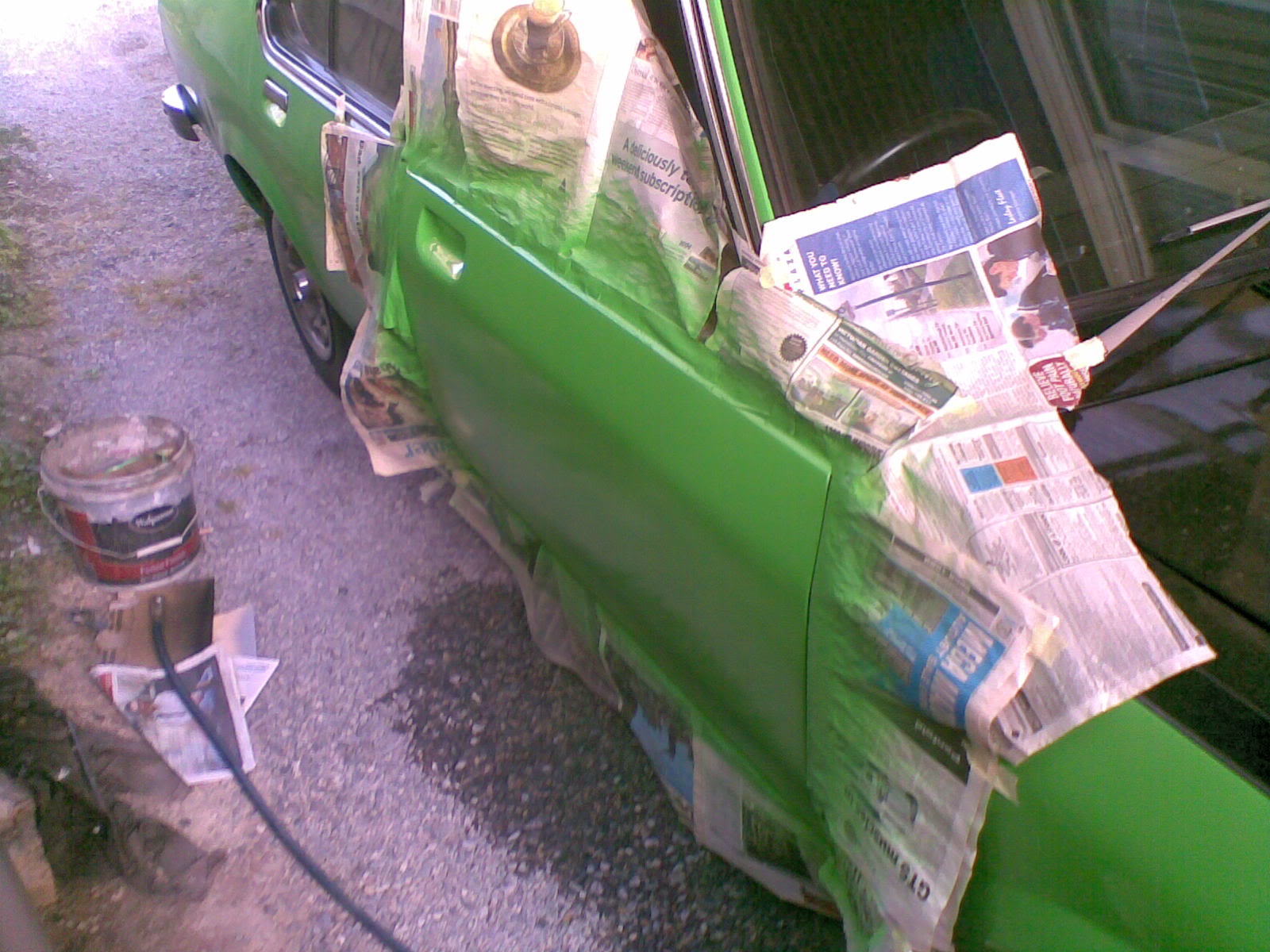

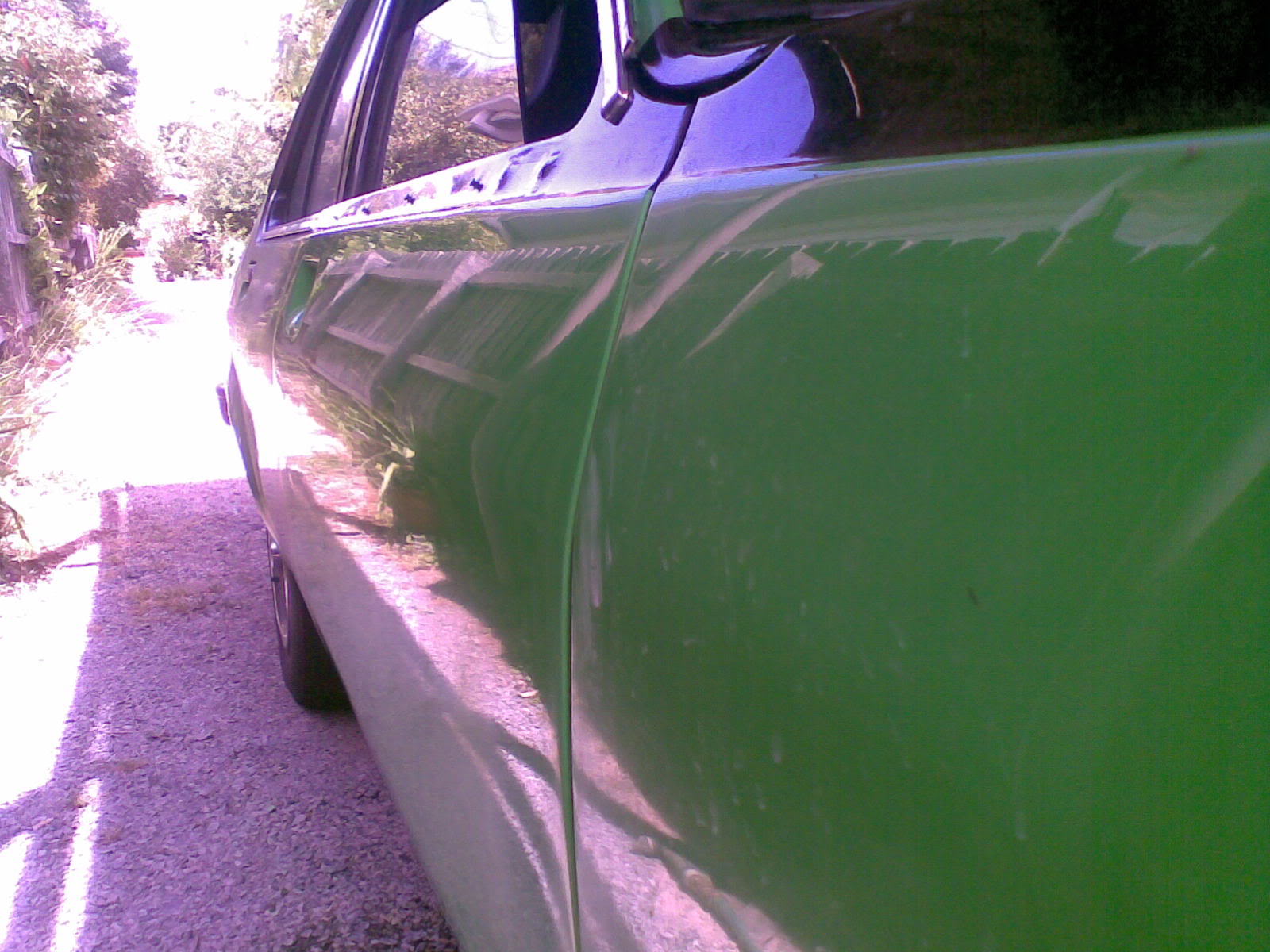

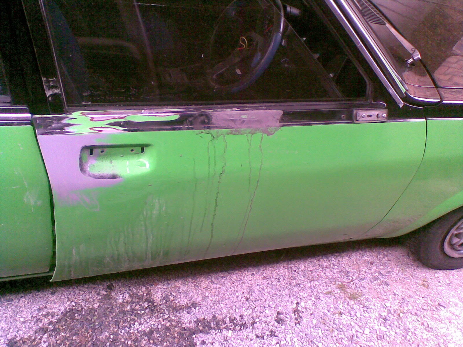

I've done a few things on the car in the last little while. One of those things was getting rid of the 'faildoor' - the driver's door that had obvious imperfections that stood out like dogs balls.
Fixed up the little dint and got rid of some crows feet happening on the black, and resprayed both.
Polished it the next day, waiting for it to dry for weeks seemed un-necessary. Looks fine.
The paint matched the front end awesomely but everything rear of it is slightly off, but there is no obvious transition on the other side at all. Anyway, much better than it was IMO. But you can tell I didn't pay someone $15k for my duco hahaha.

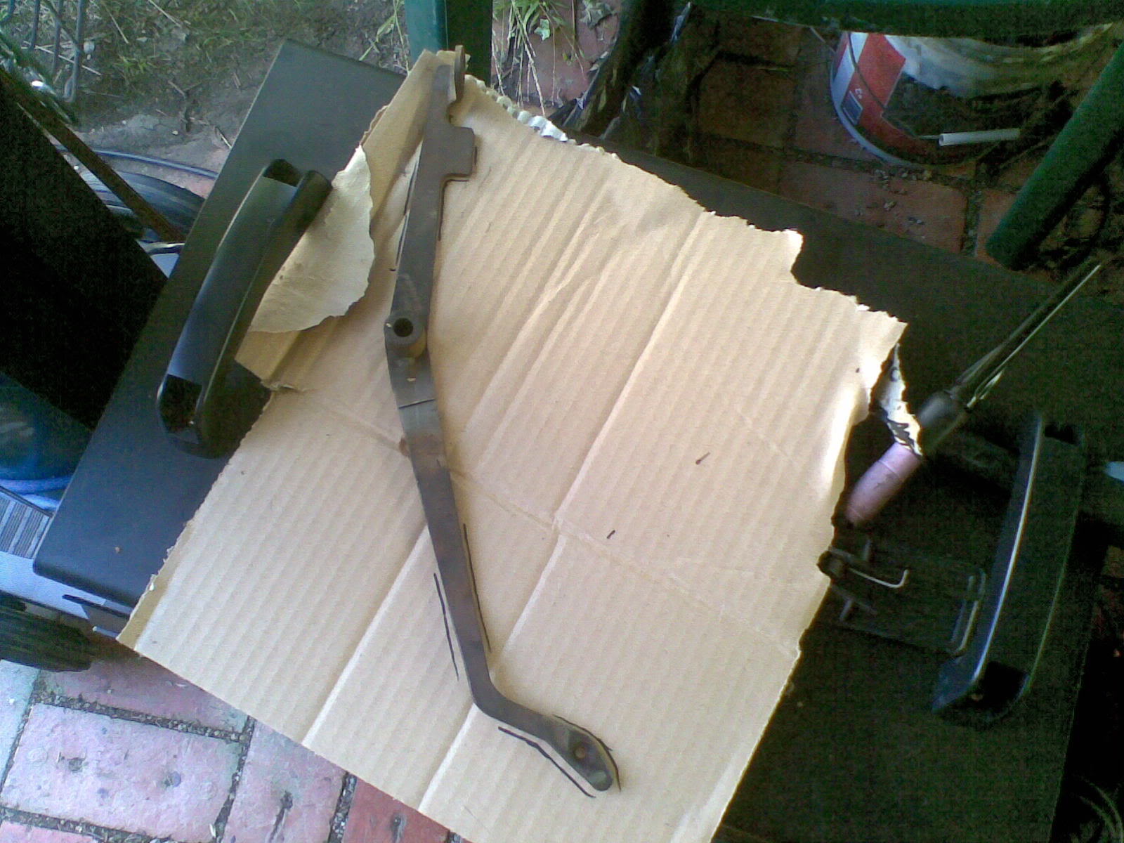

Also wanted to take the car to Winton for the Fun Day with Liam off the turbo202 forum. I'd been having a problem with the car for ages and that is that I could only really heel & toe it when I was wearing work boots, and it was still pretty awkward. Anyway I grabbed my spare accellerator pedal out from under the house, stuck it in the vice and straightened out the bends a bit (to make it closer to the brake pedal), cut a slit in it, extended it so that it was longer and sat further from the floor. Took a bit of getting used to and it's easy to go brake and accellerator at the same time now (wouldn't make a production car like that) but it works well. I could hold the brakes on hard and double clutch down through as many gears as I wanted to smoothly, heel and toeing, no dramas. I used to have to brake early, come off the brakes, quickly downshift then go back into braking. That was shit
