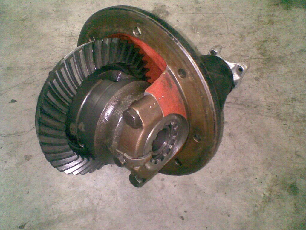

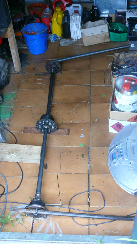

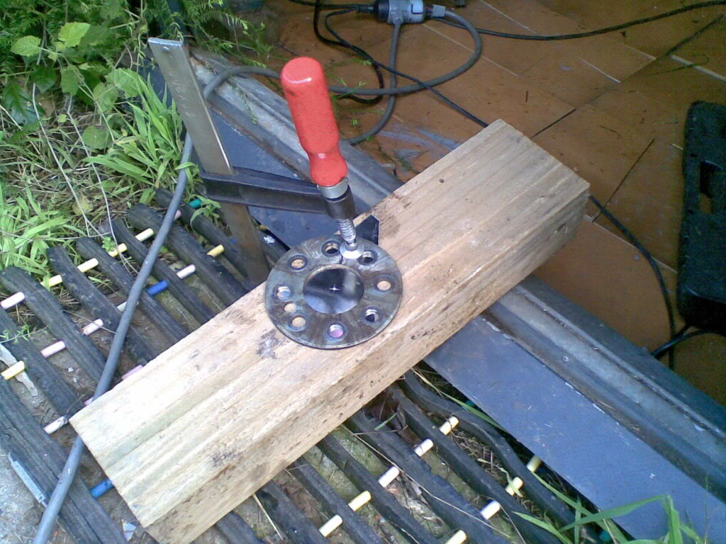

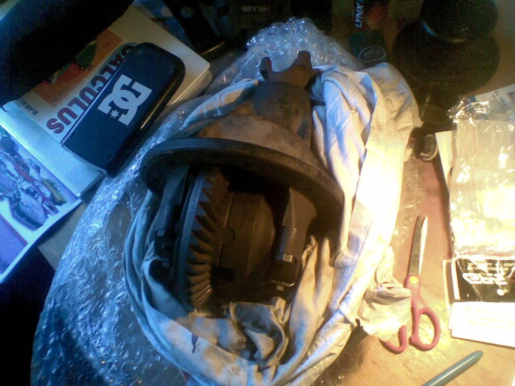

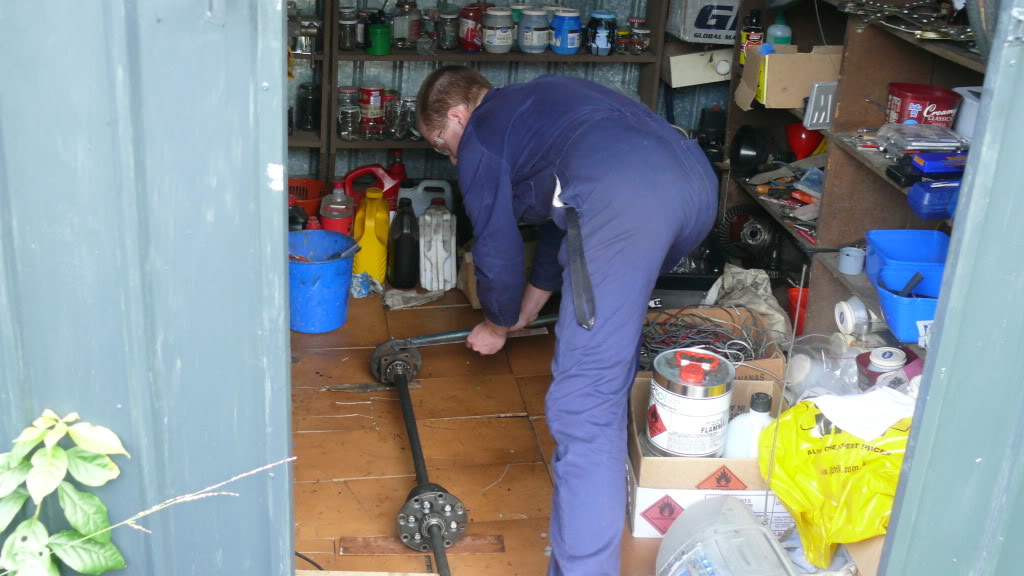

Nah Graybo mate the diff I was running was going fine, but Stew wanted to borrow a diff and it was a good excuse for me to get off my arse and put the diff I've wanted for a while in this car. Matt my car has been punishing a lot more rubber than yours has for the last year lol. Rather have a nice loud bright fun to drive Torana than a shed ornament, even if it is fitted with a sickomatic and a twin exhaust system :blink:

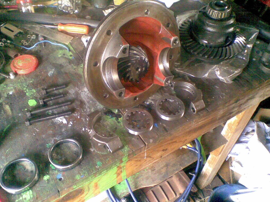

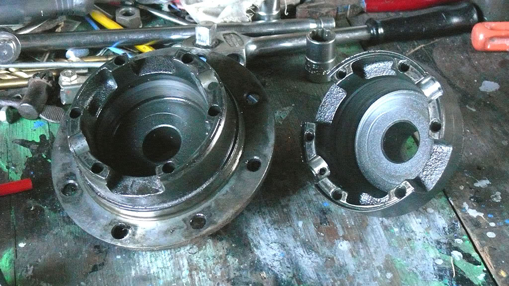

Well mid last year I bought a fine spline 2.78:1 LSD Banjo centre on eBay.
I pulled the LSD carrier out, swapped it for an open coarse carrier, set that up and sold it off to someone. I slipped some spare axles into the centre, chocked everything in place on the floor in my crappy little shed and tested the slip torque by leaning on my breaker bar jammed between the wheel studs. Excuse the unflattering photo I got my mate to take but it's worth including incase you didn't get the procedure.
Pretty agricultural looking but produced very repeatable results just with some bathroom scales and a ruler, love a good back of the envelope calc! The result was 73N.m => 54ft.lb. That was below workshop manual specs so I assumed the LSD was pretty stuffed. I got onto gearex via PM and picked his brains a bit, he pointed me in the right direction. I cracked the LSD hemispheres apart and had a geeze. Jackpot, I was so scared I'd spent heaps on a stuffed old LSD but I opened this one up and it looked pretty tidy! I posted some detailed photos back to Jay and he said it looked to be in excellent condition. I could put a shim down under the cone in its seat and the shim stayed loose so I knew it hadn't bottomed out or anything (not that the surface suggested it had, but it was all new to me)

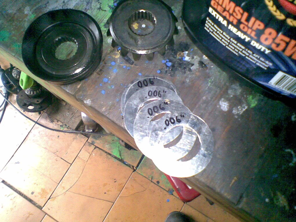

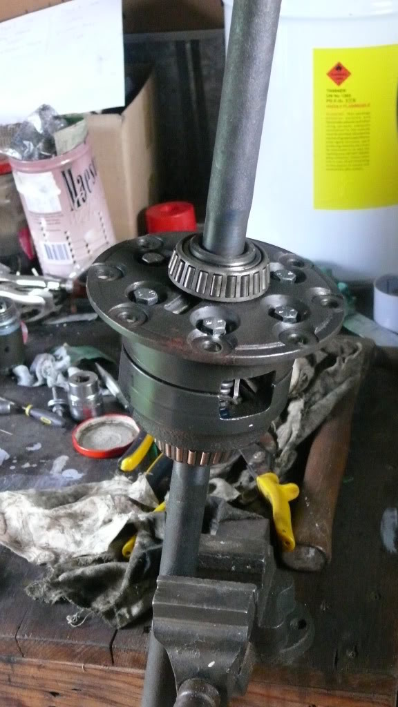

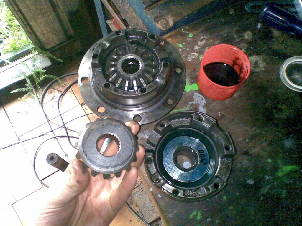

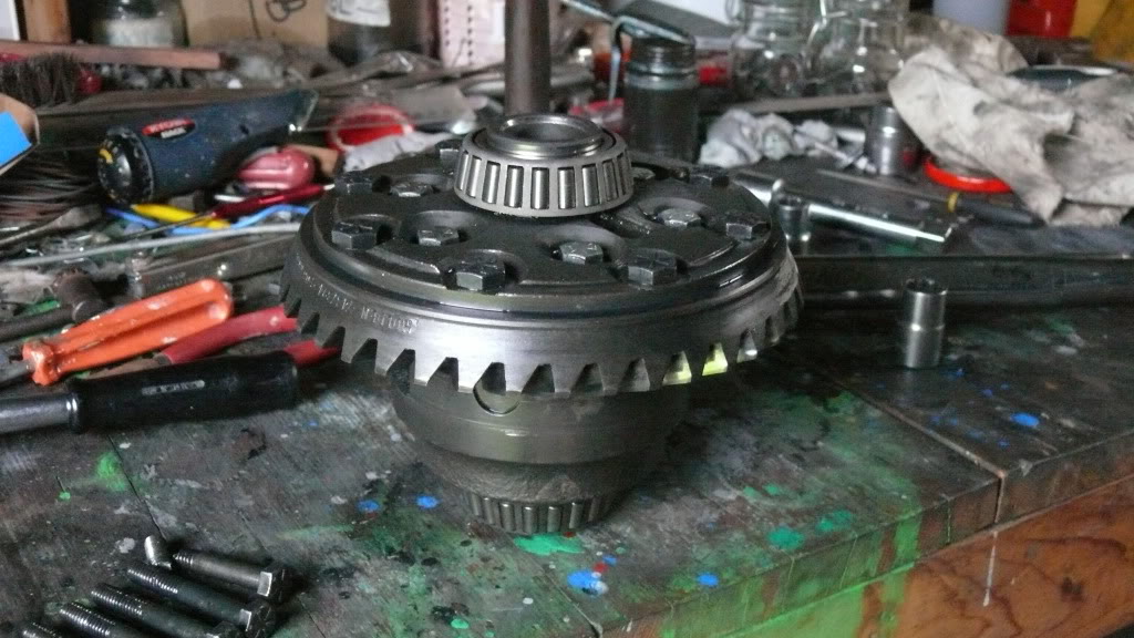

Anyway I needed to tighten it up, I asked around and couldn't buy any shims so just bought some shim stock and cut some up haha
Chucked a .006" shim between the spider gear and the cone on each side, bolted it back together and re-did the test
This time the result was 107N.m or 79ft.lb, which IIRC was about the factory spec according to the GM-H workshop manual. But I knew I could do a bit better than that haha.

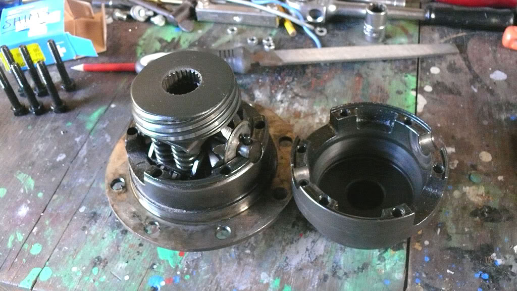

With another .006" shim added either side, I tried bolting the hemispheres back together and it was feeling a bit spongy, so I put it on the ground and started doing the test, then tightening up the bolts and repeating. The torque was flatlining and then I snapped a bolt. So I went and got some new high tensile bolts and went again with a total of .012" extra preload per side
156N.m or 115ft.lb, double what I started with. Good as!

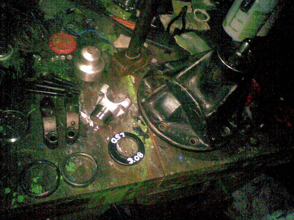

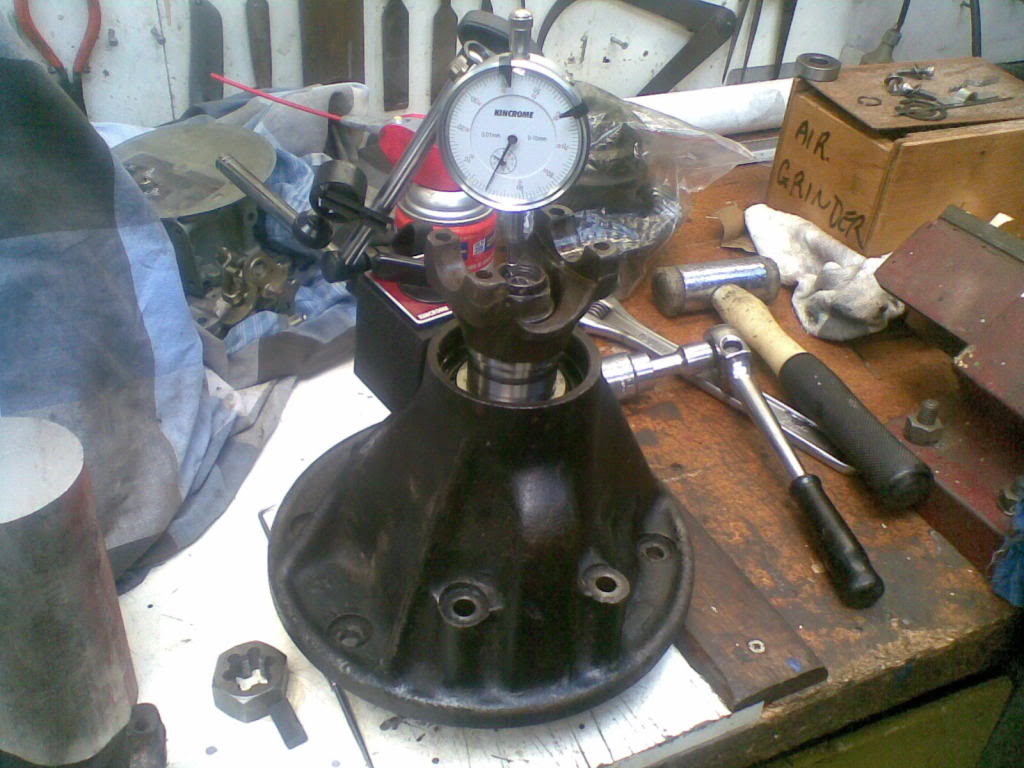

Then I had to set it up in a centre. This was a centre I was basically given by Torunya 3.08:1 ratio with a V8 yoke I just swapped for a 6cyl unit. You've already seen one Banjo diff build documented pretty comprehensively in this thread, so I'll try and show a few things that I didn't cover last time...

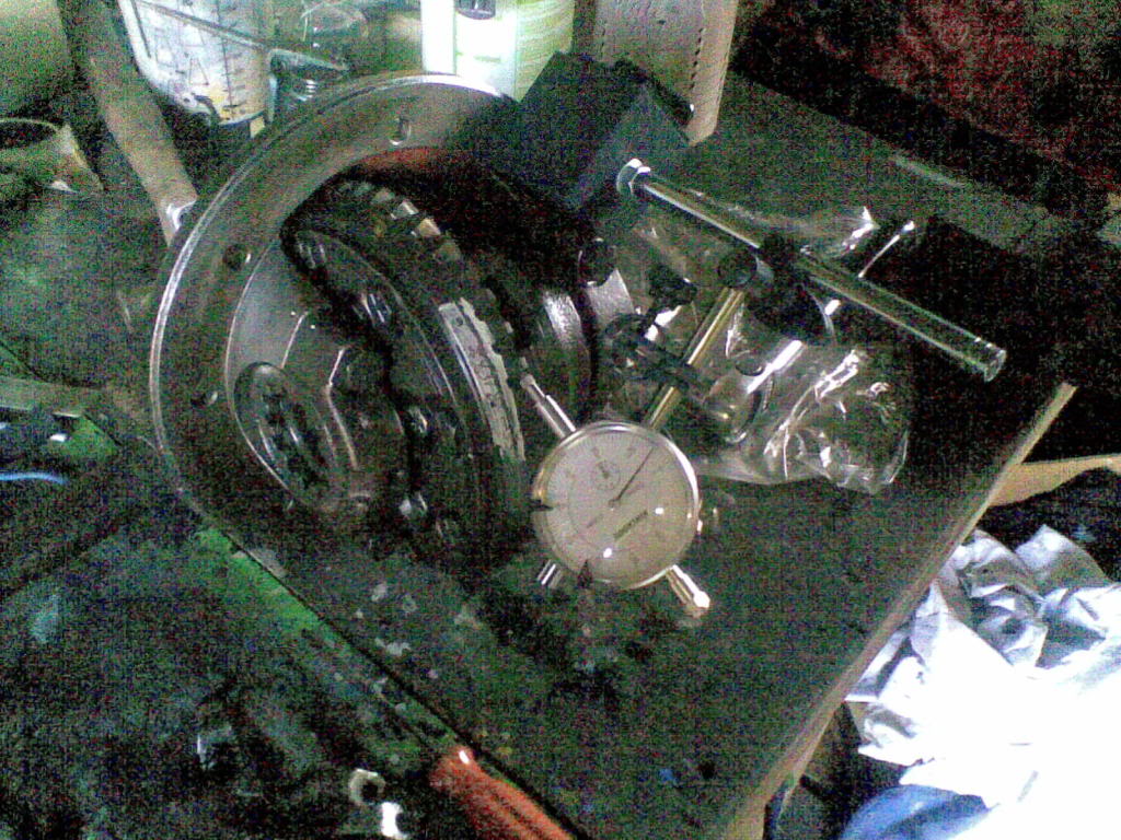

The bearings were already fine, the surface finish on the teeth was good, no heat treatment problems or abnormal wear, I didn't have to do that much... I put one of my CNC'd crush tubes in it and had about .003" end float, chucked it on the lathe, took a .005" deep cut giving me .002" preload like the last diff and that was done.
Then I just stripped it apart again, deburred everything, ran a dienut down the pinion thread, blew it all clean with compressed air and degreaser, gave it some assembly lube and chucked a new oil seal on the pinion, and some markings so I could identify the centre. Bolted my yoke holding tool on and held that in the vice so I could tighten it up as tight as I could with my metre long breaker bar

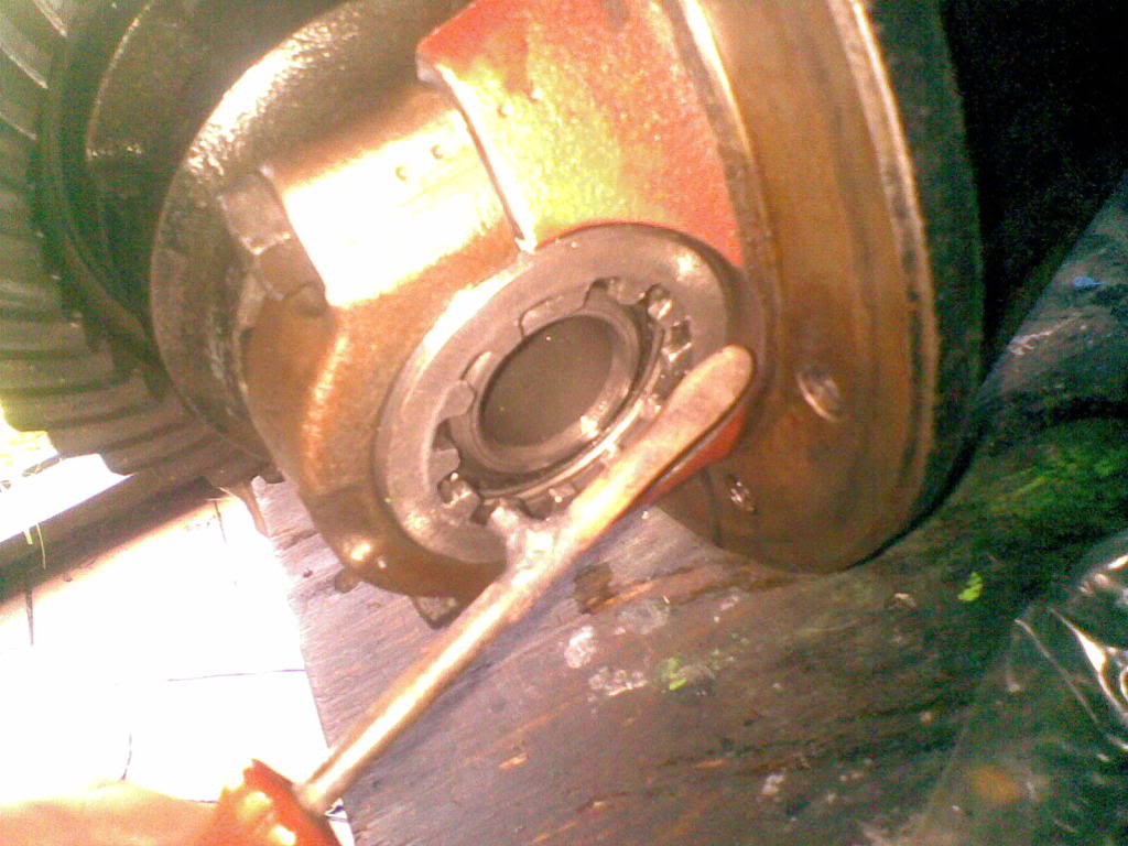

Got an old screwdriver and welded a protrusion on the side of it as a little tool to easily adjust the screw adjusters
Gave it .005" backlash (bit tighter than last diff) and a bit over 2 notches of carrier preload

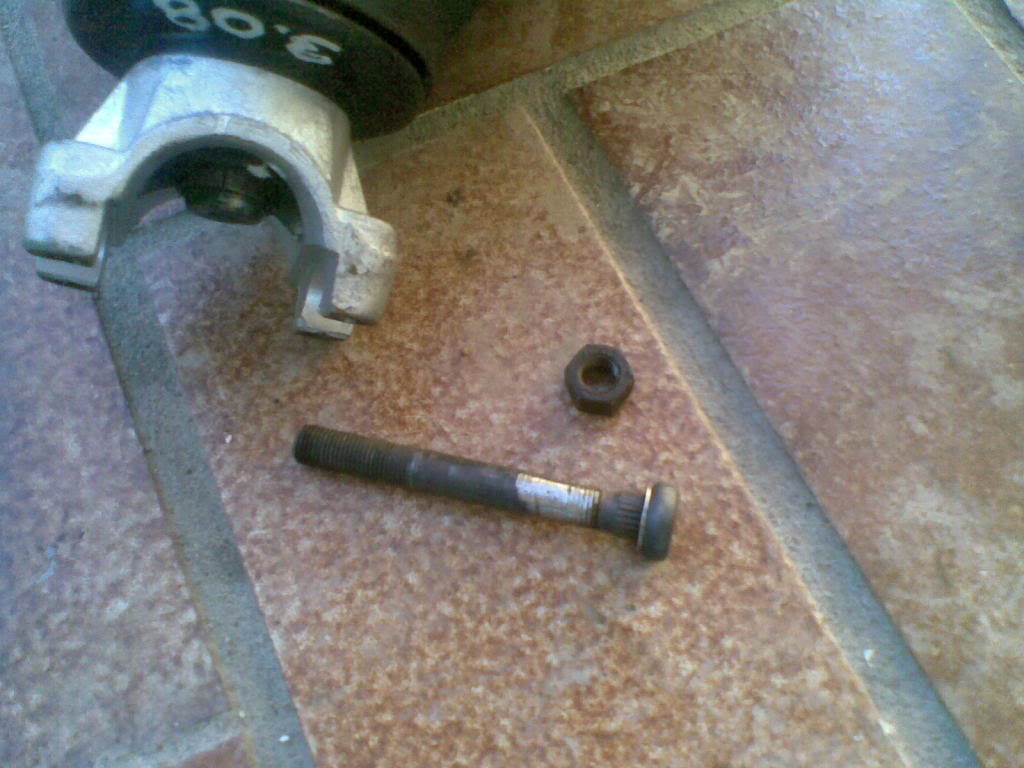

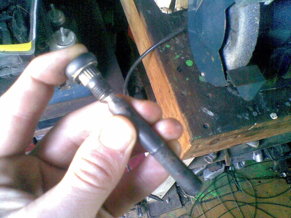

Made up a custom long stud to put in my housing to suit the tall ratio centre design.
And bolted it in the car this arvo, we've all seen a banjo centre swap so not gonna bother with photos. No burnouts yet because I had crap in the boot but, but it all seemed good to drive on.
To summarize. 3.08:1 Fine Spline Banjo (GU4, 23 spline). It's got a solid steel crush tube on the pinion set up with .002" bearing crush and huge torque on the nut, there is .005" backlash measured from the outer end of the drive side tooth on the crownwheel, the LSD has original springs and .024" extra preload in the way of shims. Axles are marked left to right so the torque reversal is minimised, and they have a straight lines linished down them so you can pull them out and inspect them to see if they're twisting.
