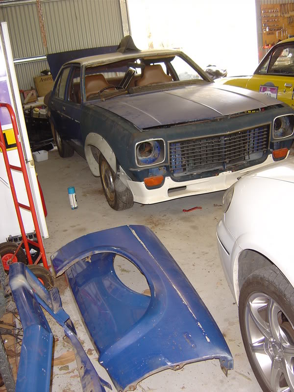

I stripped the UC front end in this lovely 34C up here...!! and the SLR one as well. Will clean and paint the UC stuff tomorrow then have a go at the rear flares on the car to get it to the panelbeater. Got a new battery so will see if it starts..he says the fuel pump is stuffed..we will see.Brake pedal goes to the floor but hand brake works though the release isnt attached under the dash..need to feel up there and press the lever to release. Work has commenced!! Datto!

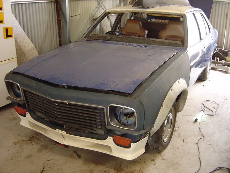

Front clip all fitted, was going to cut the rear guards but its too bloody hot. Adjusted the float bowl and it fired straight up! The handbrake is fine..I just didnt know how to use it properly.

So rory that will be a thumping 420Hp weapon in a few months cant wait till its painted :rockon:

Looks fully sic with the flares and standard rims bro!

Yeah needs some of those fatass chromies off your ride bro! :tease:

Wait until it goes for rego with them on! :spoton: The looks will be priceless!
