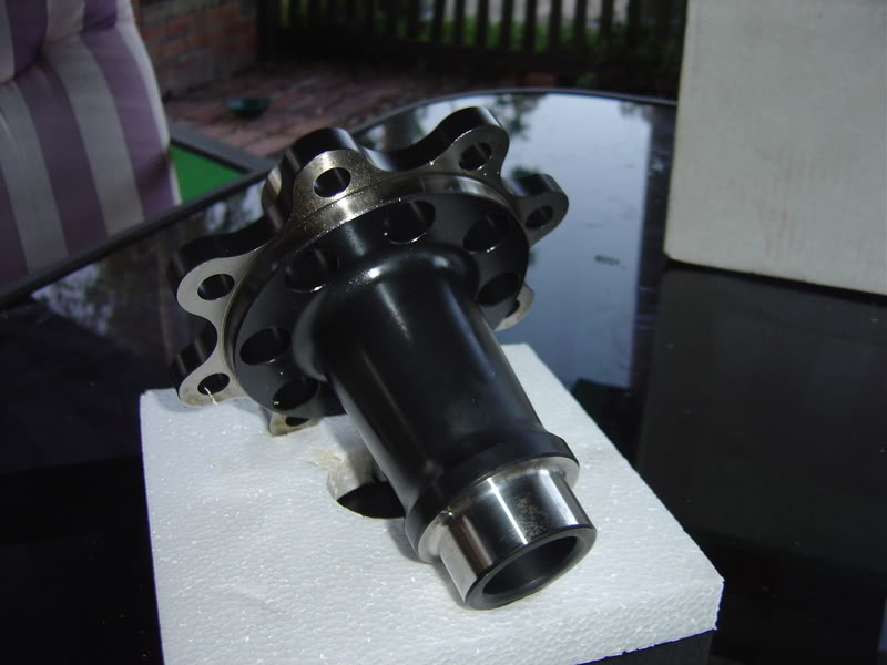

Full spool is here..The front is done..Lowered the top arms 25mm..Nolathene, HQ slotteds, Wilwoods..Car is in panel beaters ..back thurs in undercoat..then fit headling then down to NOS's place to have the rollcage welded in!

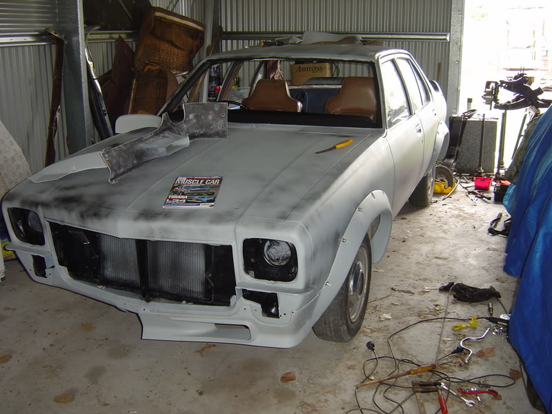

Just saw the car all sanded down and ready for 4 coats of undercoat...should have 95% finished today.

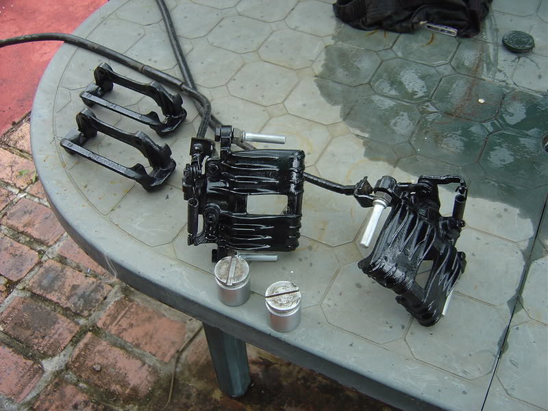

Pouring rain...bored...so I am recoing the rear Nissan calipers..

Those calipers are fun to do....... not too hard really

Once you work out the bloody pistons screw on!

All calipers with integral handbrakes in them screw in
Everyone knows that......... lol

Never done rear discs b4...now I know..tricky little set up actually! The rear cables run straight up to the central handbrake tongue on the LH ...perfect!

Done the rear Nissan brakes..just waiting for the caliper kits and new rear discs..here tomorrow.

Body is home in undercoat, will fit flares and manual pedal box tomorrow and post some pics! :spoton:

Done the left side..not as hard as I thought. I checked out the roof lining and seems pretty simple so I will have a go at that as well. Found a bit of rust under the r/r door seal but decided I can bog it up OK..All is go at the moment. :spoton:
