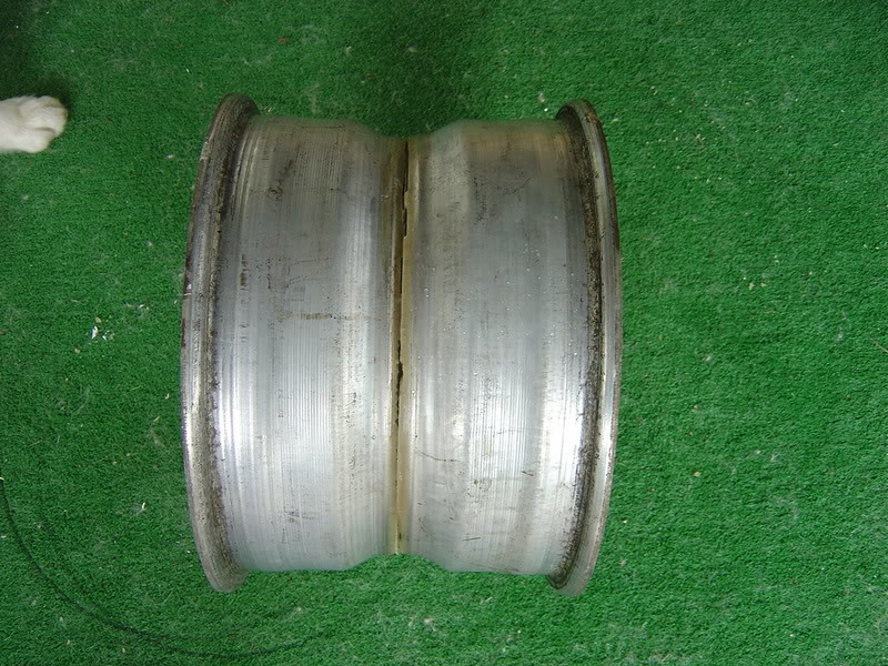

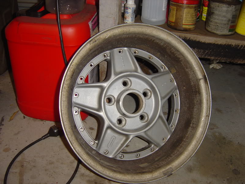

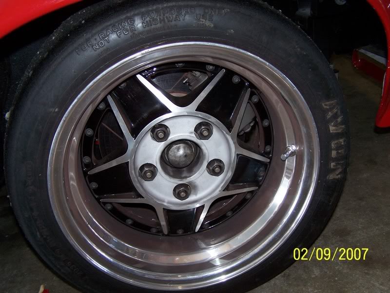

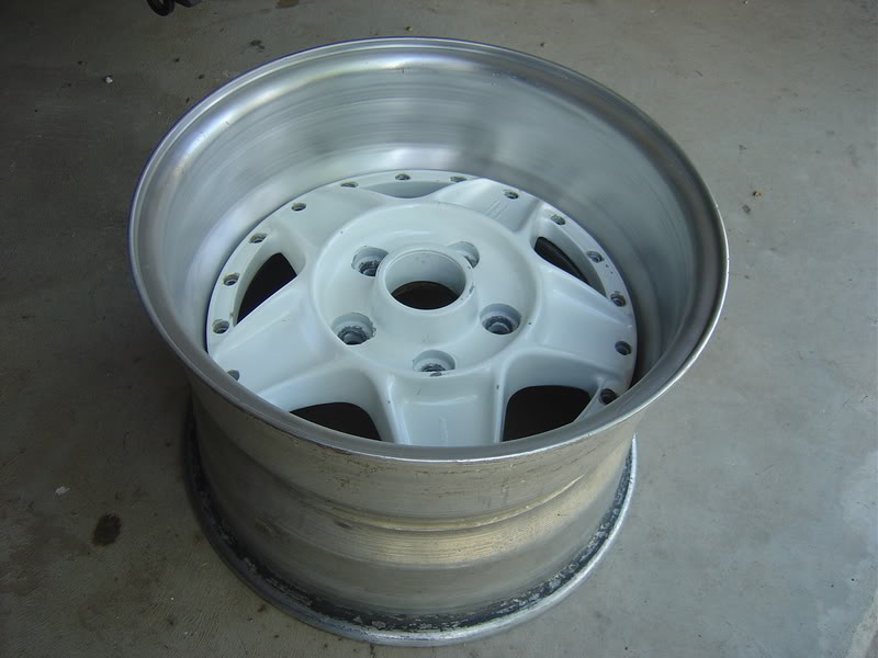

Bought 6 Commodore B45 Simmons...have worked out if I back to back the inners I get 10" rims on the back.(see pic)..use the inners as outers on the front and then use 4" inners ...gives me the 9" on the front....centres are off getting redrilled and steel sleeved in HQ pattern...sent the 2 old Challengers to get them steel sleeved as well as the other 2 are already done. Dropping the inner rims off tomorrow to be sand blasted back to alloy colour...not going to polish them up..just leave them as dull alloy colour like the original Globe rims.They should end up like Anna Cameron L34 rims in the pic.

Rory that pic of the simmon you modified^^^^ i'm concerned your feet are shrinking and growing some odd white fur :tease:
#1108 _rorym_
Posted 11 November 2007 - 09:21 PM
Its a full moon....
Are there any tyre mounting problems with an inner on the outside?
#1111 _rorym_
Posted 12 November 2007 - 02:00 PM
Appears not...both have bead lip..Ford guys have been doing it for years it appears. just need to drill a valve hole.

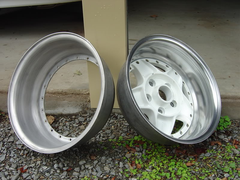

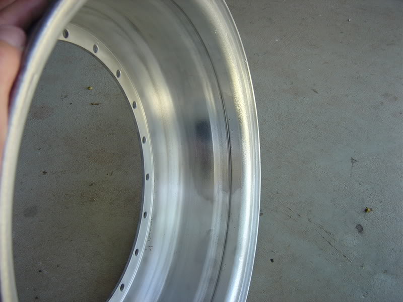

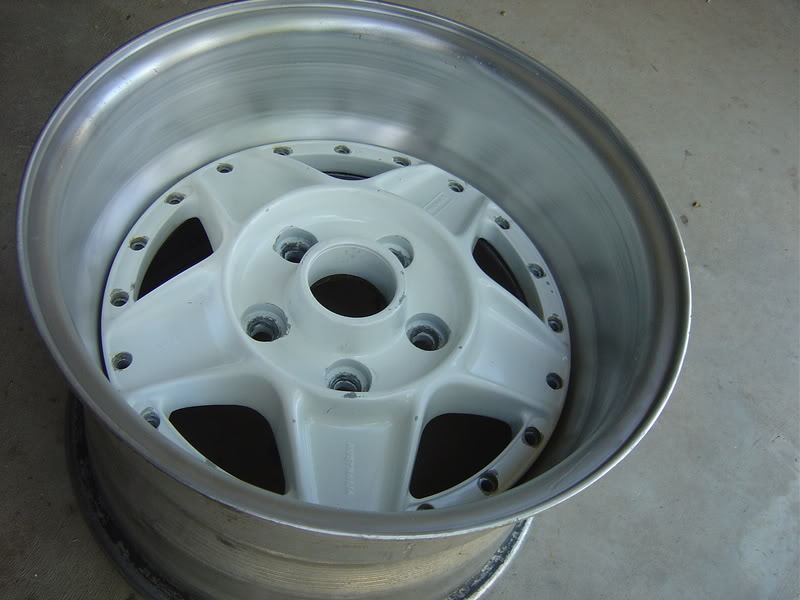

Blasted and rough buffed the rims back to alloy look...the first pic is a section with a 10 sec rub of Purple Polish..Glossed up a treat! :spoton: ..Will buff them all up with P/P.

#1114 _rorym_
Posted 13 November 2007 - 10:12 PM
I got a woody too...
#1115 TerrA LX
Posted 13 November 2007 - 11:00 PM
P/P really works a treat, is that buffed by hand or machine?
#1116 _rorym_
Posted 13 November 2007 - 11:26 PM
It took a light sand blast then buffed by machine..I will hit it with P/P to finish the external rim shine.

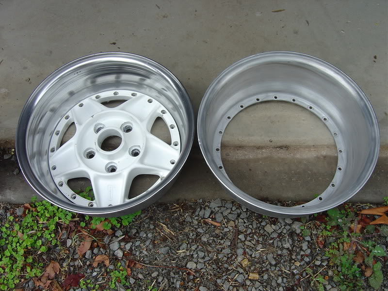

#1121 _rorym_
Posted 17 November 2007 - 03:00 PM
Bolt the rims together...then just fit the tyres as normal.
Hey Presto!!
A bit of Purple Polish and a buff and look what happens!! :clap:

Posted 17 November 2007 - 03:49 PM
Won't that be like trying to fit a tyre to the wrong side of the rim ?
#1123 _rorym_
Posted 17 November 2007 - 03:56 PM

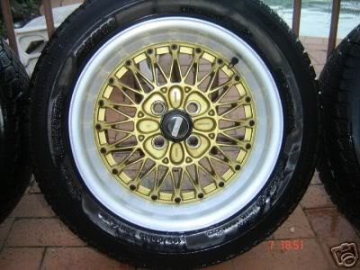

Local Ford guru who owns Bob Jane says he has been back to backing inners on Simmons for years with no dramas....Says the tyre falls on fine..Guess I will find out. These BMW rims are the same..inners as outers...and thats the genuine Simmons fitment.

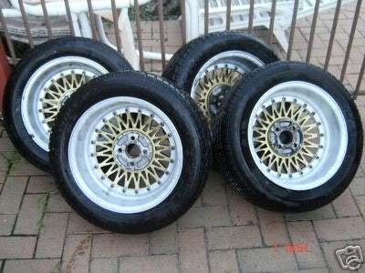

Posted 17 November 2007 - 04:24 PM
Oooooo they might fit my Bimmer...Right stud pattern...
Yours Rory???
Edited by Bomber Watson, 17 November 2007 - 04:24 PM.
#1125 _rorym_
Posted 17 November 2007 - 04:25 PM
Nah..They are on ebay Bomber..4 hours to go..I was looking for the 4" rims on them but can get 2 for $200 so now too dear for me.
