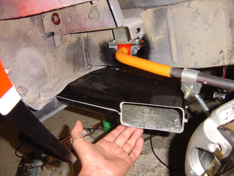

Will check the ducts in a minute..Watto...was flat for 3 days...

Clear fine.

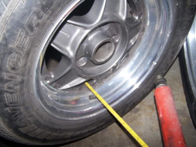

Posted 01 October 2007 - 03:23 PM

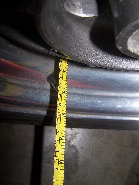

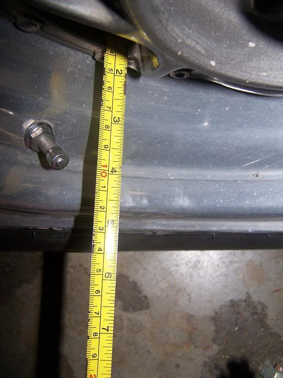

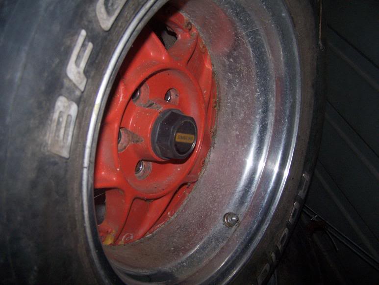

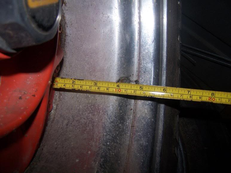

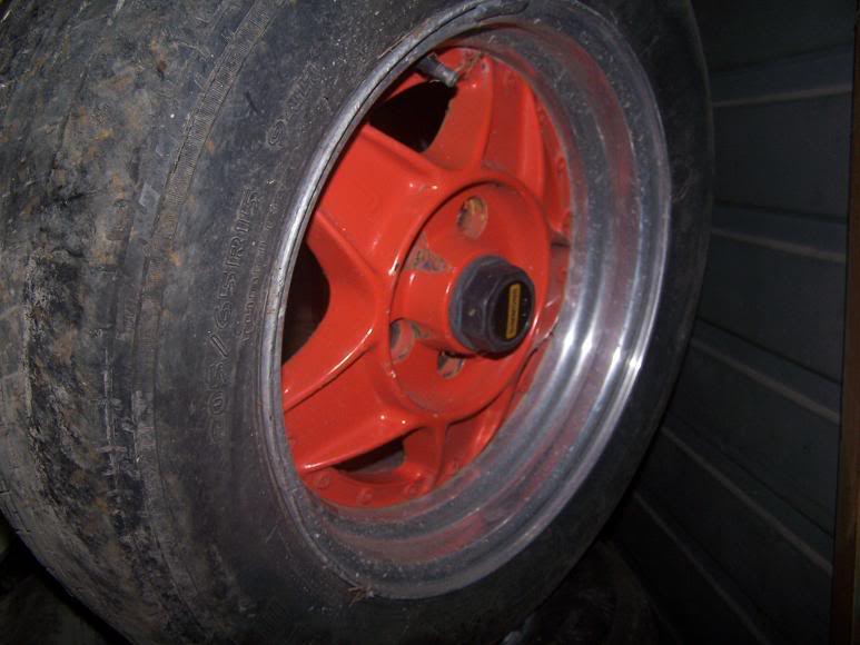

SOME PICS FOR YOU RORY. Don't know if these are any help for you or not
They look like 4" outer rims on the front NOS, which I am guessing gives a 5" inner...interesting.
#1062 _MRNOS_
_MRNOS_
Posted 01 October 2007 - 06:25 PM
I'd say they're 5inch outers on those fronts, they look the same outer as my rear 15x10's
#1063 _rorym_
Posted 01 October 2007 - 06:38 PM
So if Anna is running 15 x 10, thats 5" inners...I want to run 9" on the front so that might be OK..All I need to work out is if a 5" inner works on the front. RED!!!!??
Edited by rorym, 01 October 2007 - 06:38 PM.

my fronts are 9-1/4" or 9" but they are 14's.
i had a 'quick' go with the tape and they look to be no more than 4-1/2" on the inside.
#1065 _MRNOS_
_MRNOS_
Posted 01 October 2007 - 07:41 PM
Rory
15x10-HQ pattern
5inch outer
15x9-hq pattern
4inch outer
15x8-torana pattern
3.5inch outer
15x10-torana pattern
6inch outer

Now I think I am pretty set. B45s like Annas car on the front 15 x 9.
Challenger 15 x 10 on the rear..
Plus a set of 15 x 8 Challengers as wets.
The front B45s are commodore with a 5" inner..I need to have them redrilled to HQ ($40 a wheel) and fit 4" outers and all is done on the wheel front. I also have been told that the rims are the same inner and outer except one has a hole in it for the valve..Thats interesting..
