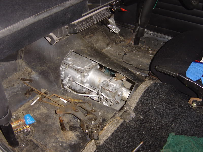

How to lose a whole day on the race car??..Put in one rubber engine mount upside...then nothing works I found...change said engine mount around..engine jumps into place..
DOH! :furious: :cry: :furious: :cry: :fool: :fool:
#1305 _rorym_
Posted 23 March 2008 - 03:13 PM
Floor cut..engine and gearbox is in...I reserve the right to collapse now. :huh:

Some nice progress there R even thou some hours wasted with fitting parts wrong way around. I'm sure it's happened to most of us but it's always funny when it happens to some one else.
Did you need to cut that much out of the tunnel to fit the top loader or was it just an easier way to work on things?
It's looking :spoton:
#1315 _rorym_
Posted 25 March 2008 - 02:48 AM
It made it easier but I actually just went on what Rockets car had done to it. If you have to weld it back, might as well make it bigger.

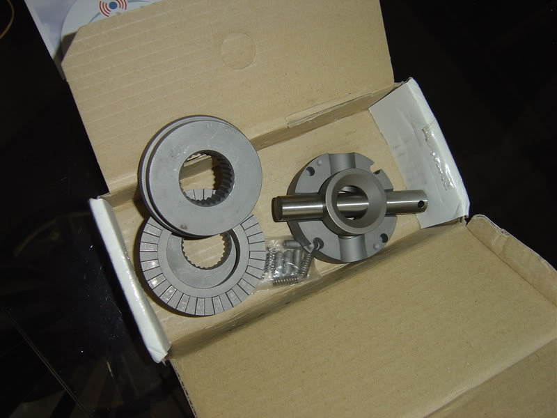

Lokka is here!
#1319 _Brewster_
_Brewster_
Posted 31 March 2008 - 08:48 PM
What sort of diff oil are you running with that Lokka Rory?
#1320 _rorym_
Posted 31 March 2008 - 08:59 PM
Penrite additive in 90/140, all the welded bits will be done this week.
