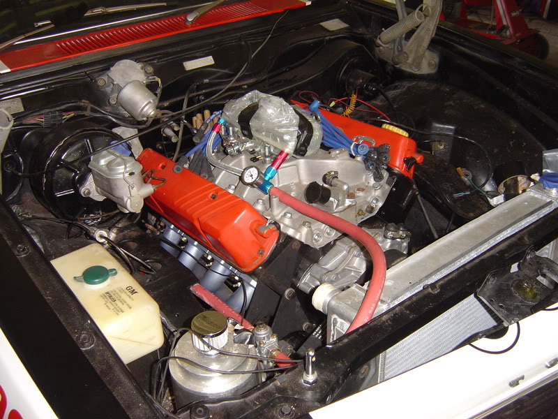

Posted 19 April 2008 - 04:29 PM
Throttle fitted and hooked up..
Radiator in..
MSD in
Floor finished
Clutch reserviour and rocker cover clearence to be done tomorrow.
Brackets for the 4 spot Nissan fronts to be cut out next week..now it will stop too!
Bit the bullet and ordered new 5" Simmons rear rims..
Stuffed if I know where to mount the coil.. :huh:
Auto elec tuesday..
