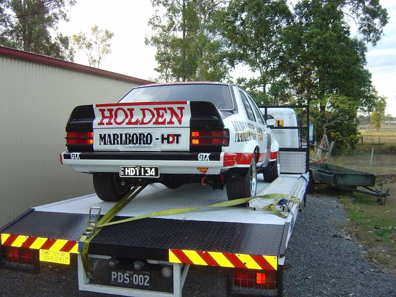

Big Mutha is on the deck...tested the Lokka diff by having one wheel jacked up and spinning it...immediately unlocked and went Click! Click!...Love that sound! :spoton:

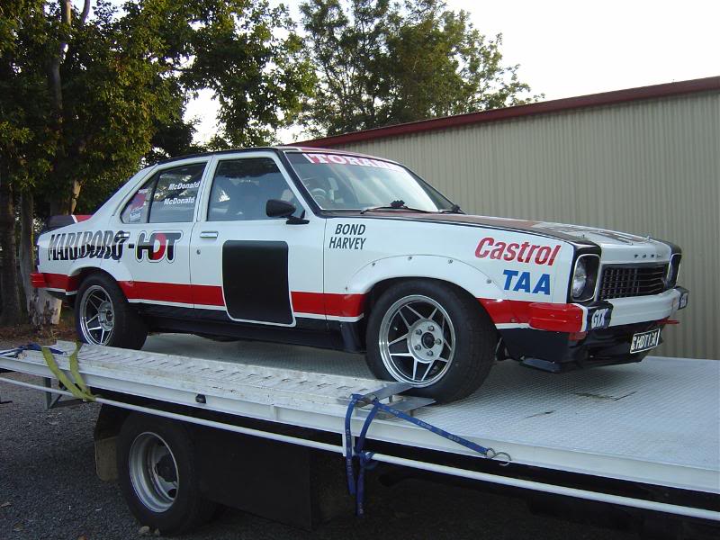

3 degrees neg looks good.

Car looks brilliant Rory! Yes, 3 degree -ve camber is adequate, what sort of caster setting are you running?

Great work rory you have out done yourself it really looks the part now when were you comimg to w.a. to build me one.G :clap:
Howard,
Started with 3 degree neg and 2.5 degree castor to see how it handles...can change it pretty quick on the Friday night of the meeting if we have to. Pretty low speed stuff the first meeting.
3mm toe out as well. Stuckey says 3-4 deg neg for the Dunlop slicks

What is that side mirror off ?
#1445 _rorym_
Posted 25 May 2008 - 09:50 AM
Yes on the truck
Mick, Thinks its of an LH or Monaro HQ...something like that..

The car looks TOPS on the back of the truck! You should paint the truck in the same livery as the car!
