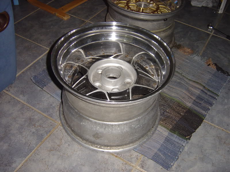

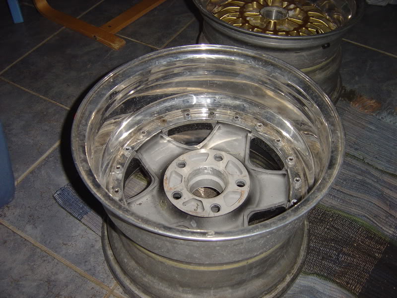

#1412 _rorym_
Posted 15 May 2008 - 11:25 PM
The new 15 x 10 rears
and just because my wife wanted to show how fanatical I am...this is the inside of the rim.
