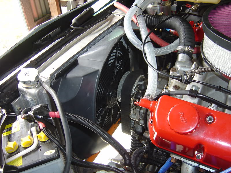

Pulled the axles..no marks..look like new..all good there...want to pull the diff hat for a look but found out the same hat off an EA Falcon is actually made in alloy and polishes up real nice....also helps with heat dissapation they say so might see if I can find one then do that through the week..Removed the 1" spacer and fitted the 3" aircleaner with K&N top....just need to refit the drivers side tappet cover gasket and thats basically it....needs a run to bed the QFM pads in again and we are ready again.
#1600 _rorym_
Posted 27 July 2008 - 12:24 PM
Tappet cover gasket done...that screw at the back is a bitch to get at. Also cut in the VK Commodore radiator shroud..fitted pretty simple and pretty happy with my effort. Need to work out how to fix it now but thats not a big drama.
