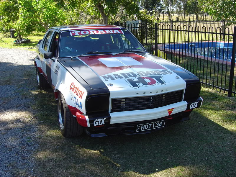

The signwriting on your car is it hand painted or stickers and where did you get it done??. Also I saw the tank you have in the boot but do you still have a standard tank underneath. While in the question asking mood can you tell me what class you run the car in and what sort of events can you compete in.
Ruts
#1634 _rorym_
Posted 13 August 2008 - 09:23 AM
Stickers...a mate has a machine and did them for me...I removed the std tank to get clearence for the panhard rod stay bar..I enter it in Group C in hillclimbs and sprints ...so far it has been put in over 5000cc touring cars for the first event..will be interesting to see where Speed on Tweed and Noosa place it.

Shit I thought I cooked it!..but the thermo was cutting off when the gauge was reading 235 and I know it cuts off at 185/190...so changed out the sender and now it sits and idles on 212 degrees hot...whew!!.....bloody new fuel pressure gauge is also all over the place..set it at 7lbs...it was 3 when I got back...so reset it at 7.....dont know whats going on...also have a rear suspension drama...see suspension thread.

That car is looking seriously tuff!
#1642 _TJ253_
Posted 17 August 2008 - 09:56 PM
Yeah that is one sexy replica what are you gonna do about the fuel pressure Gauge?
