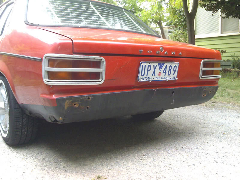

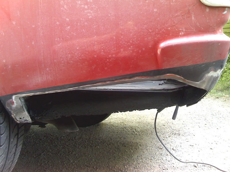

#150 Heath
Posted 28 January 2010 - 10:00 PM

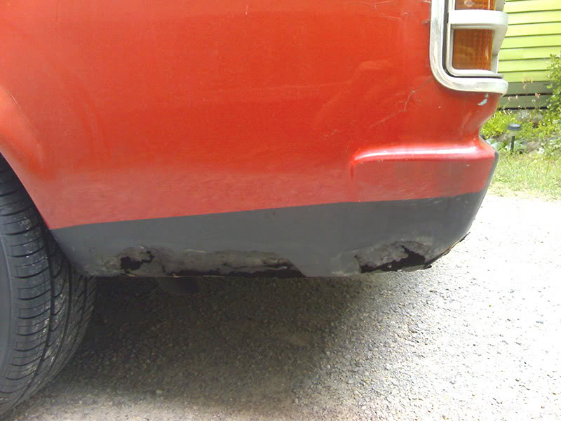

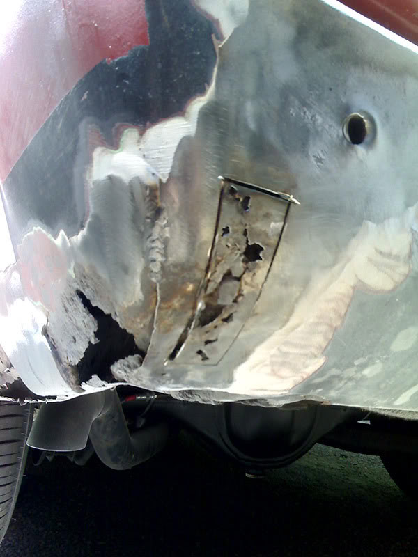

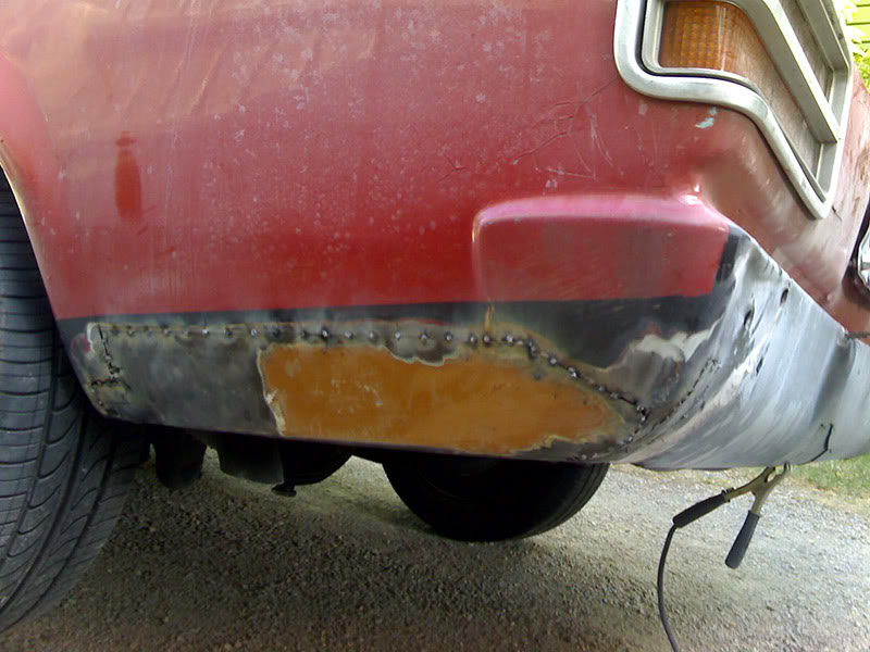

I spent about 10 hrs working on this thing today hahahha
Now which one is a Torana sleeper, and which is just a Torana that's just wearing a set of white walls? lol!

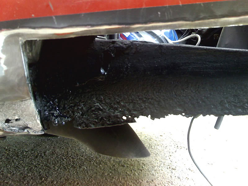

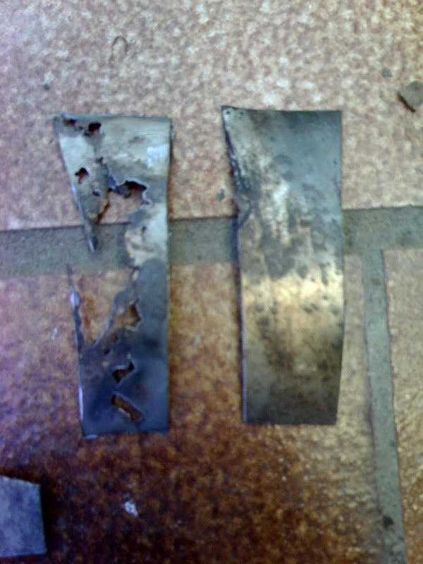

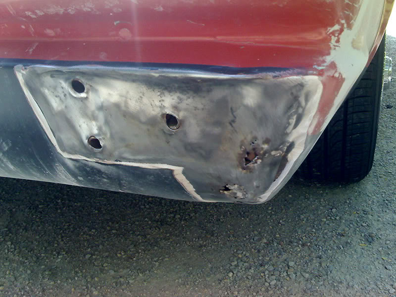

Tried to sort this out this morning but no luck - need a bigger slide hammer!
Reason it's at mine:
RHS, just cut it out, treated and painted behind, welded in new
LHS, same as the other side

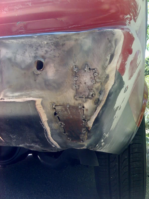

Cut out most of the bad stuff, treated it, painted it, spent AAAAGES making a replacement panel, then spent AAAAGES tacking it in really carefully and slowly. The photo doesn't do it must justice but I really took my time and I think it's a very nice repair. Will upload finished welding pictures tomorrow.
Will still need a decent skim of filler but it will be half as much as the car came with! hahaha shoulda got some more shots beforehand.
Had lots of bog behind the bumper bar irons which had cracked and created what would have become another rust problem, so I just removed all of the bog would be compressed by the iron and i'll clean it up around there, should be fine with a lick of paint, Luke is coming around in the morning to make the job quicker and easier, but I'm not sure what we are doing as far as paint is concerned yet because I don't know if the black around the bottom is actually acrylic or not, so I may have to remove it.
