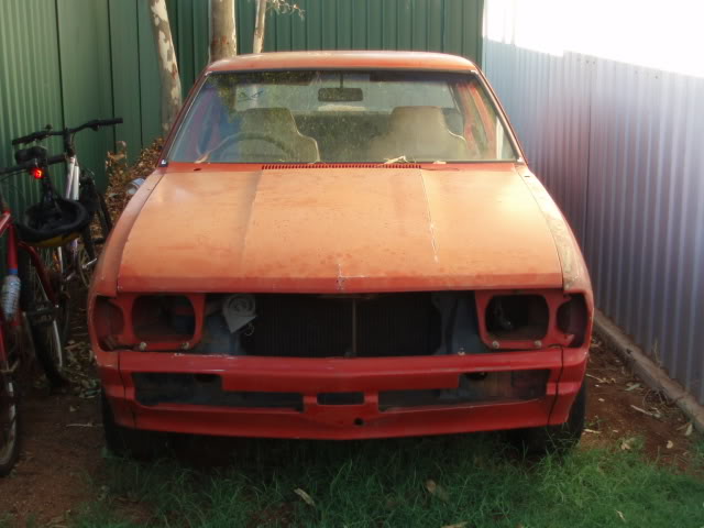

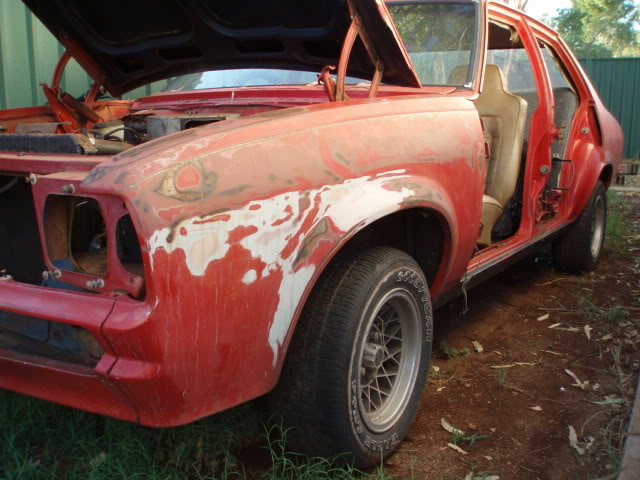

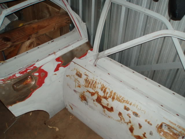

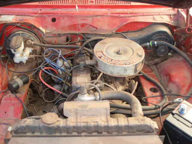

Here are some pictures of the UC that I was telling you all about. Picked it up for SFA. Ended up with yet another set of 13x7 Hotwires. The body is really good for rust and I even managed to get it running! The power of the Starfire moves my world. I might suggest that we retro fit these engines into the shovels at work.
Charlie L31SLR

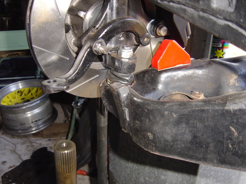

The A9X front cross members also had a dirty big square section bump stop welded to them- you might be able to see it in my 'jigsaw' photo.
Hi there, Is this what you are referring to?

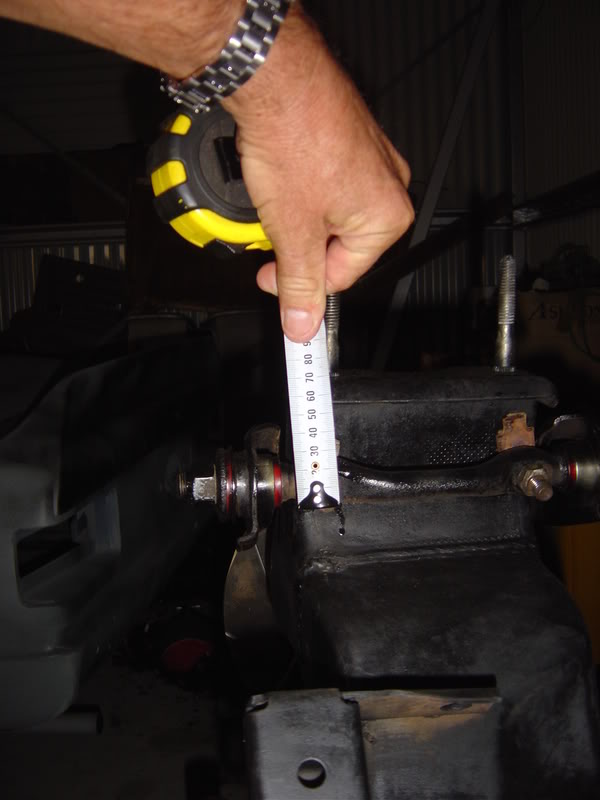

Road registered...The piece welded on the lower arms the same piece thats show in the pics on the UC front end? (I will slip out and get a pic) I drilled the holes 25mm lower than the std UC holes so it is about A9X place. My stubs are also HZ so if HZ 1 tonner are the same as A9X part no, it stands to reason the sedans will be the same number...cant see why they would be different..it is GMH after all...they used the parts bin like everyone else. By the dust covers do you mean the backing plates? If so..I binned them off the other race car too..ala XU1 original. I have the new forged Wilwood and they have what looks like a dust SEAL on the pistons to me same as XU1 Girling brakes so maybe they changed the design on this new caliper.

Pic 1 Centre of mounting bolt is now 55mm below lip on subframe as per A9X specs the boys were talking about.

Dangerous..I cant find the measurement..what the distance from the LIP..above to centre of the UCA mounting bolt on the A9X?..Sure u posted it somewhere but I cant find it,
Yep, that's it.
