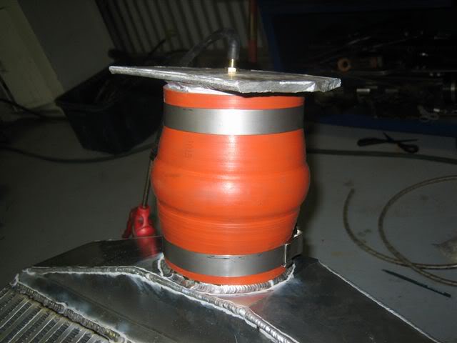

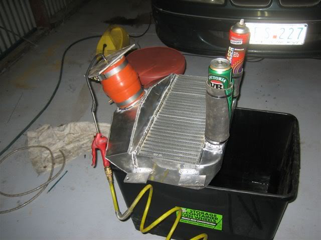

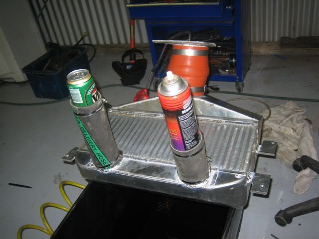

Pressure tested the intercooler a couple of days ago. Needed to be absolutely sure that there's no pinhole leaks before we weld on the water tanks. We don't want any air escaping now do we?! But more importantly I guess we don't want any (uncontrolled amounts) water getting in.
There were a 3 pinhole leaks. Fixed 'em up. All good now. As per usual, here are some pics.
#79 RIM-010
Posted 04 January 2007 - 08:37 PM
^ You'd want those cans to be held in pretty well. Enough pressure, and boom! Catchya later :P

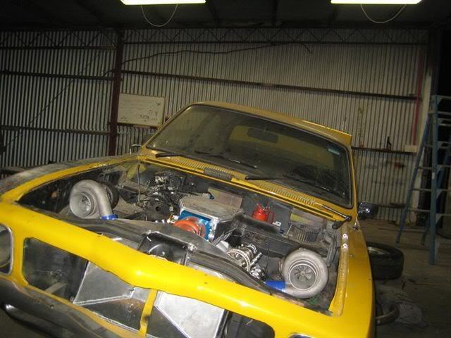

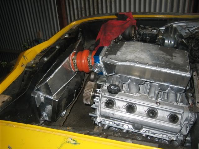

Posted 24 April 2008 - 07:28 PM
Hey sorry for such a long delay between posts on this one. I was living and working in Germany for 6 months so this project was put on hold for a bit.
This project also slowed a bit over summer because we both have other cars to work on at the same time. But some progress has happened lately...

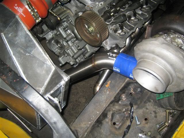

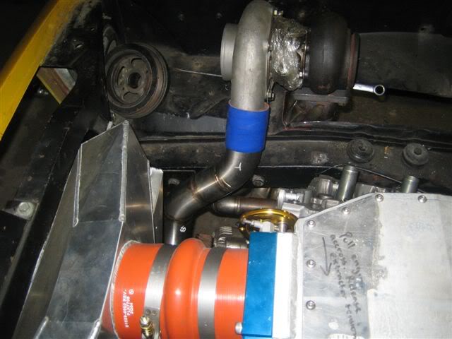

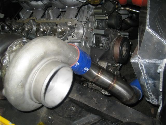

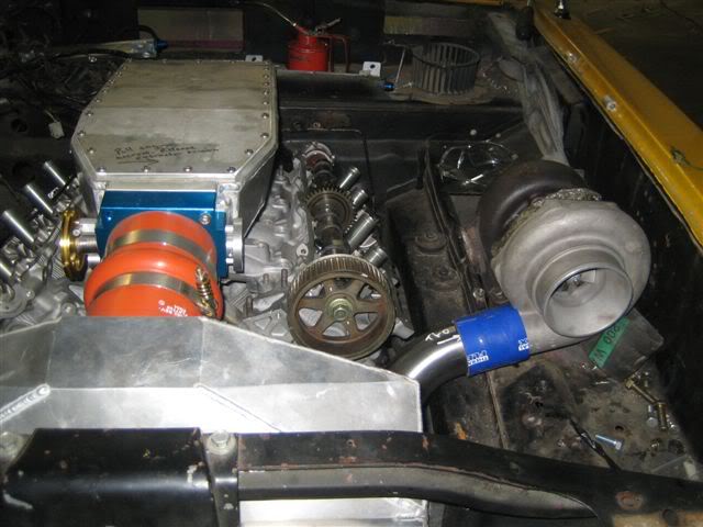

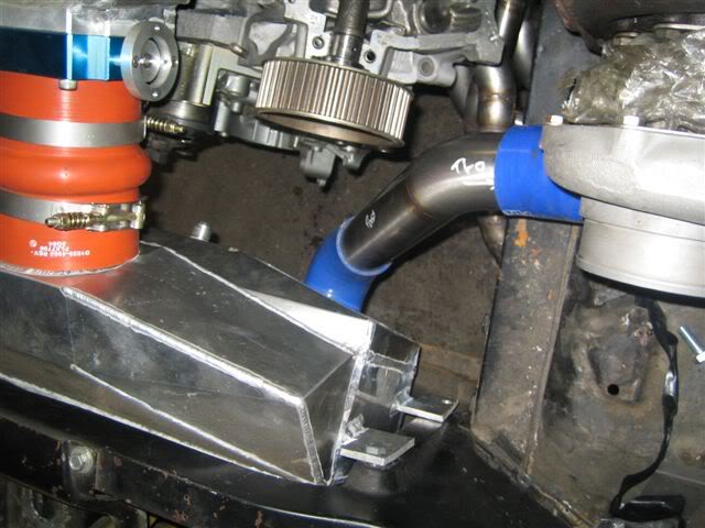

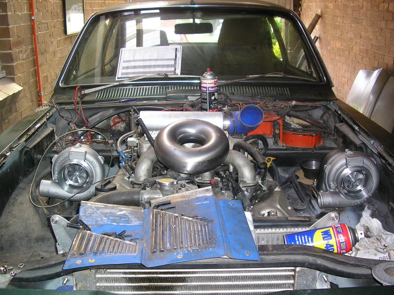

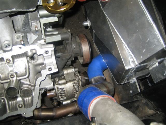

We were originally going to make the intercooler piping from aluminium tube. However, ended up making the cooler piping out of stainless because it was easier to get in the size we wanted. It ended up costing only $120 for the piping and silicon hose, so worked out well.
And here's what it looks like so far with two turbos!!

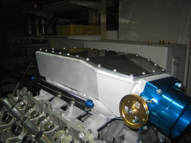

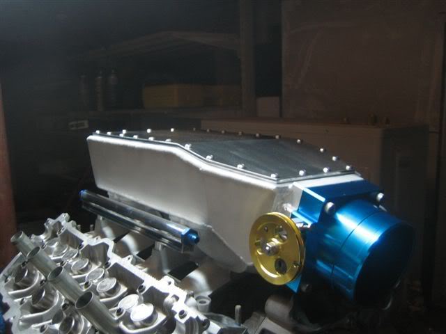

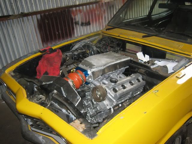

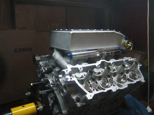

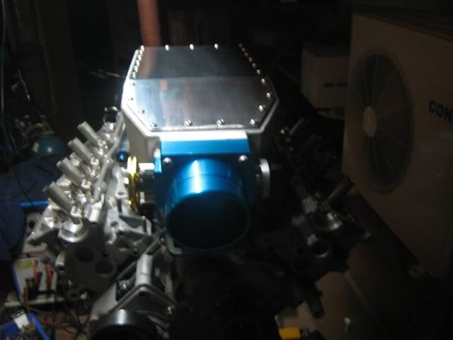

Now that most of the engine fabrication work and plumbing has been completed, we have pulled the engine out of the car. Work has begun on the engine to strip it down, clean everything and re-assemble. Until now we have been just working with a bare block, so now we can build the engine for the last time before we get this thing running. While we are at it, a bit of effort is being put in to make it all pretty.
Welded some fittings to the plenum and sump. We've also got some NOS fogger nozzles that we'll use to help with boost off the line. So we're fitting those to the manifold now (and then removing them again) so that they it will be easy to install the whole NOS system later on.
We've sand blasted the block, sump and all other bolt-ons like the water pump. This makes it all look awesome. The plenum-top and the fuel rails have been polished - Bling!
Sorry, they're only mobile phone pics....
#92 Collo
Collo
    ( . Y . )
