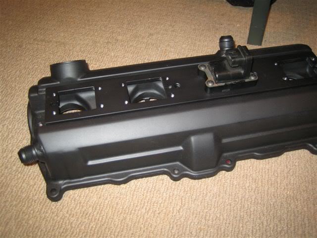

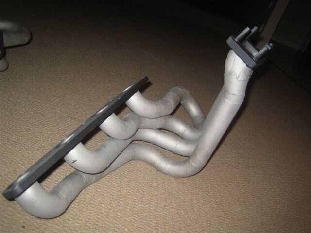

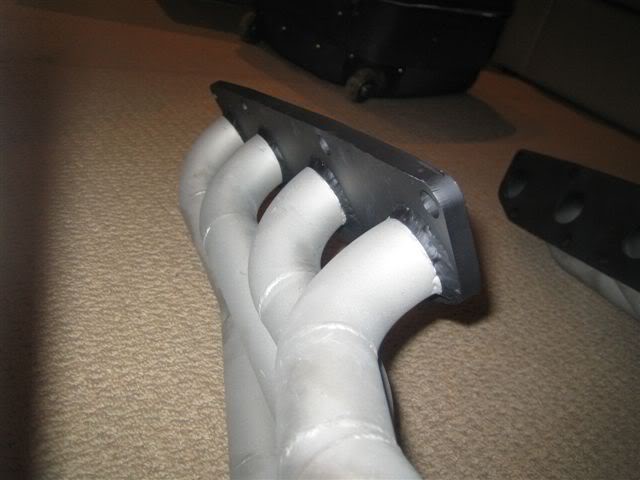

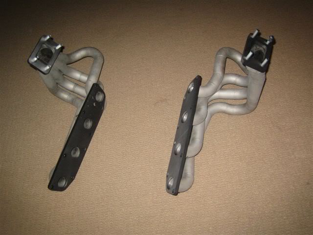

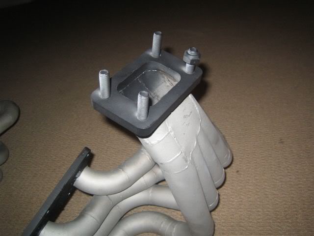

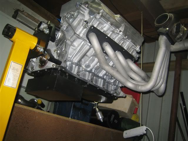

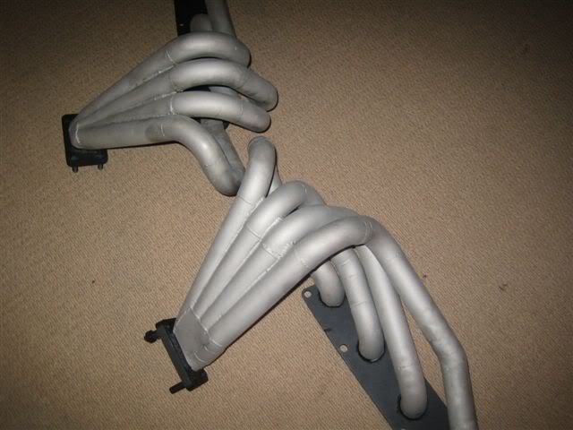

Go the exhaust manifolds sandblasted. :-) They come up good. They are all ready... unless we decide to run wastegates, then we have to weld more bits, but hopefully we can just run a blow of valve set up like Nizpro.
#105 _LHoon_
_LHoon_
Posted 06 May 2008 - 07:51 PM

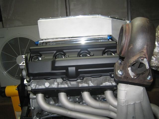

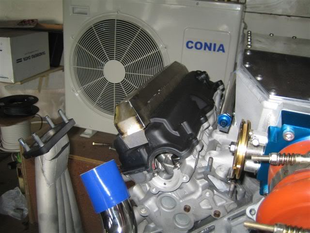

Sprayed the rocker covers matt black...
#106 _1uzbt1_
_1uzbt1_
Posted 07 May 2008 - 10:25 AM
those covers look porn.

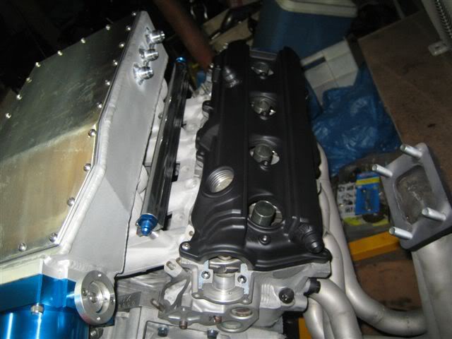

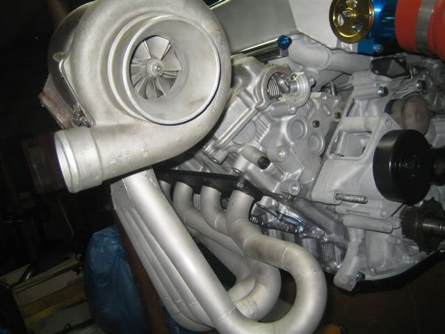

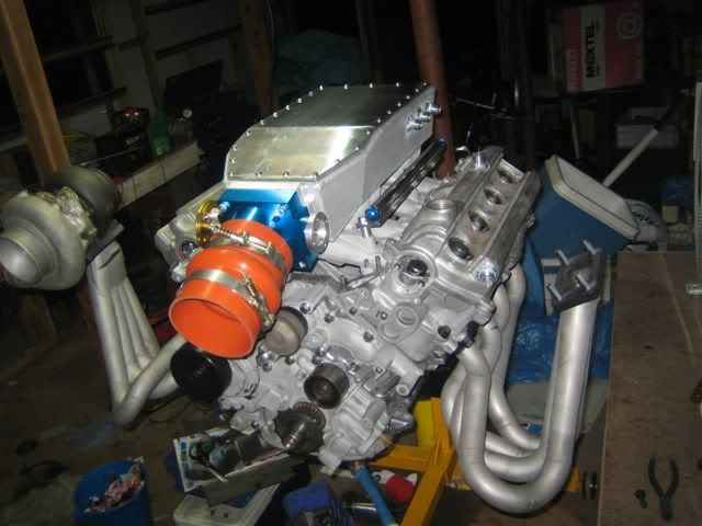

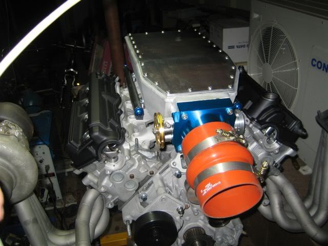

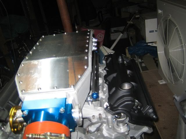

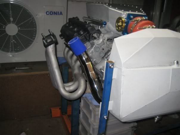

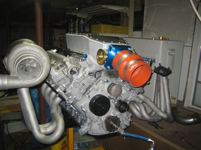

Posted 11 May 2008 - 10:39 PM

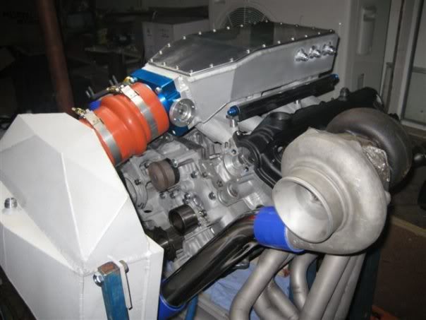

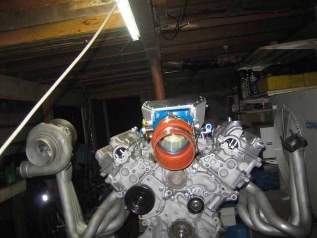

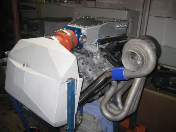

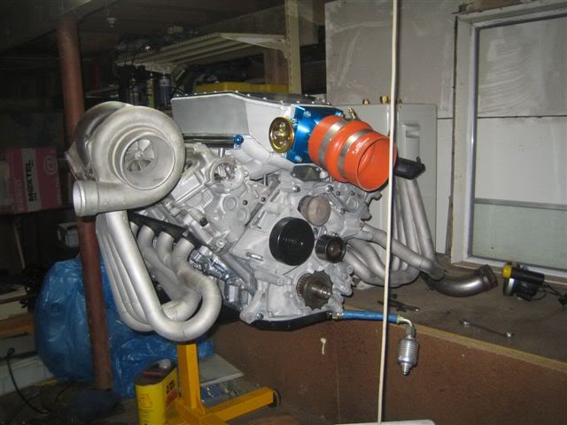

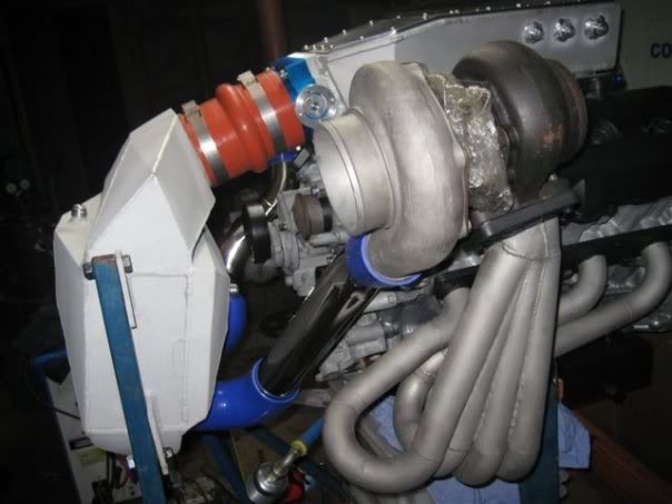

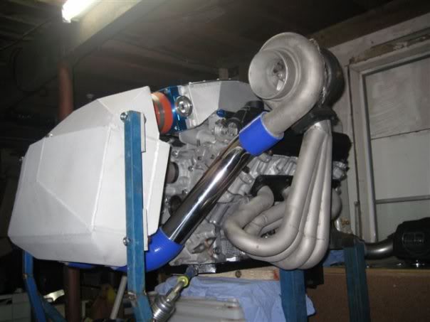

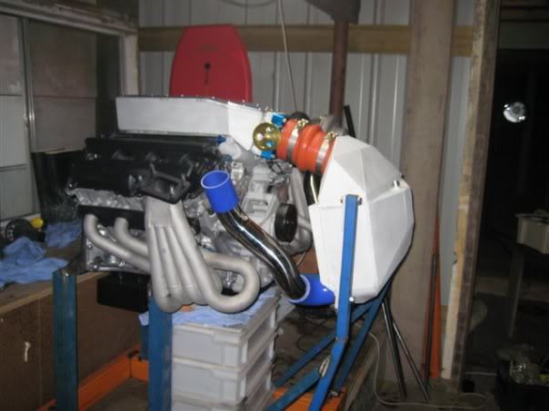

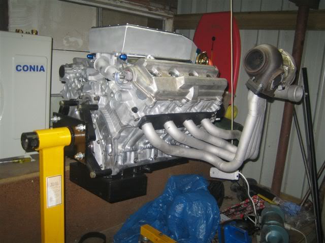

Our water-to-air intercooler has also been sandblasted - looks a bit like its cast. Its an interesting effect. Keeping it clean will be a challenge. We're assembling more of the motor on a stand now. Should be able to start it up on this stand, once its all together. Its getting there...
More pictures below... enjoy! Only one turbo shown here, as its being used on Chris' RB30 Pintara at the moment.

Have you thought about painting the intercooler matt black like the rocker covers? Wouldn't stand out as much behind the grill if it was black.
Might be a stupid question but would that affect the cooling ability having it painted in a heat absorbing colour? :blink:

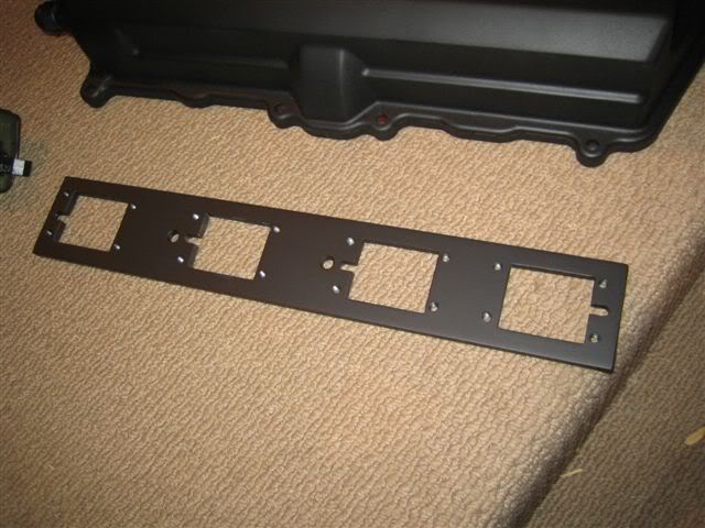

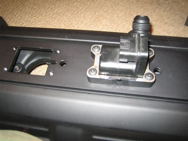

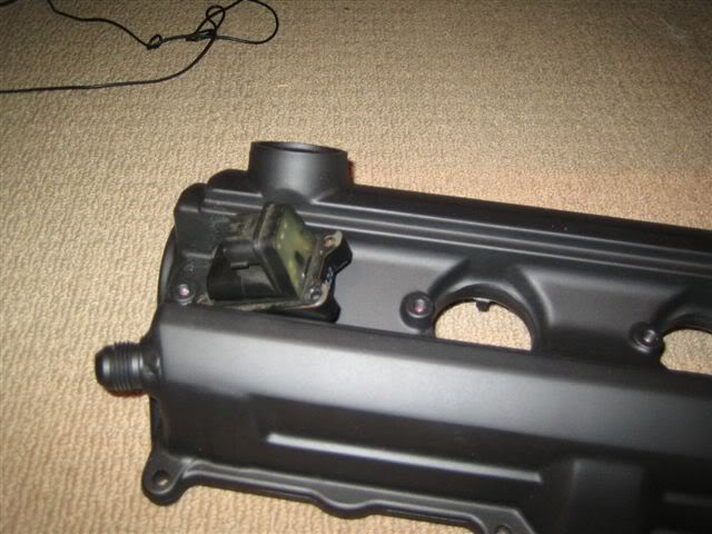

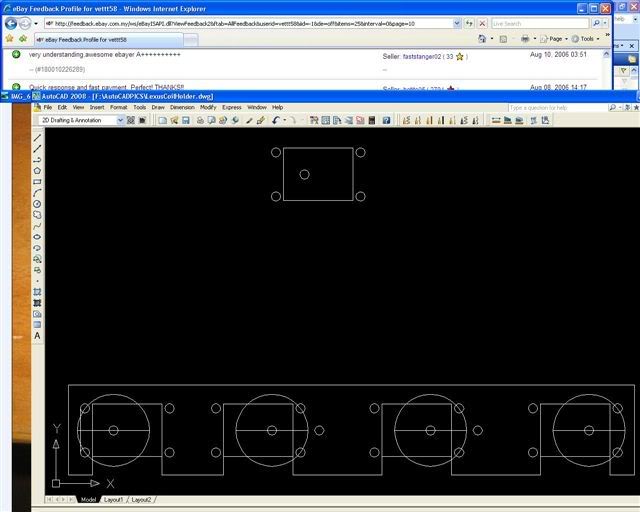

We're starting to set up coils for the motor. Decided to use 8x Nissan GT-R coils because they are compact and good. We'll sit the coils directly above the spark plugs. So far Chris designed and produced this aluminium bracket:

Might be a stupid question but are the plates the coils are attached to alloy? The small sections screwed into the larger bracket I am talking about.
Do they seperate from the coil itself and can they be polished up?
Having those polished and sitting under the coils would look good in contrast to the black of the coil and the black of the bracket I reckon.
#124 _LHoon_
_LHoon_
Posted 30 May 2008 - 04:23 PM
Might be able to polish them up. But we'll be putting a heat shield cover over them anyway, to protect them from rediculous heat coming off the turbos.
