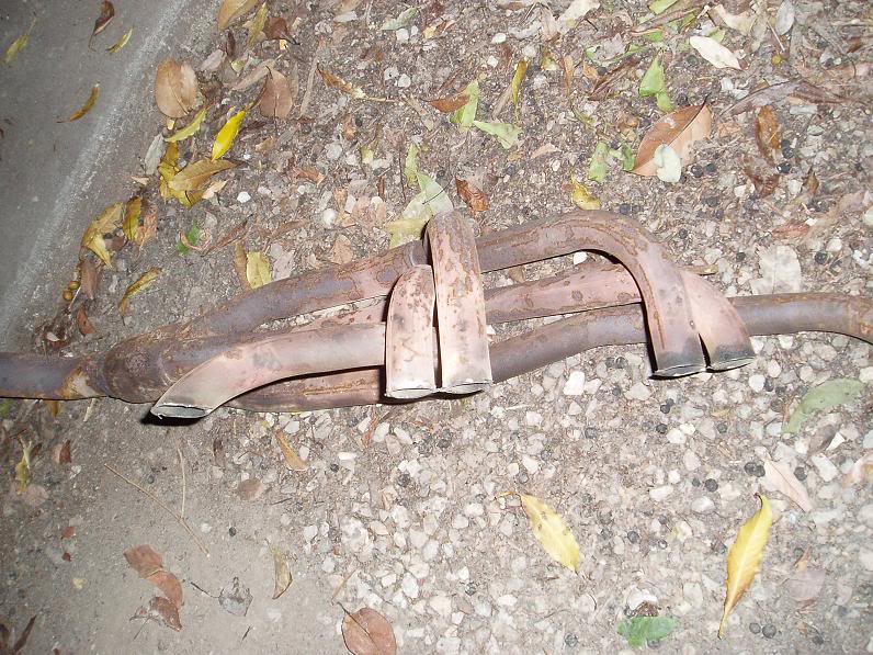

These are the extractors that have always been on the motor. They are Motorvators.
I've never really been happy with them but there aren't much better around unless I want to spend big bucks. I have better ones for when the R&D developments are complete :ph34r:

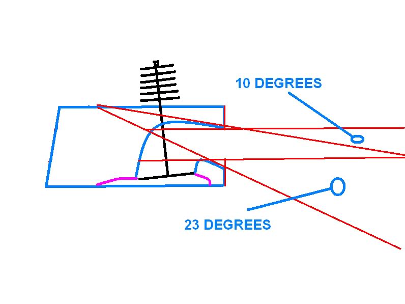

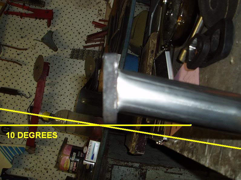

The R&D team have come up with the magic figure of 10 degrees departure angle from the exhaust port (measured with the latest of hi-tech equipment of course)

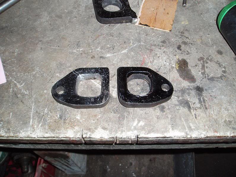

I chopped the header plates off an old set of factory E.F.I extractors, the primaries are around 1 3/8" so plenty of meat left in the header plates.
Then, I port matched them to the gasket including the 10 degrees through the header plate (the head ports are also matched to the gasket within .5mm)
More to come................ :ph34r:

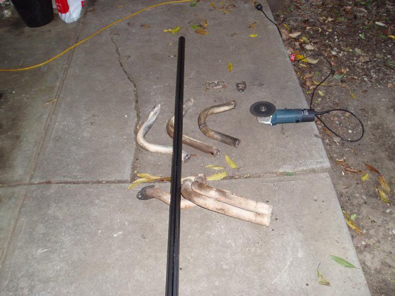

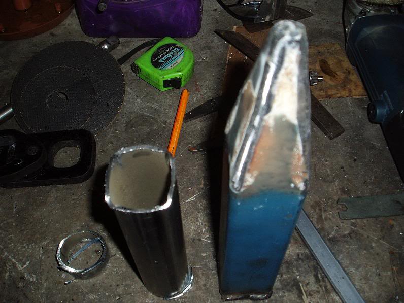

Next, I chopped up a set of Genies and bought a length of 1 1/2" pipe.
Made up a "thingo" to re-shape the pipe.
And welded them onto the header plates.
More to come............... :ph34r:
