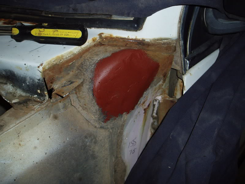

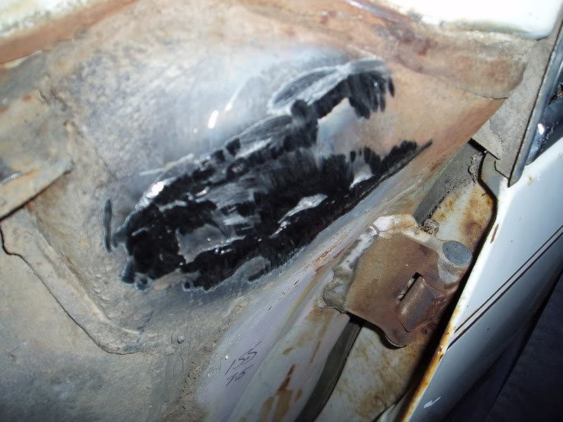

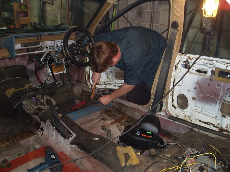

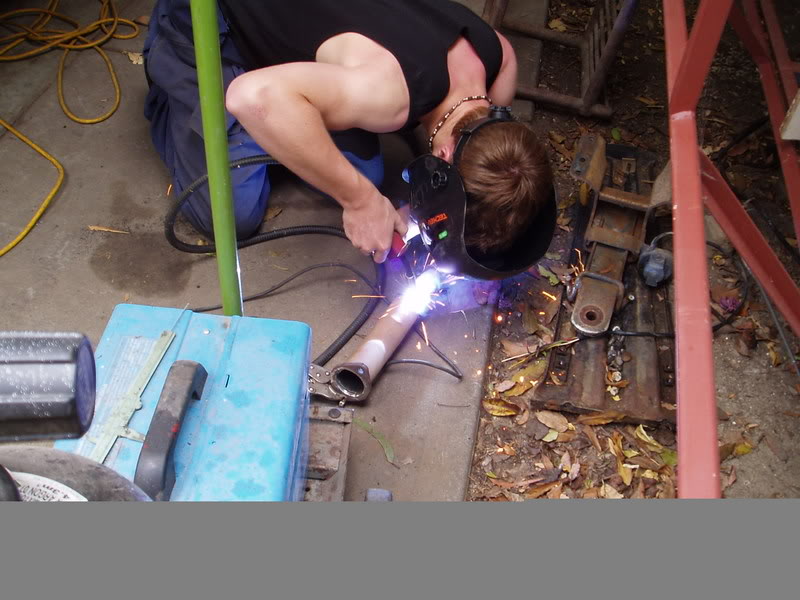

The most photographed forum member in the world came around Sunday for a play with the mig. I had left the "keyhole" surgery on the bonnet hinge for him to practice on. It is the thickness of panel steel.
I gave him a couple of tips and left him to it. This is the result after grinding. This pic. isn't the best but there were no holes to re-fill. :spoton:
A coat of red oxide and it was "brand new".
He also welded the new "pin" into the bonnet hinge, this was a 3/8" bolt into a 5/16" hinge so there was a bit of variety.
The next "test" was shitty old exhaust bits where rust and internal residue had to be tolerated. The mig was playing up a bit at this stage but the "trooper" persevered.
And yes, he got a "slap" when I realised he had his "ovarybags" rolled down.
By this time he was "exhausted". :tease:

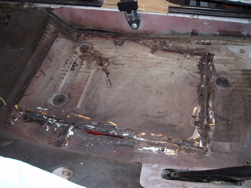

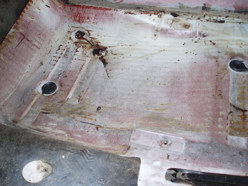

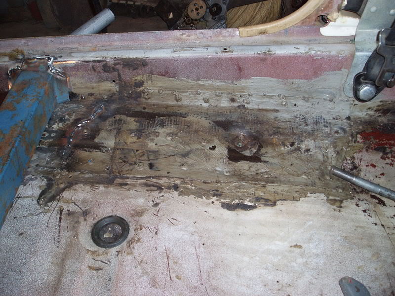

The rear left floor pan foot well has to be modified to accomodate the exhaust. The foot well is quite deep and not "user friendly" for exhuast mods. and is why you see handbrake cables dangling under Commodores.
Just another hurdle.

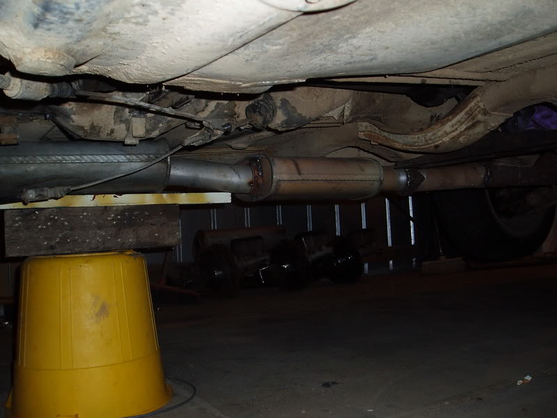

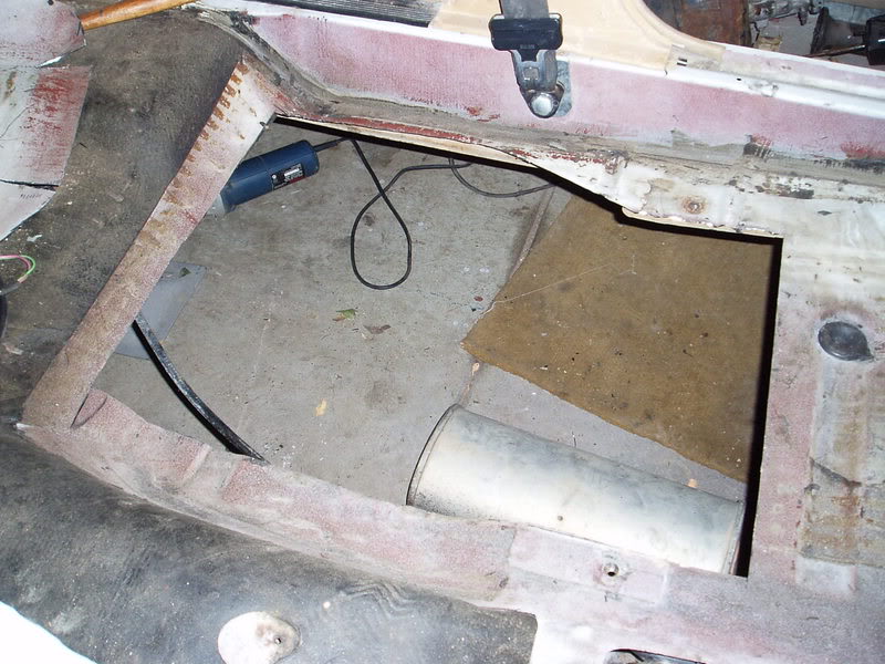

The rear floor pans on Commodores are deep and not user friendly for exhaust mods. You can see by the "deadener" mat on the left how much was gained in these pics.
This section was cut out, flattened out and the contour of the sides and end "adjusted."
It was then welded back in. It gave another 1 1/2" under the floorpan for the exhaust.
2 x 2 1/4" standard EA Falcon resonators and 2 3/8" tail pipe for the "wank" effect. (It thinks its a VL turbo).
The resonators are straight through but the rear one is offset. Hopefully it will be enough to keep the marshalls at Winton happy.

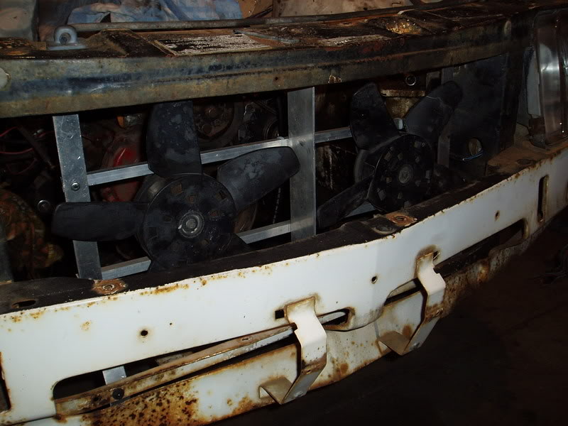

2 x Commodore A/C condenser fans. Hopefully this will keep it cool enough while lining up. They will be manually operated by an illuminated switch on the dash. The thermostat has been chopped out as the motor is an unknown. I ran it briefly before I pulled it out of a VK wreck. The heater core on the VK had been by-passed which could mean an underlying o/heating problem with the engine. We will soon find out! :spoton: 28th Jan.

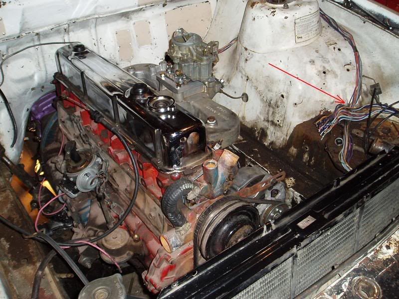

Tonight (15th) the exhaust was removed and the welds finished and painted. Heath, I was wrong. The exhaust is 1' (300mm) forward of the rear wheel and closer to your left ear. Tomorrow (16th) I will try and find some "bungs" for the air pump ports and an "idiot light" temp sender in the head so I can assemble the manifolds. Have these senders been changed? I remember the old EH/HKish sender being quite large and bulky but Bursons and Autopro are trying to sell me something that looks like a guage sender. Help here?
The lower valance (see pic of fans) also had a "tidy up".

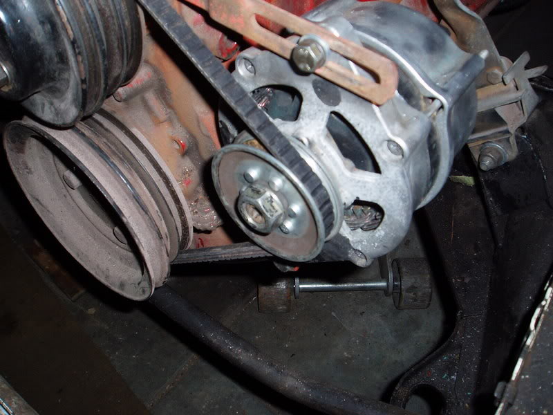

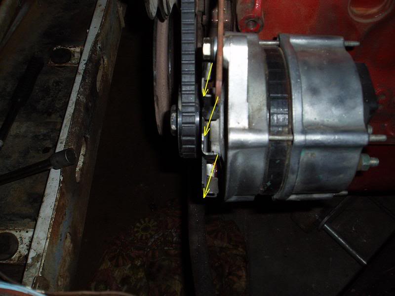

After the tidy up I was going to fit the radiator but opted for an alternator mod while there was room.
This pic shows the Alt. as fitted. You can see there isn't a great deal of clearance between the Alt. fan and the fan belt. StedzLC? had trouble last July at Winton where the fan "stretched" with centrifugal force and almost took out the fan belt. The yellow arrows indicate the direction of the "stretch" A recent thread in "Circuit racing" "race preperation" mentions altering pulley size but doesn't mention this (though if you fit a larger pulley this maybe won't happen?) I found an old Sigma Bosch Alt. in the shed (again, I don't throw anything out) which had a bigger pulley and the fan was deleted.
From memory Stedz car was seeing 7000 rpm on the day. I'm not saying the VC will go near that but who knows? The engine is an unknown but has had work on the head at least. With all the mods I've done I'm expecting 350HP as a reality? :<_<:

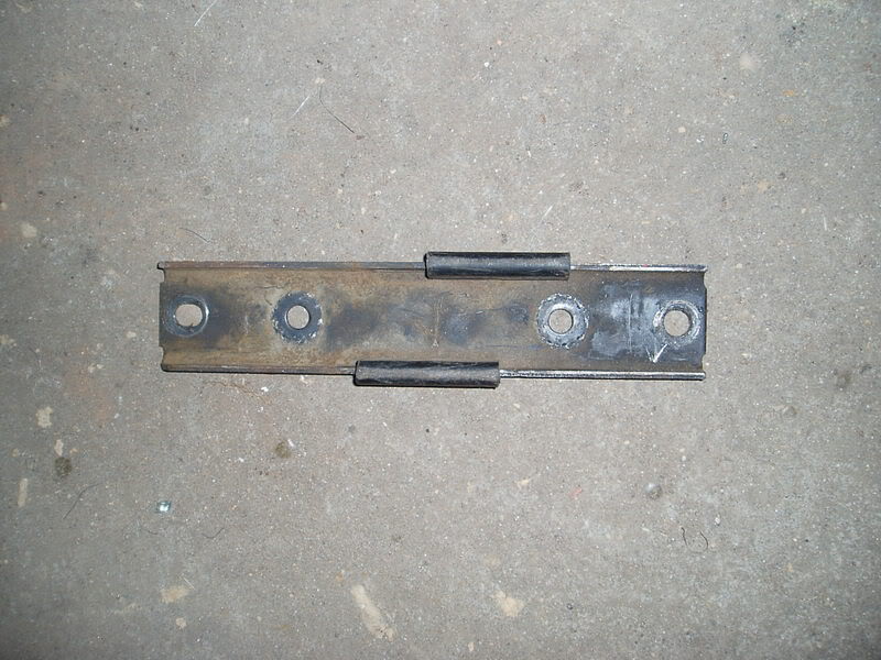

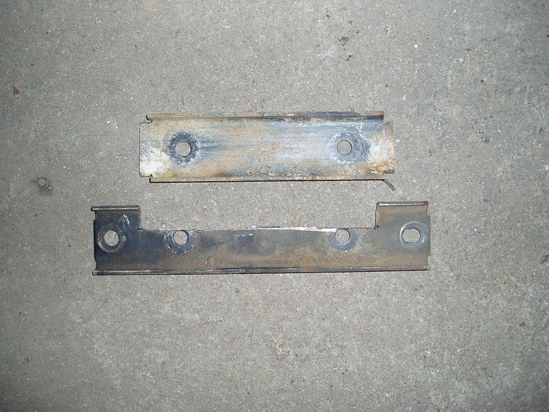

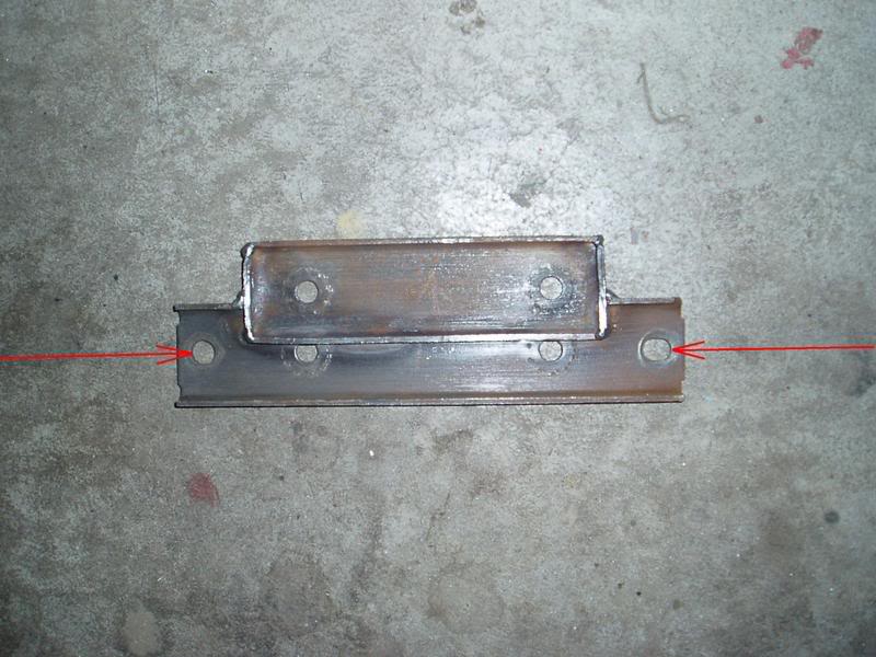

Tonight I did the bit that brought it all to a halt before the last fun day (Dec 17th). The centre bearing mount. The tail shaft I have is Commodore V8 but it was the wrong length. Wagon? VL? Who knows? Who cares?
Anyway I cut it and welded it back together just to find the centre bearing mounts didn't line up.
This is the standard mount.
I had another that was cut and hatched into the original.
This was the result. I drilled the end holes (red arrows) out to 10mm and drilled and tapped the mounting holes in the floor. I could then use 10mm bolts and "big fat washers" (technical term) to mount it.

The pile of spaghetti to the right is the wiring loom. :blink: After the Rangie rewire this should be a piece of cake? Shouldn't it? I don't really need a wiring diagram, do I? :blink:

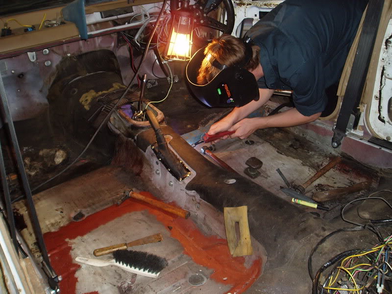

"Grasshopper" re-appeared today and the seat mount work began.

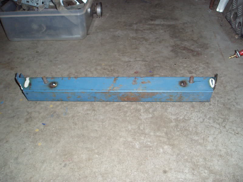

The seats are MR2 Toyota, $100 off e-bay. They have good side support and lumber adjustment on the drivers seat, you sit in them, not on them :spoton:
Two of these were made up and are the front "adapters". You can see 2 plug welds to the insides of the bolts and "burns" in the paint to the outsides of the bolts. These welds are holding the "spreader" plates in that the mount bolts are welded to. The early Commodores have an inbuilt problem with the floors cracking. Its caused primarily by the car being designed in Europe for Europe. Not for Aussie roads with "lard arse" drivers. The second mistake was the mounting holes to the floor being symetrical which causes a "rocking" effect under accel. and braking. The Toyota seats have a "random" bolt pattern meaning more work to fit. Here is a pic of a couple of "shonky" previous repairs. BUYERS BEWARE!
Here is "Grasshopper" tapping up the flanges to close the tolerances prior to welding.
And here he is welding them in place, what a trooper! It's more fun now that the mig is user friendly.
