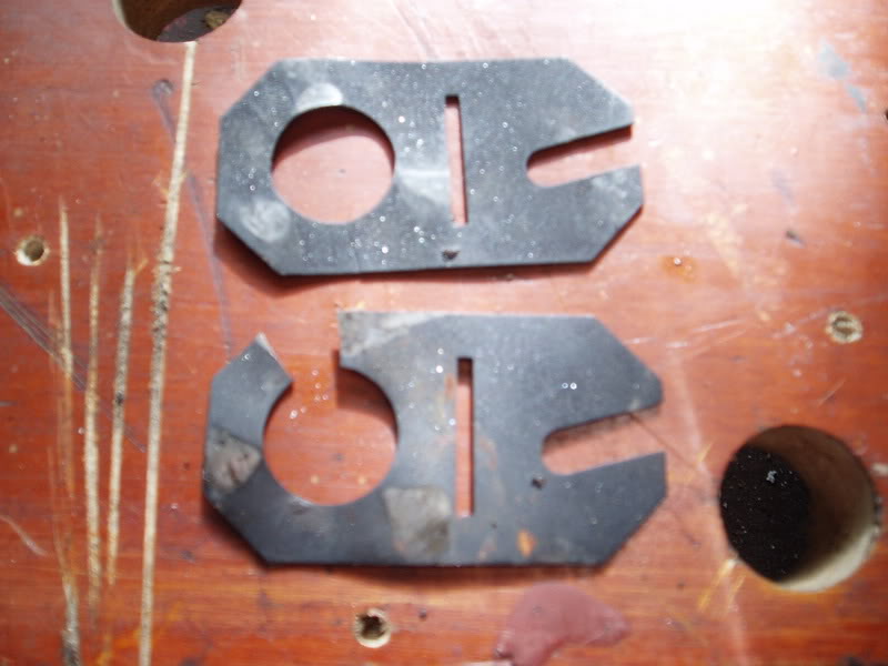

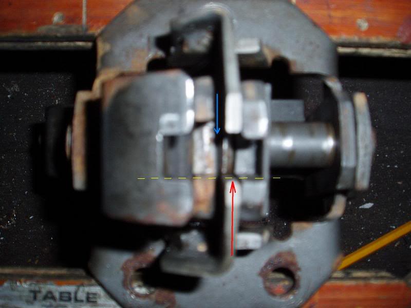

Posted 04 March 2007 - 11:52 PM

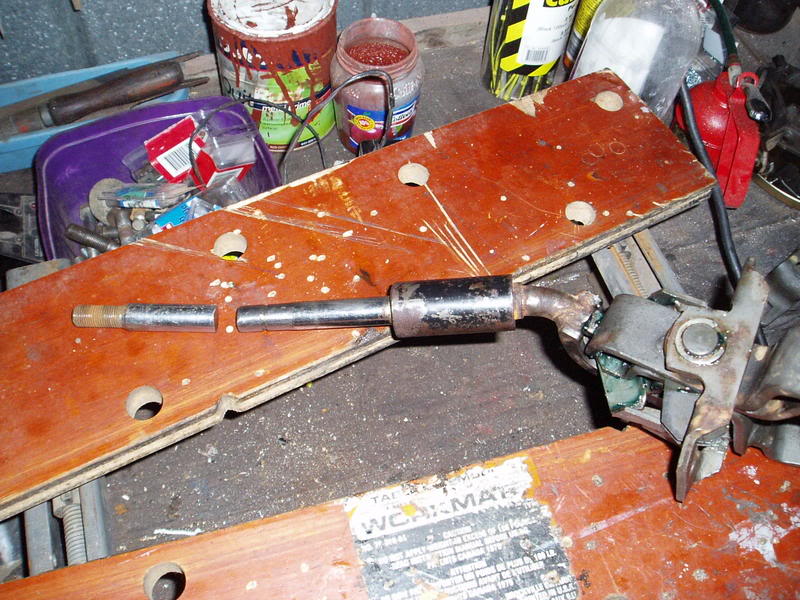

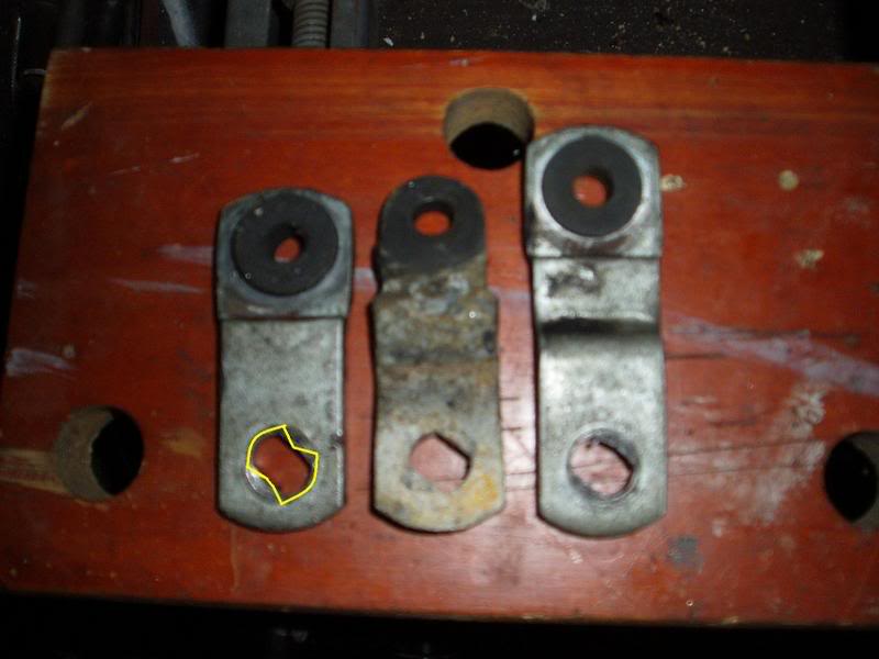

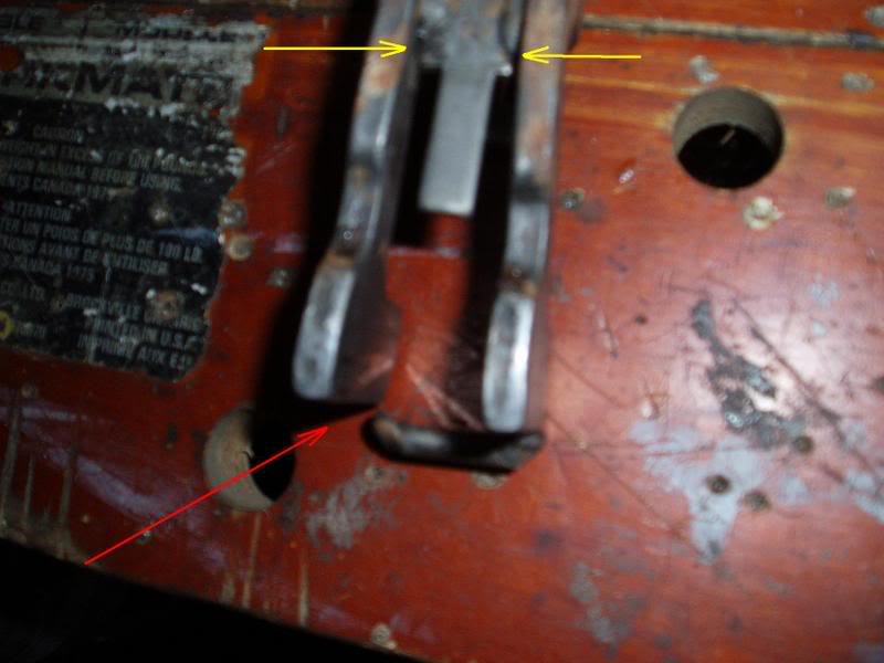

Here are some pics of the shifter rebuild (I built 1 shifter from 2). These are Commodore shifters but they are much the same as Torana. These shifters were bought off e-bay $60 but also included a gearbox. They were from a rally car and I wouldn't normally expect this much damage from a daily.
The red arrow indicates where the piece of coat hanger wire had let go, this is how they were from the factory, and the yellow arrows indicate where the welds at the spring locater had also started to split. Some pretty harsh shifting to have caused this.

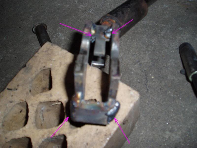

The "through shaft" (blue arrow) from the shifter was used to guage the gap when it was rewelded. A piece of railway track (green arrow) now replaces the coat hanger wire. When it all cooled down it was tight and valve lapping paste had to be used to "work" it and free it up.
The welds were then beefed up (purple arrows)
The shift thrust washers were broken and replaced with the best I had.

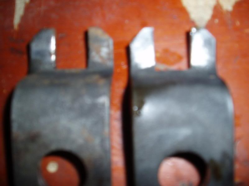

As was the 1st/2nd shift lever. You can see the forks on the R/H lever had started to spread, again from harsh shifting.
Another thing to look for is wear in the side plate shift lever slotted holes. (Exaggerated in yellow) These have to be a tight fit on the sideplate or they will work loose regardless of how much you tighten the nuts. Also note there are different lengths of these levers if you are mixing and matching shifters.
Fit the wrong bits to the wrong shifter and your gearstick can jump out of the gate. Also worn side plate levers will cause this.
Other wear areas are circled and arrowed below in red. Excessive wear in these holes and pins can make shift alignment a nightmare and again the stick can jump out of the gate.
To adjust the shifter, the next pic shows what you are trying to achieve. The yellow dotted line indicates the alignment of the gates, the blue arrow indicates the area that DOES NOT HAVE TO BE ALIGNED as the cutouts in the gearstick dodge around these misalignments. The red arrow indicates the mounting plate that the other shift levers have to be aligned to. I have left the gearstick out at this point for ease of explanation but you can see this alignment through the floor with the shifter in place to make the job easier.
The alignment is adjusted at the trunions on the shift rods.
When you've made your shifter "bullet proof" and done all your adjustments there is one more adjustment left to do :spoton:
In my last post I mentioned that with the side plate off there isn't much to see but you can "feel" radial play in the cluster. Guess what? gearbox rebuild coming up. :fool: :cry: :fool: :cry:
Edited by rodomo, 05 March 2007 - 12:03 AM.

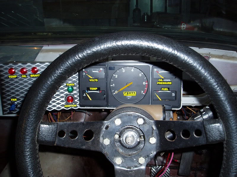

Progress report:
Dash:
Before:

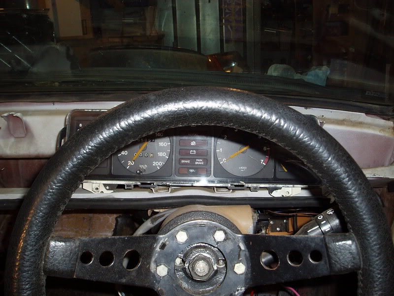

This is what I could see when I went to mount the dash. :fool:
After:
This is the modded dash, not perfect but a lot better :spoton:
Its still not mounted, I have to fit the fuel tank and recalibrate the fuel guage to suit the 120Y sender before I mount it permanently, but at least some progress.

Wo0o0o0o0o0o racing style. Love it! But you've gotta rotate the tacho like 30 degrees anti-clockwise to really fit in with the racing interior fashion :P
Looks good Rob!
#100 _CHOPPER_
_CHOPPER_
Posted 17 March 2007 - 07:20 AM
Since it's a race car, why the indicators?
