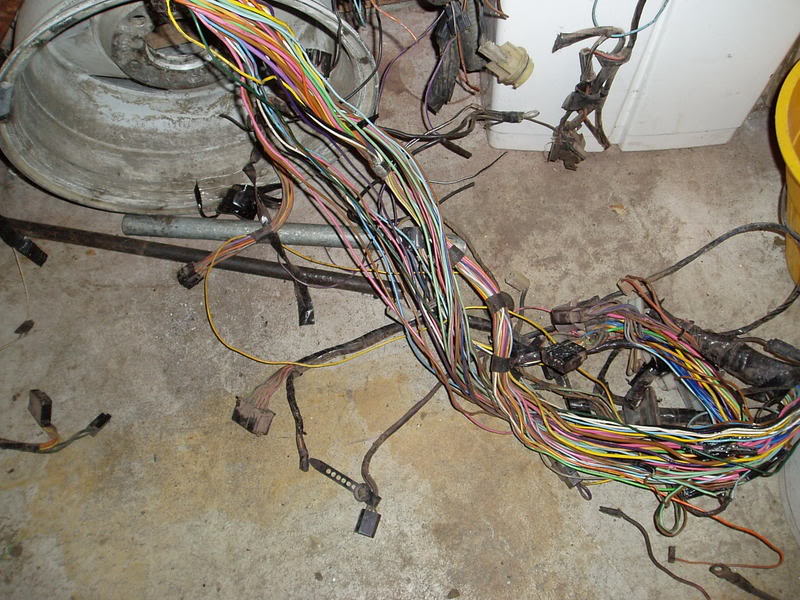

The cable is 253 VC sl/e from pick pay and go. (Mental note: next time at pick pay and go, check to see if 253 HX cable is longer) The bracket is made from an old exhaust clamp welded to a master cly. support bracket. :spoton: (Yellow arrows)

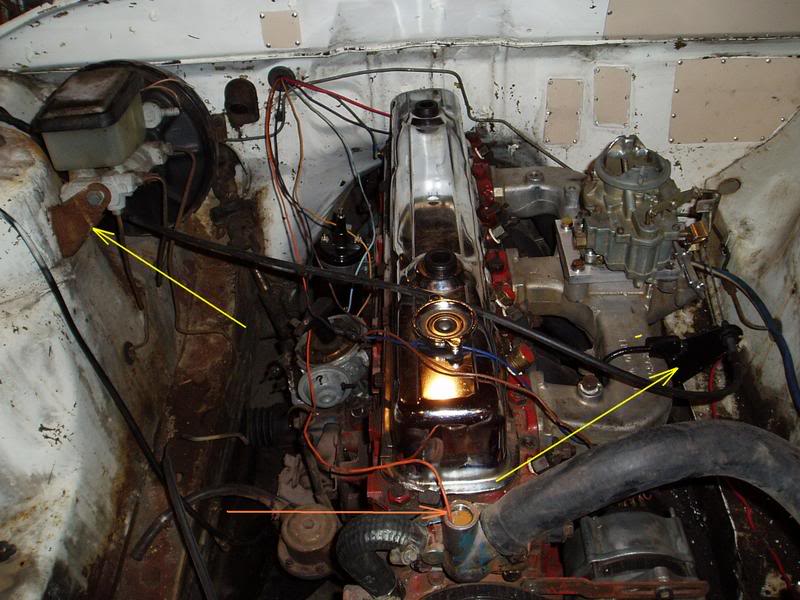

The "spaghetti" is starting to look a bit like a loom, the orange wire, arrowed, is where the "idiot light" sender is going (if I can find one :blink: )
The wires are colour coded to the original colours for a Commodore loom courtesy of a couple of "left over" looms from cars I have wrecked. Again, I dont throw much out but I am running out of room in my shed :blink:

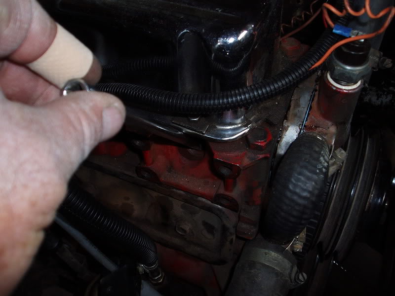

Do you have plans for a catch tank for those rocker cover breathers to run into?
Also, don't forget to put a hose clamp or something on the oil filter to prevent it undoing. Its embarassing to leave a trail of oil on the track and then spin when it gets onto the rear tyres.
I hate having to learn the hard way, but I'll never let it happen again !

Yep. The catch tank is organized but wont be fitted until the aircleaner is sorted out as I wont know where best to run the hoses.
The engine still has the original oil and filter until I warm it up then it will be drained (overnight)and refilled using the smaller oil filter, apparently these are less likely to undo due to less weight? Good tip about the hose clamp!

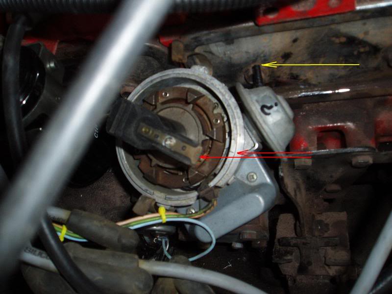

The next check was keep it running and check the ignition timing, maybe I had stuffed up while putting the dissy in?
Here lies the key.
The timing at about 1500rpm was off the scale and about 40 degrees advanced according to the timing light.
Here is a pic of the dissy in the position to get it to run.
You can see that the mark on the rotor and the dissy body don't line up (red arrows) and the Vac. advance is hard up against the side plate.
I pulled out No.1 plug, stuck a "probe" down the hole and with a bit of rocking to and fro found T.D.C. within a couple of degrees. (the bandaid is a result of one of Mrs Rodomo's projects) :blink:
Next, I looked at the timing marks.

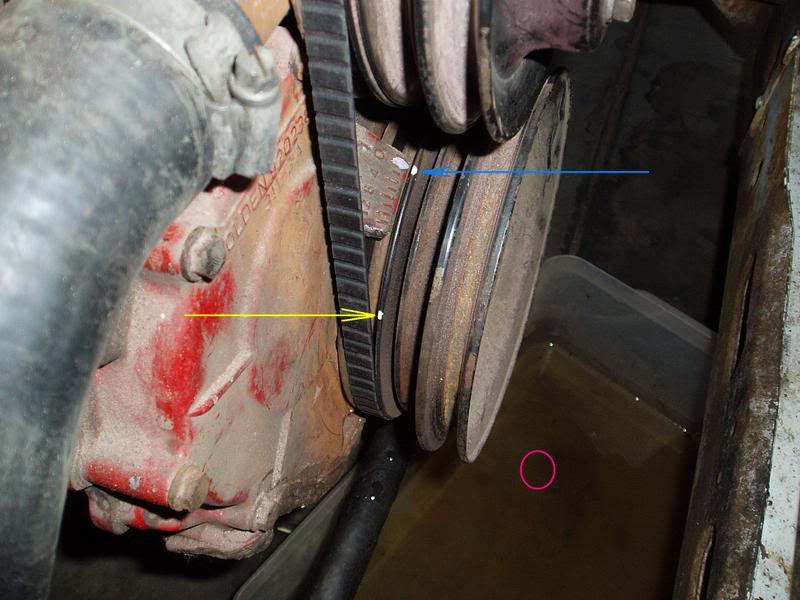

The yellow arrow indicates the "factory" timing mark on the pulley. The blue arrow indicates the "new" timing mark after the T.D.C check. The pink circle indicates the drip tray catching the drips from the "pissing" water pump :cry:
What we have is a classic case of harmonic balancer "slip" to the tune of about 30 degrees. This means the "V" belt part of the balancer (and the factory timing mark) have slipped (retarded) around the pulley hub (which is keyed to the crankshaft)about 30 degrees.
After further adjustments (which meant retiming the dissy a tooth or 2) it ran like a dream (albeit a "wet" dream that neads more tuning work) and this is where the dissy ended up.
The marks on the rotor and dissy body line up better (red arrows) and there is ample room to advance the dissy towards the side plate.
Now added to the shopping list are new harmonic balancer (this "tip" would get you out of trouble but no good in the long term as it would continue to slip). Obviously a water pump, a bit like master cylinders, not worth mucking around with second hand. And of course a fuel tank. :cry:

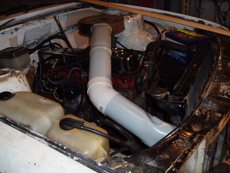

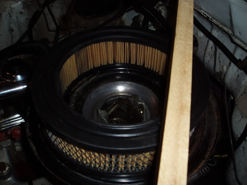

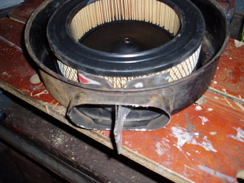

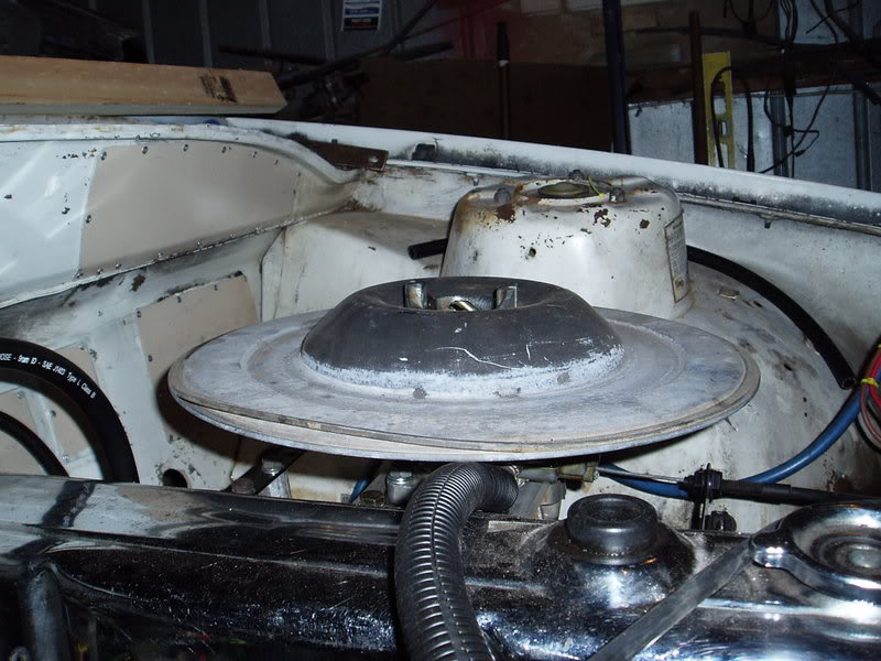

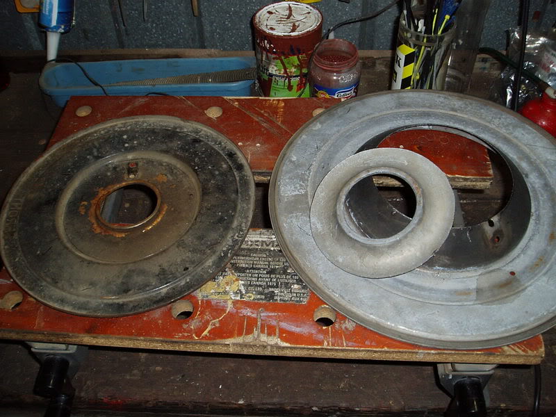

Induction.
This is the RoDoMo patented ram cold air velocity stack diffused induction system.

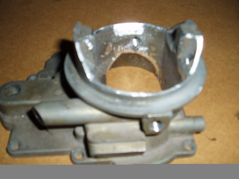

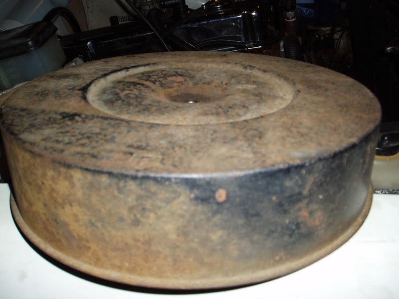

First task was to find an aircleaner base to fit the WW2 and not cost an arm and a leg. A wander around pick-pay and go with the verniers found a 2 barrel Valiant base had the same size hole as WW2.
The way this fitted might mean a cheap alternative for others? The element is bigger than an A24 (standard Holden element) and it clears the rocker cover and accelerator pump on the WW2. There are plenty of these at pick-pay and go type wreckers.
But I chopped it up :spoton: and graphed it to a VB 6cyl base.
The early 6 cly aircleaners e.g. LJ (the ones with the big clamp handle off to the side) didn't flow too well, but the later ones were better as they are flatter in the base. I also "pressed" the depression in the lid to "aim" the air flow better.
The VB base was also inverted to give another 10mm of height. The lenghth of timber was used to check bonnet clearance.

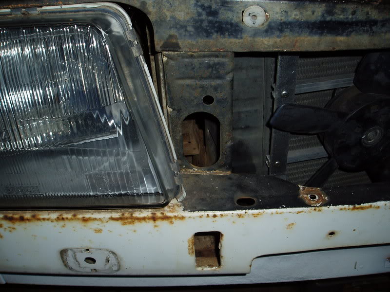

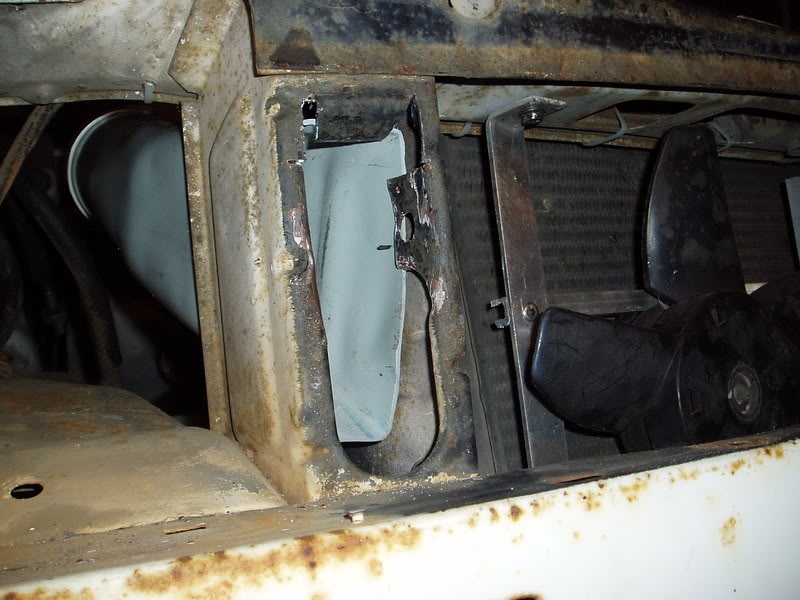

Next the factory hole on the R/H rad. support upright was "adjusted".
Rather than just chop the hole out I sectioned it and folded it in to retain the tube.
The XU1 even got a run! (I wish it was a real one :cry: )
And with a bit of heat the tubes were forged.

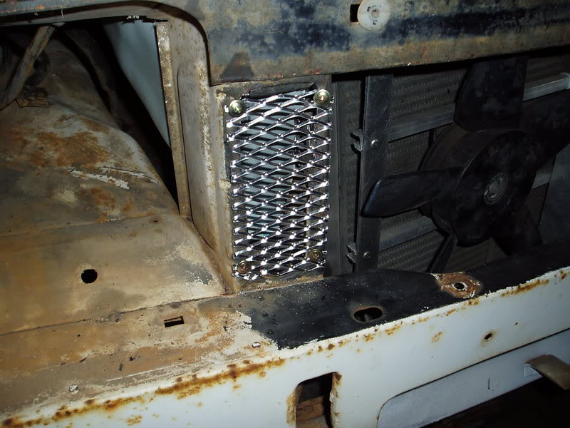

Next the "brick catcher" was fitted.
And the "diffuser" to A. protect the element from obliteration from debris and B. direct the flow evenly left and right to hopefully "pressurize" the the aircleaner to a degree. (I'll be happy with 8lbs boost :blink: , should I run a wastegate and a guage?)
Remember this pic?
The airhorn was chopped up previously as this A/C mod was always the plan.

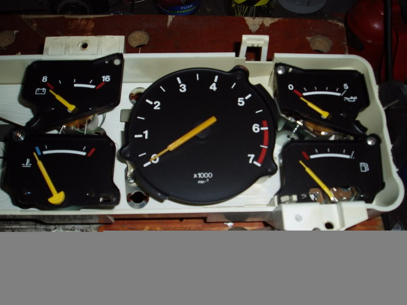

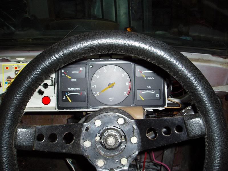

So I thought I might have a look at mounting the dash. This pic was taken with the camera up to my eye with the seat adjusted for me and the dash roughly in the factory position.
This is what I saw (or didn't see, more to the point) with the sports steering wheel mounted.
So adjustments were made. Something had to go and I chose the speedo and the factory idiot lights. The whole unit is moved closer to the driver approx. 100mm. I really don't think I'll be towing too many trailers and might be aware if I leave the handbrake on without a light to tell me :huh:
High beam lamp? Maybe if I turn to rally but unlikely. Brake fail lamp? I think I'll know something before the light tells me. If not it will probably be too late anyway. :blink: The speedo may be remounted remotely after the diff ratio and tire size are finalised.
Here is the "rough in"
And what I "will" see when it is finished. The area to the left in the yellow triangle will be roughly where the new "idiot" lights will be and also the illuminated fan switch, lights up when fans are on.
As this mod had to be "thought out" and some high tech methods employed, e.g. glueing, measuring and soldering, I no longer regard this as a dash but more "an on board integrated telemetry readout" :blink:
