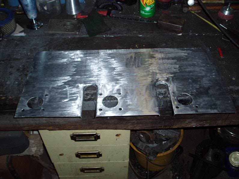

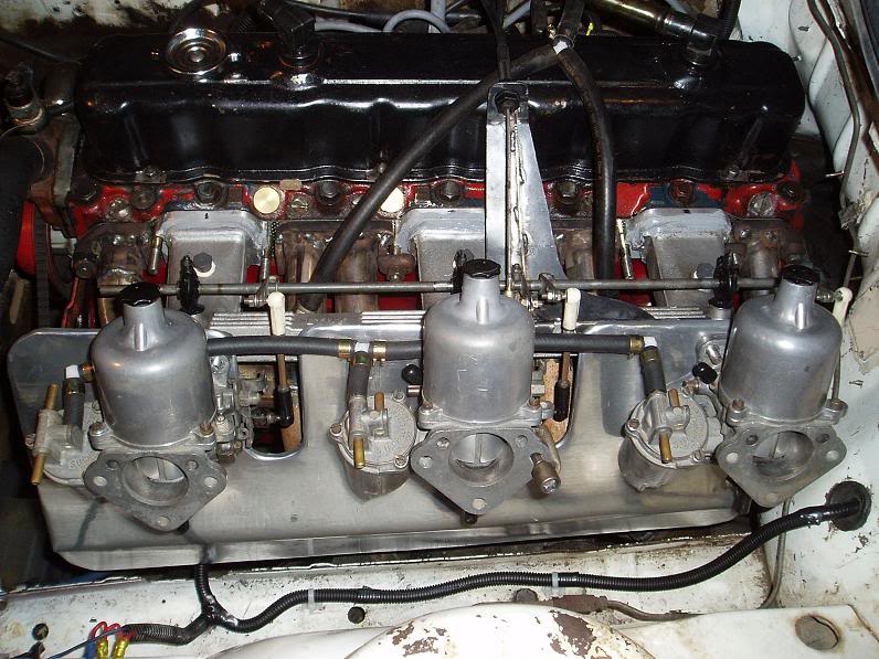

Splash / heat **BLING** sheild thingo.
And accelerator cable bracket

That should keep the carbs a little cooler.
#555 rodomo
Posted 09 May 2010 - 08:11 AM
I hope so? Or will it pull heat from the extractors and sink it into the inlet? :dontknow:

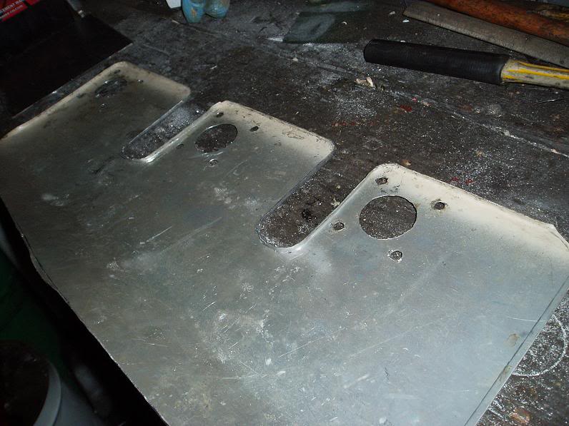

If you look at pic 3, you'll see that it follows the inner edge of the chassis rail. It also follows the horizontal profile of the rail with a 20mm gap.
There is a big hole in the LH rad. support upright that should direct cold air into this area. Might have to help it with some ducting. :)

is it possible to mount it free of the intake?
then it wouldnt be able to 'sink' to the intake as you mentioned.
#559 rodomo
Posted 09 May 2010 - 08:40 PM
Bit hard. Not in the pic are the fuel feed lines, the over flow lines or the "Super Dooper" aircleaners. It's getting a bit "busy" under the bonnet. If I can get enough cold air into the area it will hopefully be O.K.

I made a similar shield when I fitted the 1 3/4", the temperature of the rear fuel bowl reduced dramatically, as it used to boil the fuel. I had the same concern that it may act as a big heat sink, but it works ok.

nice work on the extractors, and same same for the 9 to 12 port swap on the inlet! thought about making an airbox for the filters and sealing it up against a dirty big hole in the bonnet, covered by some kind of home made scoop?

nice job you should try a cold air induction with a reverse scoop ......make a air box and have it seal on the bonnet i will take a pic off the sports sedan's setup in the shed (if i work out how to post it)
