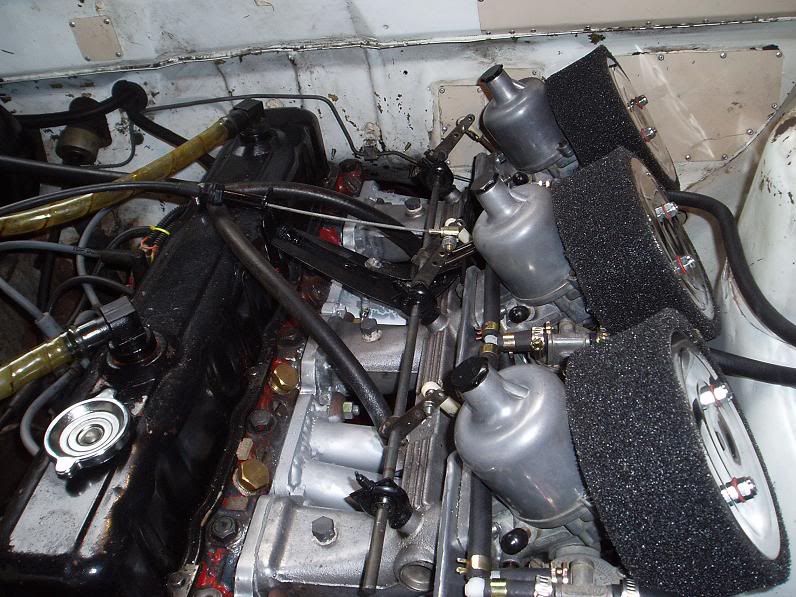

I had a look tonight and it might be as simple as shortening the short links from the common shaft down to the levers. Right now they are as short as the adjustment allows so I might have to buy a die nut and run them down a bit shorter.

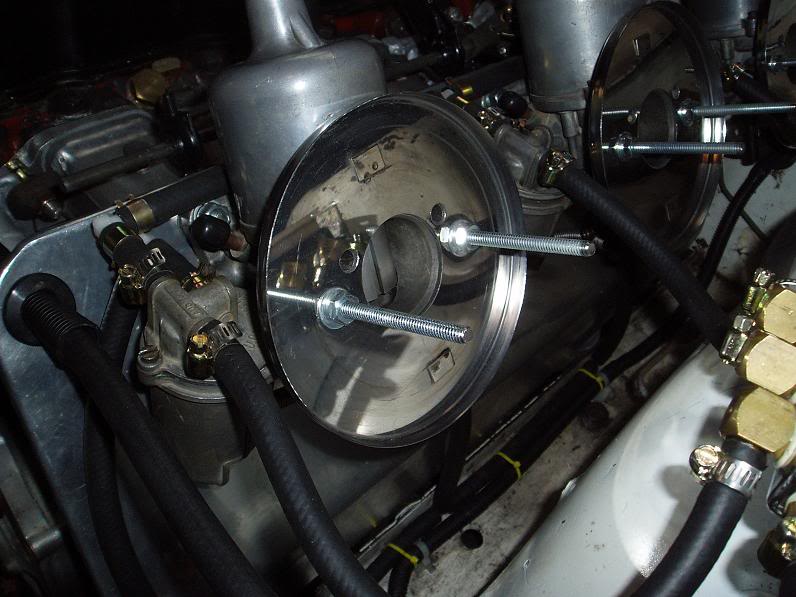

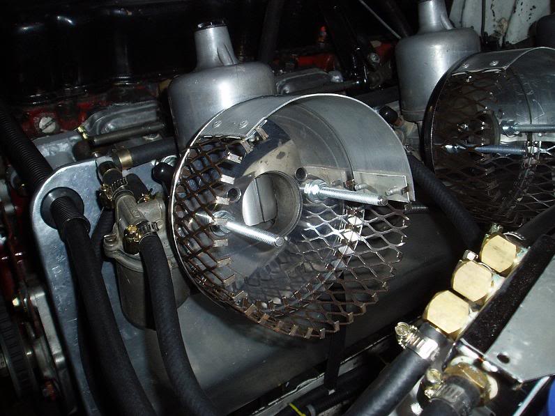

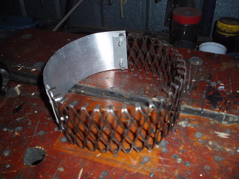

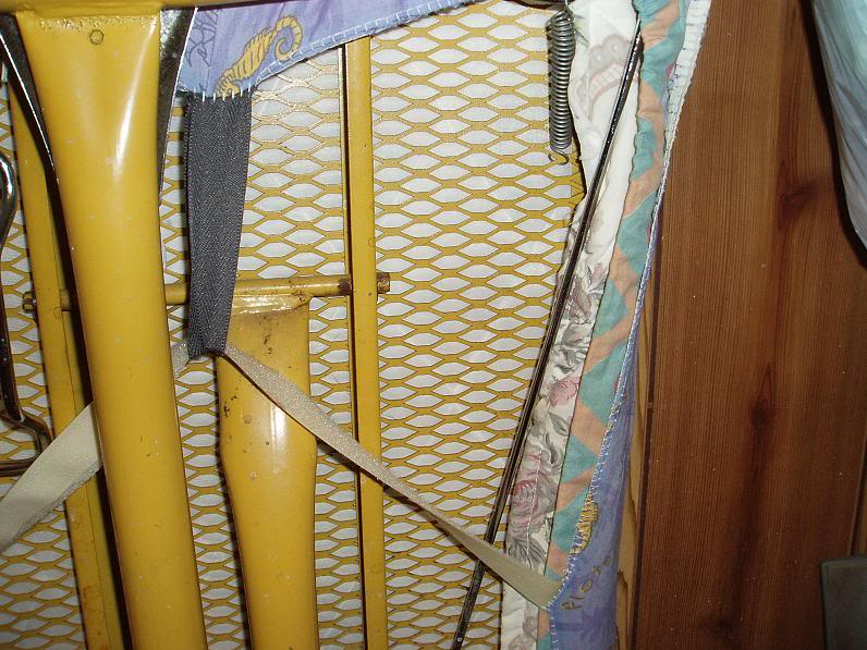

AIR CLEANERS:
Picked up an ironing board similar to this off hard garbage. Took it home, cut the mesh out, and had it back out on my nature strip before the truck came. :spoton:

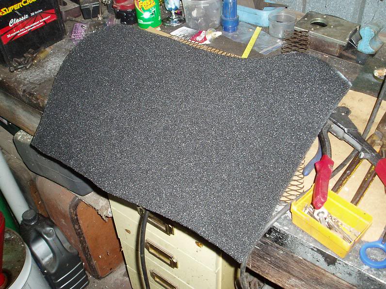

Bought a sheet of this from Clark rubber for $10. It's called air conditioner filter in the shop.

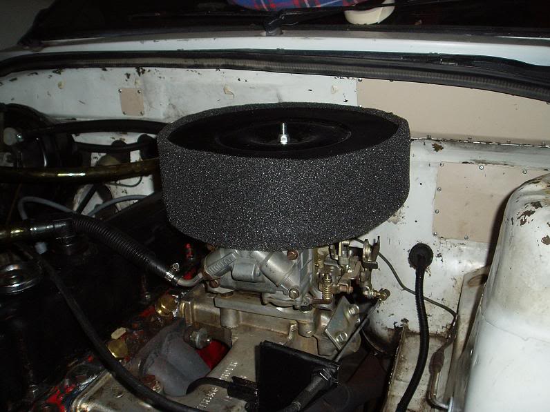

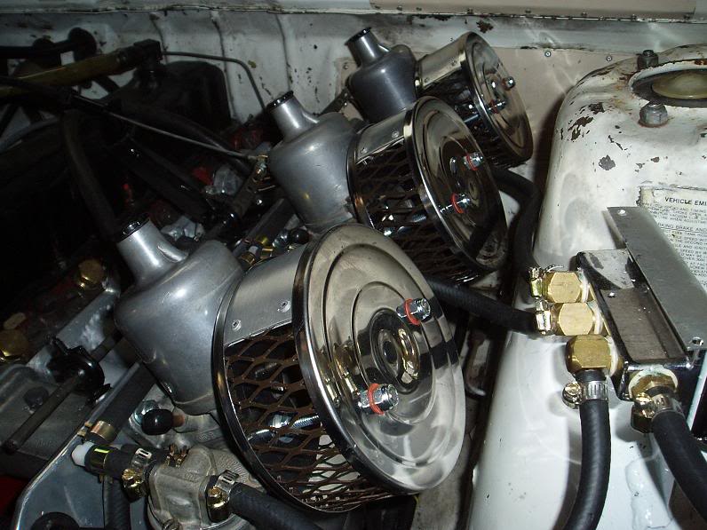

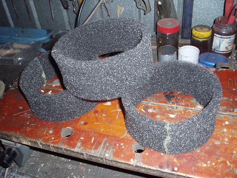

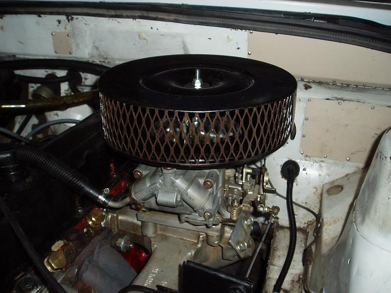

Made up a set of these. I have masked about a third to try to stop unwanted turbulence over the piston vents.
I had done the same mod to the Holley air cleaner prior to the drag day but never got to try it.

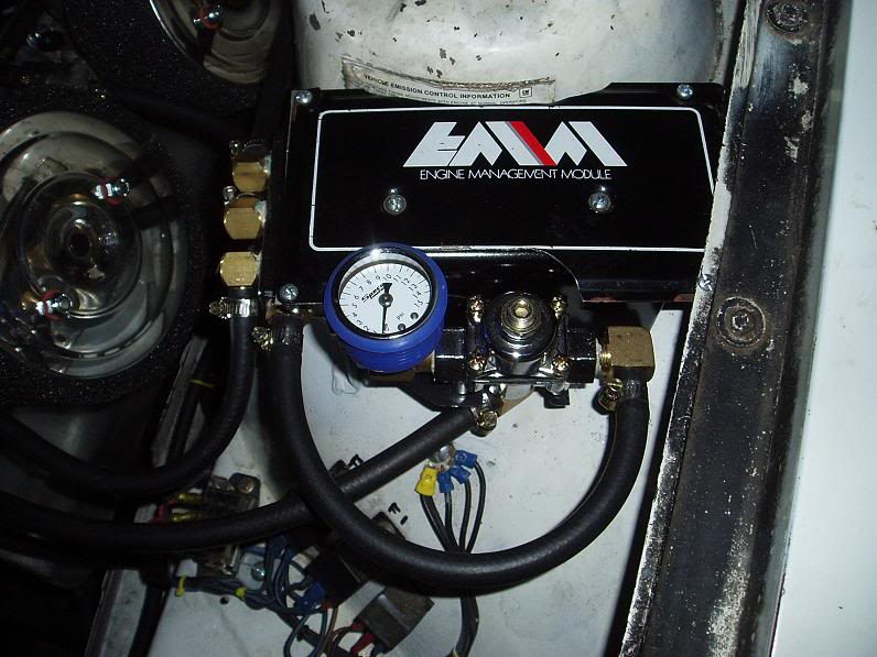

The reg, gauge and fuel block.

_@milco@_
Posted 20 May 2010 - 05:35 PM
ahhahahahahaah i love the engine management module!
THAT was a very hi-tech, unique piece of Holden ingenuity in its day. :huh:
AND it held all the mystery of a Polarizer! :ph34r:
Didn't do much but every mechanic had to undo the lid and have a look inside. :spoton:

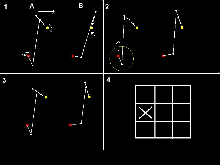

Hey rob is the problem in the linkage angles?, i had a prob with my old xu1 with the same symtoms it was very close to either idle or flat as it was very hard to get a progressive opening. it was 2 things the engine had alot of mani vacume at idle and with the linkage pivot points set for racing it was not goiod u know, long lever working on a short one, so i made a long lever at heater box end of linkage and it solved that issue. :spoton:
Sort of but this is different to genuine XU1 set-up. SU's, dodgey plastic ball pivots, cable rather than solid link............All after market stuff.
The red dot is the butterfly shaft and the yellow dot is the torsion rod.
The arrows show direction of rotation of the shafts and cable pull direction.
Pic 1(a) is how it was at idle.
1(b.) is foot flat but you can see that the adjustable link was hitting the torsion rod before full throttle was acheived.
2(a) & (b.)
When Makka and I checked full throttle, I moved the adjustable links up a hole.
This gave it more stroke but it also meant the starting angle at the butterfly was more acute. As I pushed the pedal, it was trying to lift the butterfly shaft up rather than turn it, hence the stickyness trying to get it off idle.
3(a) & (b.)
I'm hoping if I shorten the adjustable link I can put them back in the middle hole. It will time the 2 levers better (bring the torsion rod lever down) and hopefully find a happy medium? :huh:

Thanks for the input guys but it's in a Commodore and they are straight cable, no linkages between the pedal and the engine.
Gunmetal LH, I think I'd prefer a solid link for positive closing? :huh:
Hayden, I had a look at a set of CD's today, the lever is on the opposite side of the butterfly shaft and the linkages push down to open whereas the SU's pull up.
I've got on to some cheap steel ball pivots, I'll buy a couple and let you know if they are suitable.
In the mean time, I have a few coat hangers at my disposal to cut up and bend to replicate the 3 adjustable links to see if there is a medium. :spoton:

Fiddle fiddle.............fiddle fiddle............. :ph34r:
The R&D team have spent an hour or 2 in the shed and here is the report:
If the ratio of the hypotenuse is adjusted to the axis of the parallelogram, then the tangent of rotation will be such that the angle of the giggle pin will align with the laffin shaft. :blink2:
Basically, if I shorten the adjustable links by 25mm it should work. AND it only cost me 1 coat hanger! :spoton:
What am I gunna do with the other 19 that came in the pack? :dontknow:
I just have to identify the thread on the adjustable links and find a die nut.
3(a) & (b.)
