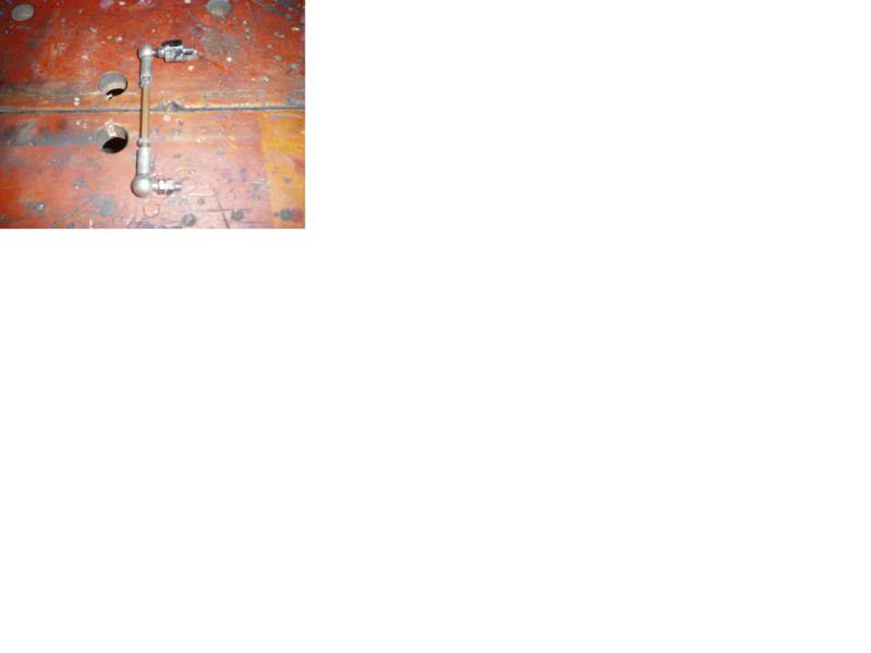

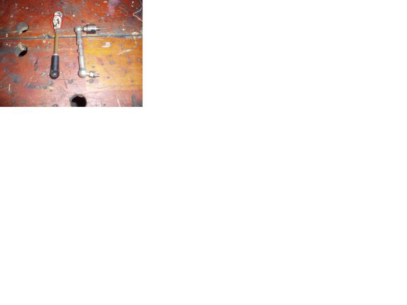

Basically, if I shorten the adjustable links by 25mm it should work. I just have to identify the thread on the adjustable links and find a die nut.
The thread appears to be 3/16th UNF as far as I can identify it. Research also says it is a No. 10 die nut? :dontknow:
Fitter and turner needed here as the blokes I have spoken to (tool shops) aren't as sharp as their chisels? :banghead:
BUT!
The roving R&D team have found the Nissan Pulsar fuel injected throttle body links MIGHT just do the job?
These might be the same as late Camira EFI???? Dunno? At pick a part I just went up the Nissan isle when I saw this linkage?
It is about an inch shorter, has a left and right hand thread and has steel ball pivots.
I also found that these ends will screw onto the original links.
The thread pitch is the same but the OD thread size is .005" bigger.
P.S. I'll learn how to drive Vista sooner or later, bare with me. :banghead:

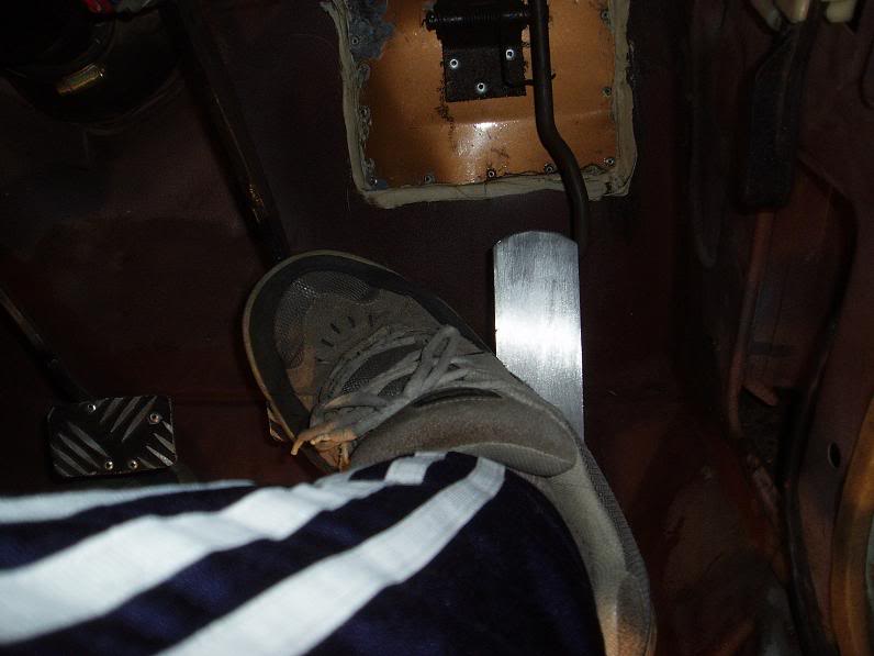

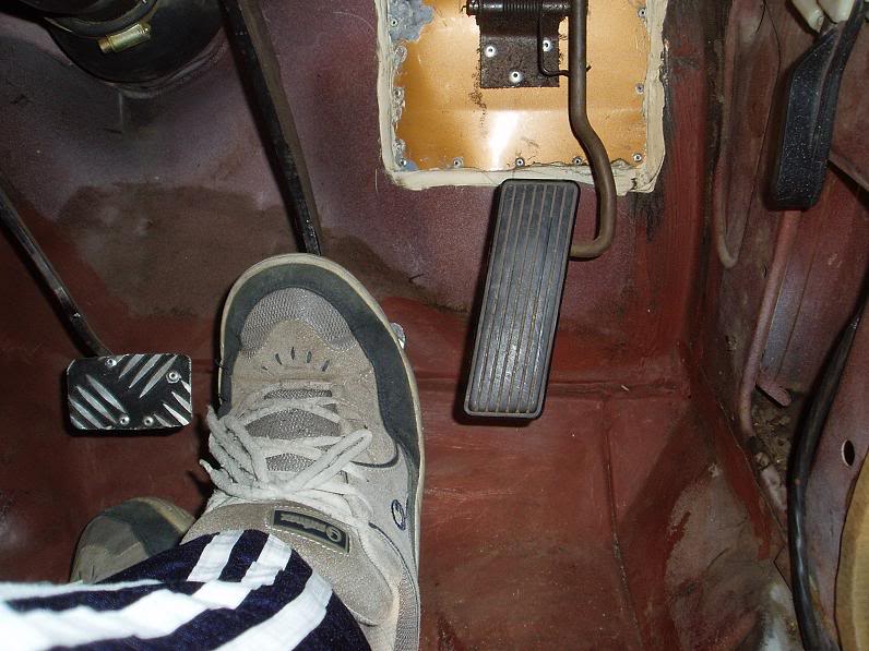

I've modded the accelerator pedal so I can "heel and toe"
This is the original set-up
You can see how far and disorientated the acc. pedal is from the brake and the angle of a 51 year ankle to get to it, even then just hitting the bottom of the pedal. :blink:

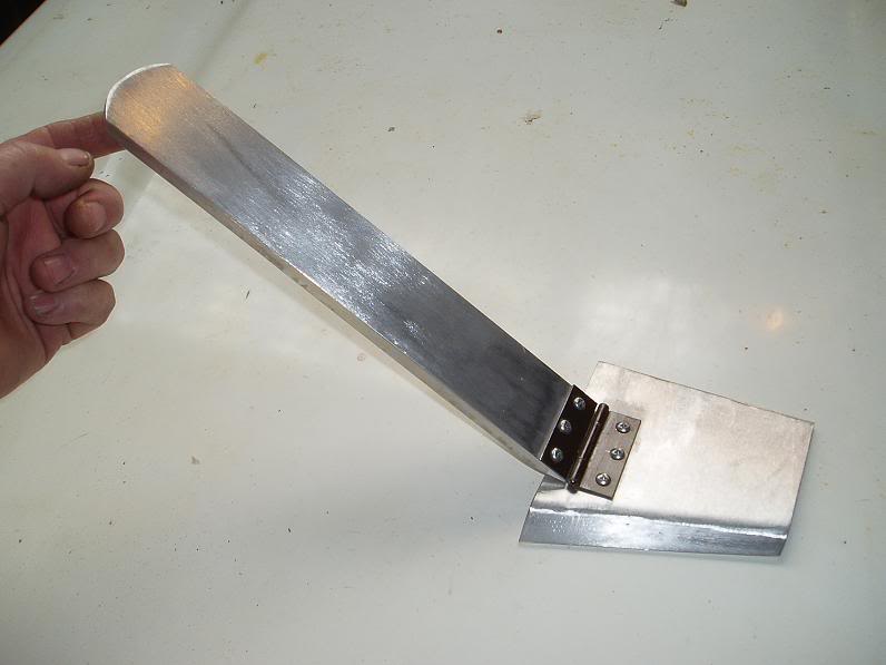

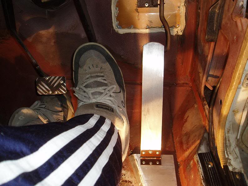

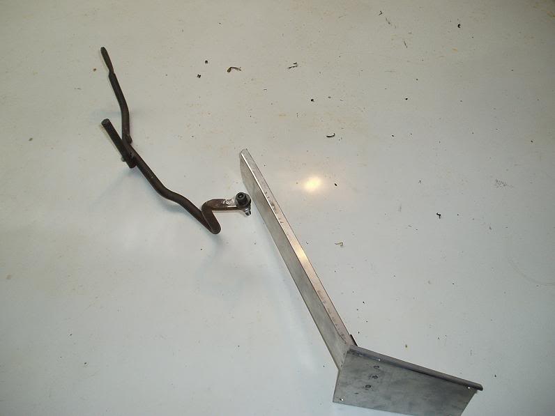

So the fabrication team went to work and produced the RoDoMo racing treadle.
(Only available in brushed aluminium finish at this stage)

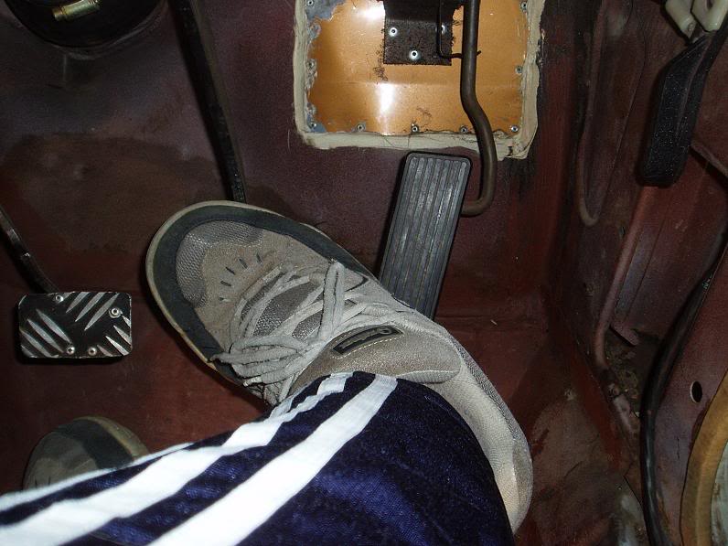

More pedal to hit. :)

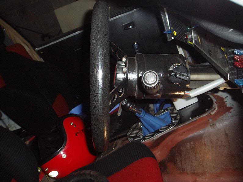

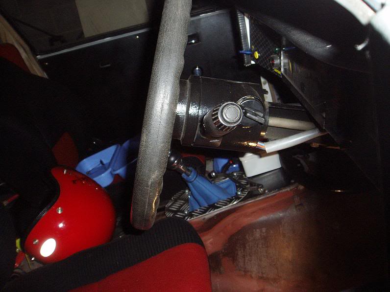

Also, I've changed steering wheel.
Being a tad vertically challenged, when I had the distance to the pedals right with the seat position, I felt my arms were too bent when steering.
The indicater stalk also had to be "adjusted" with a heat gun to give knuckle clearance.

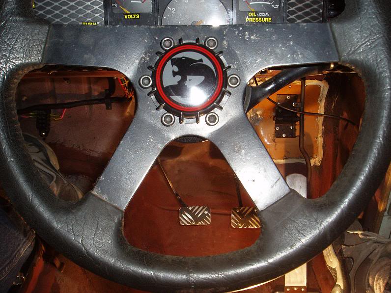

And while we're on the subject of seating position, as we are all aware of the angle of the steering column to the seat in LC/J, something I noticed while retightening the wheel was the position of the clutch pedal through the steering wheel spokes.
You'd think the brake pedal would be more in line? :dontknow:
Braking and accelerating are done with the right foot :blink2: and the right foot is on the accelerator most of the time if you are doing it right...
Depressing the clutch is done with the left foot but is done a fraction of the time in relation to actual driving ao the left foot is at rest most of the time, this would redice driver fatigue one would imagine. :wedgie:

I cant heal and toe with my foot either, I cant turn my foot in at all really, so a mod like this would be tops
#610 Heath
Posted 05 October 2010 - 06:58 PM
Yeah well cars are designed that way, apparently gimps are less likely to go for the brake and hit the accelerator if it's slightly further down towards the floor? Shits me to tears anyway

No, it's a different wheel. I got it off a wrecker because my LJ didn't have a wheel when I got it.
It didn't fit the LJ, it had an LC boss, so I took the wheel off the LC boss and mounted it to the Commodore boss.
You can see the holes in the spokes of the 1st wheel.

It would be a crime against humanity not to drill at least a couple of speed holes in that pedal....
No speed holes but it's got a "roller rocker" arm :spoton:

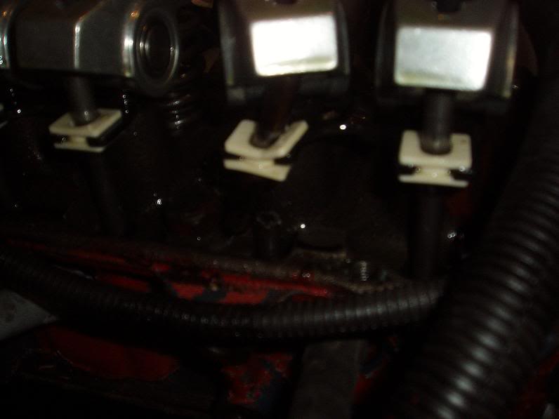

The rocker gear sounded a little noisy while tuning the carbs so I added adjustment to the list, no problem, 1/2 hr job? :huh:
I restarted it Sat. arvo and not only was it rattley, it had developed a miss? :dontknow:
Spark from lead?...... CHECK
Swap plug, any change?........NOPE
PULL FREAKIN' ROCKER COVER OFF???????........... Smashed pushrod, no, not bent, smashed like a snapped carrot! :blink2:
Bad pic but you can see the rocker out of alignment.
Ring engine builder buddy...............
Me: Why is this happening? :huh:
EBB: Because you're a dickhead? :dontknow:
Me: How can we fix it?
EBB: Shorter pushrods, I have some V8 ones here, they're shorter, try them.
So............ drive 1hr there and back, grab pushrods, go home, finish oil change on tow car, try pushrods, too short, dig out a set of standard pushrods, ring EBB and suggest pre-loading lifters?, fit 6, drive Dad to Bingo (25 mins), come home, swap cars, pick up trailer, fit other 6 pushrods, fit grill, drive back 25mins to pick Dad up from Bingo, finish off other crap, load tools and spares into tow car and drive car onto trailer at midnightish............. :Headbang2:
