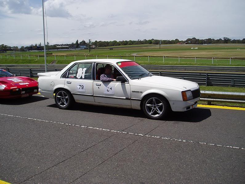

Yes! My un-official fastest time was 1:42:92! Thats 5 seconds+ faster than last time. :spoton:
My mate did un-official 1:40:60! Thats the difference 300+ laps and 15 years younger makes I suppose :<_<:
Un-official as we are waiting for the results of the last stint of the day so maybe quicker?
The inheriant miss-fire reared it's ugly head again, and again it was 5h1t in the carby. We sorted it out quick this time. :spoton: I am begining to wonder whether it might be dried up fuel residue because the car sits for 6-8 weeks between races?
Heath came, and went in the car in the warm-up with my mate.
He left in the direction of the station about 1 ish mumbling something about valuing his body more than his head?
Heat stroke? Gee I hope he's ok? :blink:
The car did approx 65 laps today (which works out to about 195klms around Sandown) in 10 lap stints. As it was cross entered it meant one jumped out and the other straight in then a 3/4 hour break.
The car pulls 5250rpm on the main straight @175kph compared to 3700rpm with the old diff, you only need to use 3rd and top gear.
With the tyres and suspension it handles more like a go-cart than a speed boat now.
A couple of "fixes" from the day. The top half of the gearstick came out of the rubber bush a couple of times and an oil leak developed at the rocker cover.
The car looked like a used bingo card.

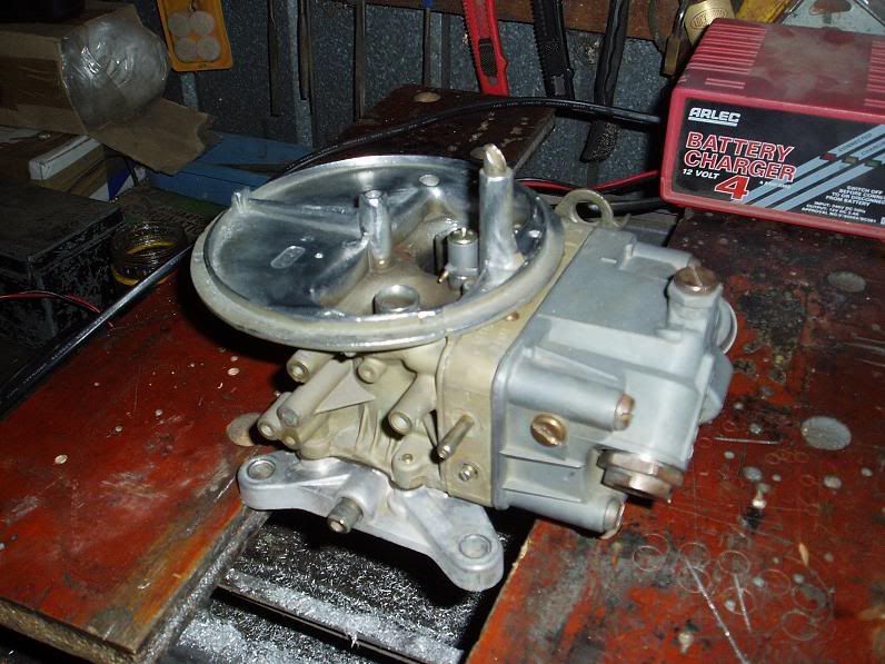

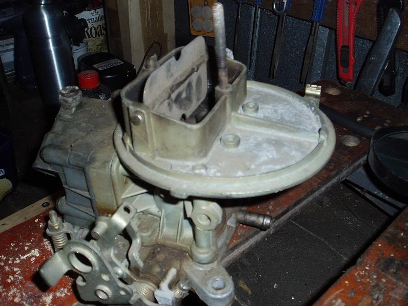

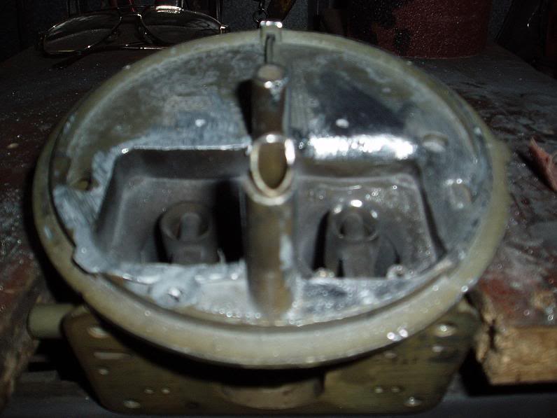

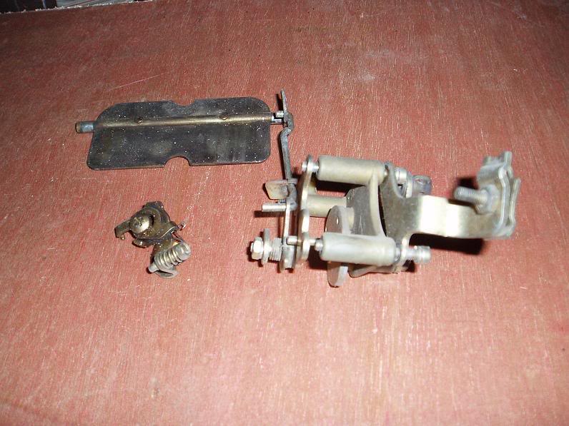

Bought this 350 Holley, $50.00
Sold these bits on e-bay for $31.00
Got to it with the angle grinder and burrs.
Ended up with this for $19.00 :spoton:
Positives : Bigger float chamber and central needle and seat. Slightly bigger than WW2. Bigger parts bucket.
I need 2 adapters to fit it which adds up to over 1" spacer.

Grinding the top off a holley can actually decrease flow, they spent years perfecting that type of carb, secondly, throw it in the bin and buy a falcon 6cyl type weber as the butterflys open towards the motor, unlike a holley which can restrict flow on a holden 6. JMHO.
Edited by ALX76, 23 May 2008 - 12:25 AM.
#207 rodomo
Posted 23 May 2008 - 12:46 AM

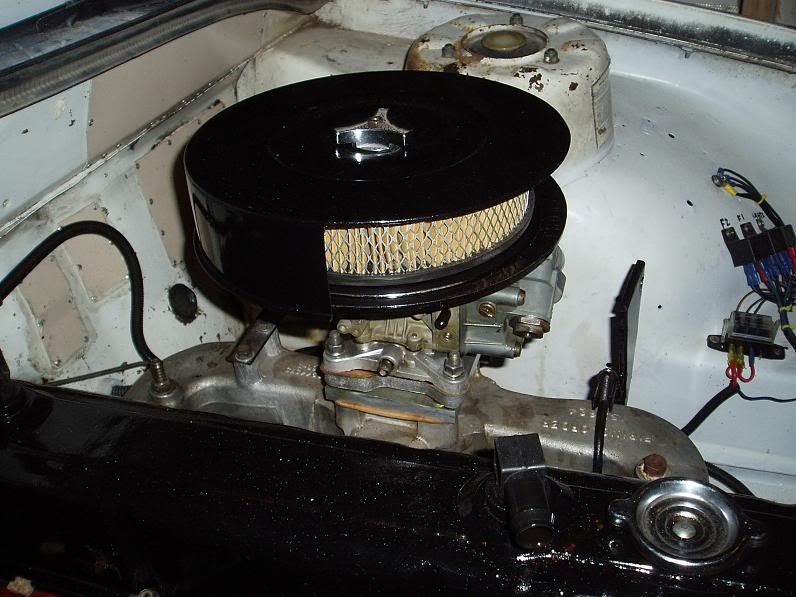

Aircleaner: (from previous posts)
The important things:
It has enough H.P now to make the clutch slip and I can lose it coming on to the main straight :blink: (I have to learn that the accelerator pedal is now not an "on-off" switch.

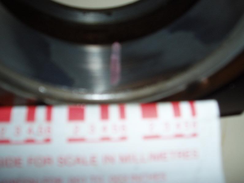

The bearings were the issue as expected, the cam gear squirter is still in place. :spoton:
I flexi/plasti gauged the rear, centre and front mains and a couple of conrod bearings and the were all out of tolerance. The rear main was the worst at .005"
Fortunately, the crank will see a few more turns. :D
You can see the wear in the pic.

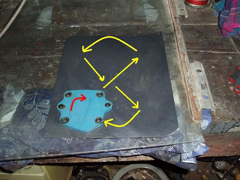

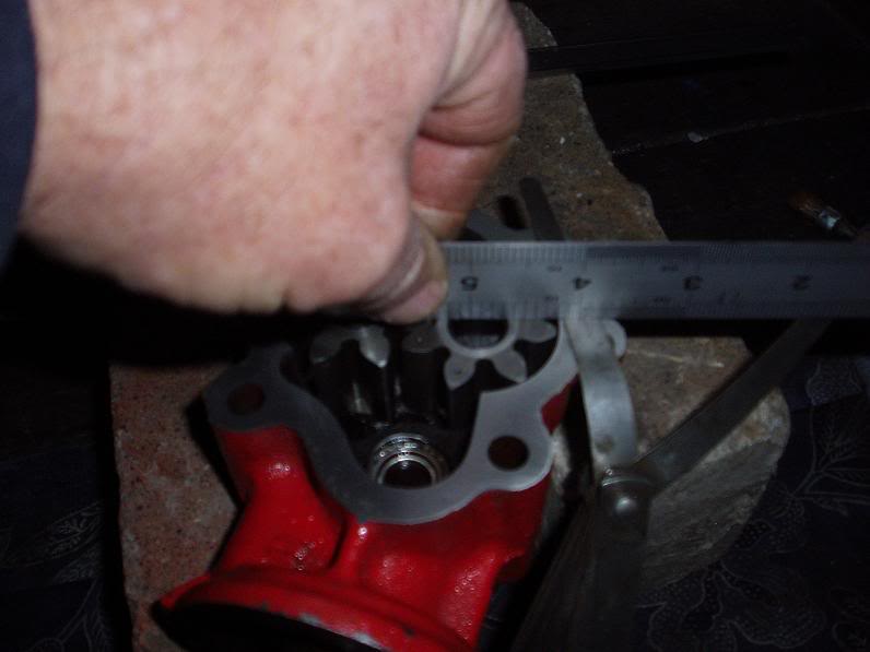

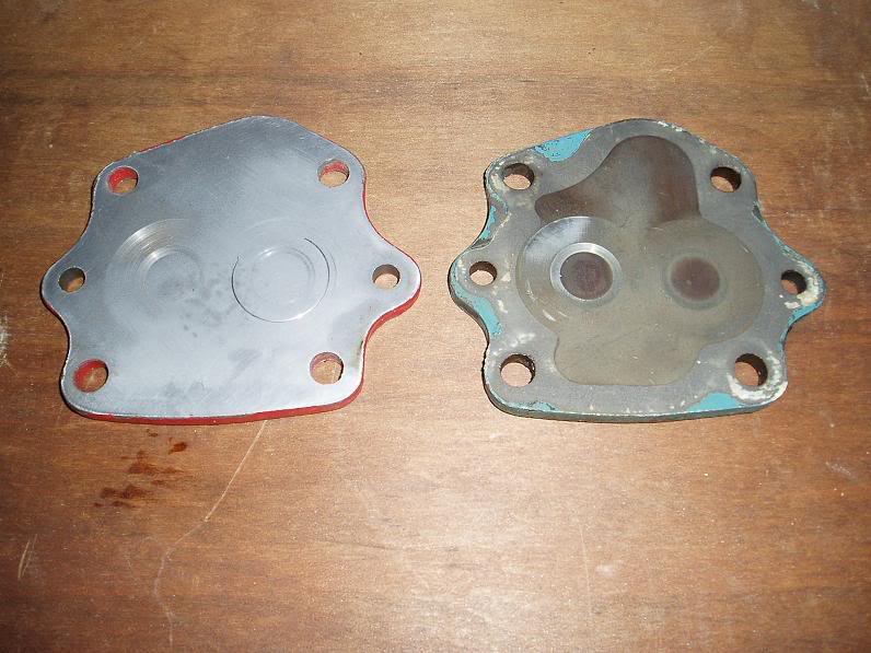

I thought I'd best have a look at the oil pump and give it a "tickle up".

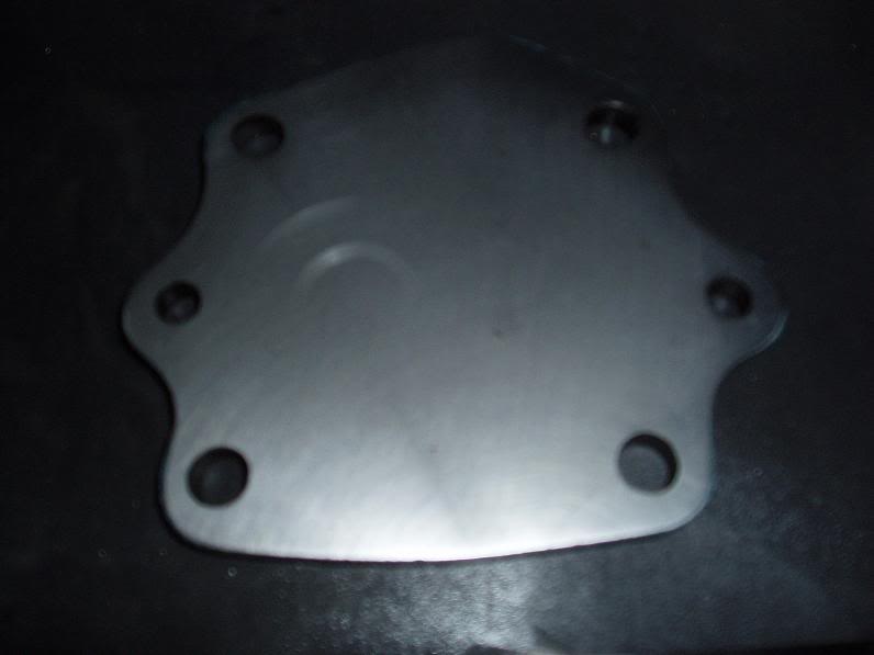

I gave the end plate a bit of a surface and opted for a better one from a blue engine pump.
I rubbed it on a flat piece of glass using wet and dry and kero. To do this, you move in a figure 8 movement and rotate the plate 1/4 of a turn after 10 or so figure 8 movements. This gives an even finish to what ever it is you are trying to make flat.
I wasn't overly concerned with removing all the wear but rather to remove all the factory machining marks. This way, I know it's flat and I havent removed too much material that might make it warp as I bolt it up.

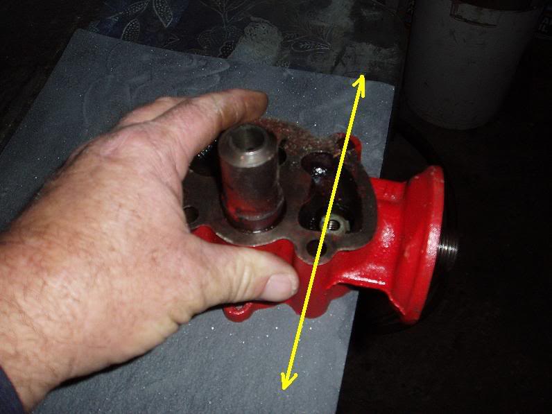

Next I rubbed down the pump body to achieve a minimum clearance gear to body.
Because of the filter flange, this can only be rubbed in a straight line.
After 20 rubs in 1 direction, I did 20 rubs pushing from the other direction to ensure a "square" finish.
I was looking for .002" gear to body clearance. This is measured by how far the gears protrude from the pump body. As the gasket is .008" thick, I was looking for .006" protrusion. I took .002" off the body to acheive this.

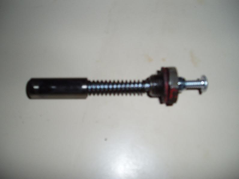

The last mod is the relief valve limiter.
By replacing the bearings and clearancing the pump body, I should gain a fair bit of idle oil pressure.
The relief valve spring will govern the maximum oil pressure but won't give better idle oil pressure.
This mod gives an adjustment of maximum oil pressure by limiting how far the relief valve opens.
The plug has been drilled and tapped and a 3/16 UNC screw inserted to limit how far the relief valve opens. The spring hasn't been touched.
This has to be adjusted hot with a gauge attatched.

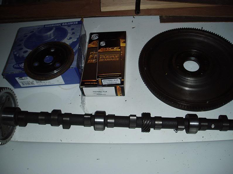

More go fast bits. Thanks again to LC69GTR for the flywheel :spoton:
Next is the balancer mod.
