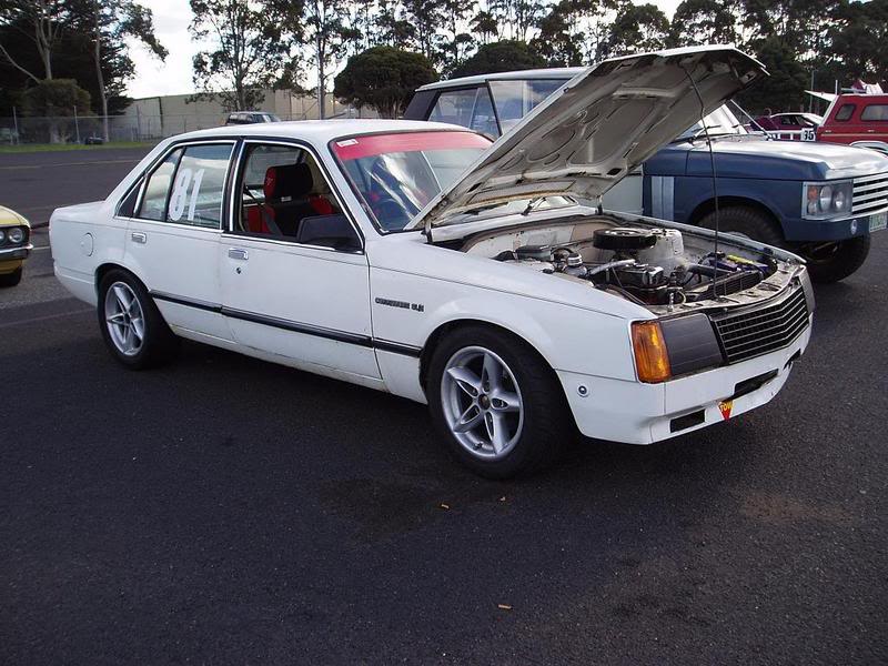

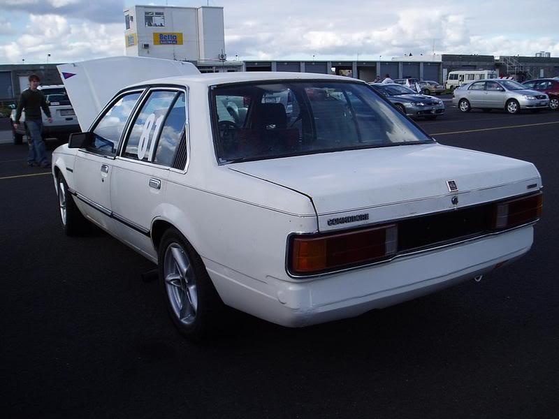

RoDoMo Racing Race Report:
Sunday 3rd June:
Sandown:
Track: Dry
Weather: Mostly sunny.
Attendance: Heath, Olden64 (Tim)
Practice: 10 laps of Sandown every night this week on the simulator.
Qualifying: "Yeah mate, just put some tape on the positive battery terminal and you’re in" :spoton:
I have never driven at Sandown before and coming off the back straight, over the crest, at Dandenong Rd I had no idea where the track was as there were witches hats and I wasn't sure of which side to go on. I was a bit like a granny looking for a parking spot at the shops. :blink:
1st timed lap of the day was 2.02.34, Next couple of laps were 1.56's and at the end of lap 3 the hydraulic governor kicked in and it wouldn’t rev over 4500.
We pulled the rocker cover off between stints and No.3 exhaust wasn't opening or closing (and others looked suss when cranking). Before the next stint it all bled down again and I kept the revs down and learnt the track a bit better. Times in this stint were around 2.00mins flat.
Olden 64 was there and we hatched a plan for stint 3 that the out lap was a sighting lap (low revs) and give it to it on lap 2 (before the lifters pump up) It did a 1.54.78 which included a half loose arrival at turn 2. I was revving it to 5500 (I had settled on this RPM for maximum for the day anyway as the motor is an unknown) but by the end of lap 2 it was starting to miss. Lap 3 was virtually a cruise and was red flagged when another car went off.
There was only one more stint (heaps of cars there) and you had to have working lights to get on the track which I don't have.
The calculated speed on the front straight at 3500 (which is all it would push) in top is 160.21 kph. It should get a bit quicker with the valve train sorted and a 3.45 diff I hope. (And a certain old fart might learn the track better :huh: )
Race tyres would be good and better brake balance.
Technical:
The breather hoses were no drama and brett_32i, you are correct as far as my reading of the regs. but these things aren't heavily policed. On this engine, at the end of the day, there was no visable oil in the breather tubes :spoton:
The timing ended up at 10 degrees with the dissy mod.
Carby mod. worked a treat, no flat spots.
Posted Image :driving: :driving:
STOP PRESS!!!!
I just received an e-mail from my mate with the turbo bluebird. He has 4 16" used race tyre for me...........FREE! :spoton:
Edited by rodomo, 03 June 2007 - 10:53 PM.
