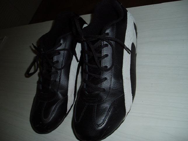

Light weight, flat soled "Body Glove" shoes: $12.99 Dimmeys

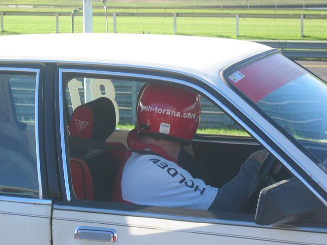

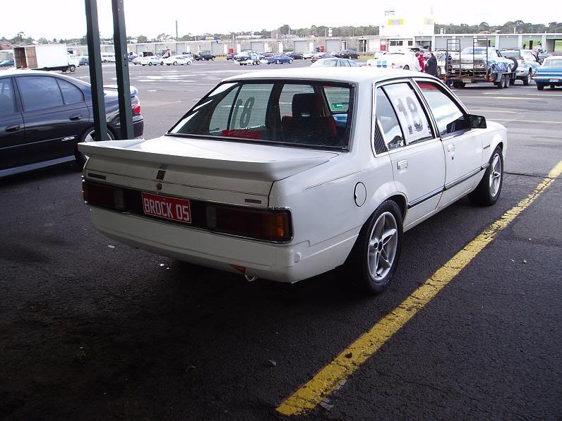

Grasshopper was there and did a couple of laps:
OF THE CARPARK!!!! :tease:
#196 Heath
Posted 13 August 2007 - 03:33 PM
