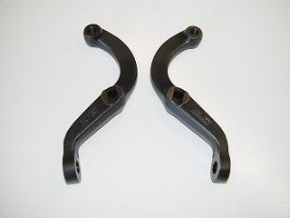

Steering arms
red one on right is standard LX, middle black one is UC, left one - black with white paint splotch is A9X. Note how much lower the A9X one sits.
Side on view of same - this time with A9X one on bottom. Note that the LX one is shorter than the other two.
Comparison of UC and A9X one mounted on the A9X stub axle. Pretty close - definitely better than using an LX one.

do harrops steering arms eliminate the need to grind the caliper mount ar just reduce the amount of grinding?

Arrimar and Rory - I haven't seen the Harrop arms in the flesh, but I'm worried that they don't seem to have the bump stop ends on the insides of the tie rod end holes that the oem ones do. This is the bit that is designed to contact the front of the lower wishbone, and safely limit the steering travel. This might mean that if you use teh Harrop arms, the steering can go further than it was designed to, and something might hit something that it's not supposed to - not a good scenario with a front suspension in action. If I was using them, I'd be checking steering limit clearances with wishbones, calipers, rack etc across the full range os suspension movement, and making sure that the steering travel is safely limited before things start to hit each other.

I think if the UC arms are that close to the A9x ones I will keep my $300 in my pocket..as you say..the UC have stops..and I am using the UC lowers as well. More than happy with my setup now thanks to you and M@.

This pic was supplied from Chris Simm of Harrop when i was inquiring.
