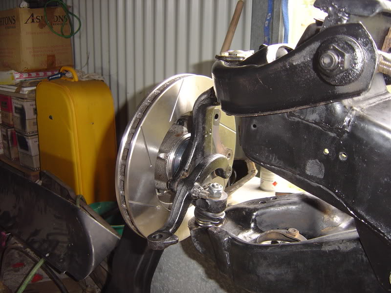

#122 _rorym_
Posted 12 February 2007 - 09:44 PM
A9X and HZ Chassis and cab are the same part number.
Groovy...hard to see but you can get an idea of the thickness of these suckers...heaps bigger than the HQ ones I say today, they are about 2/3 thickness of these. Mine have "OO" stamped on the back.They are goddamn thick muthas!
