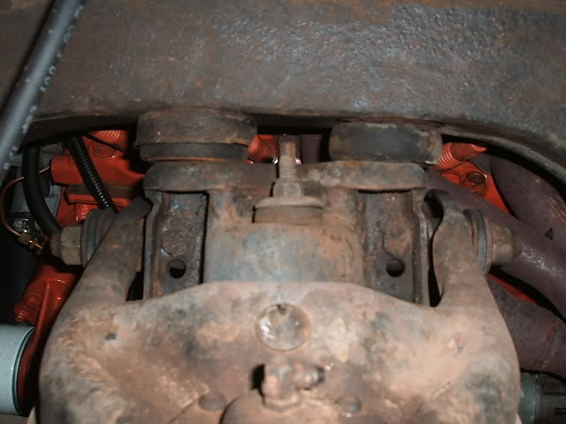

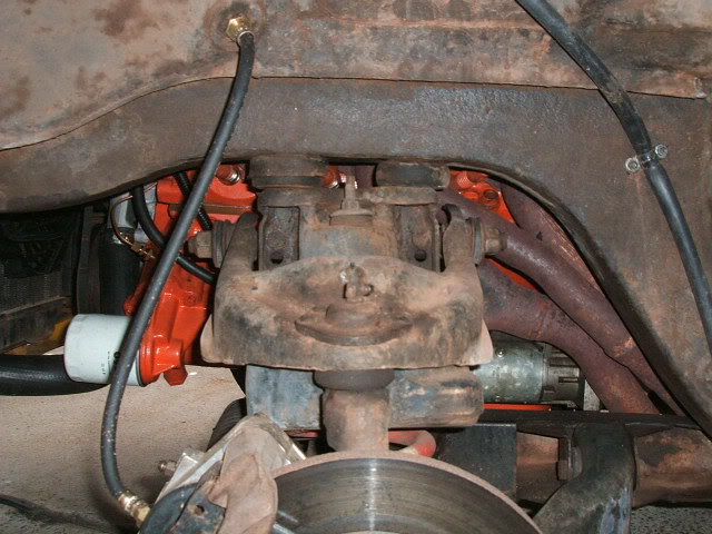

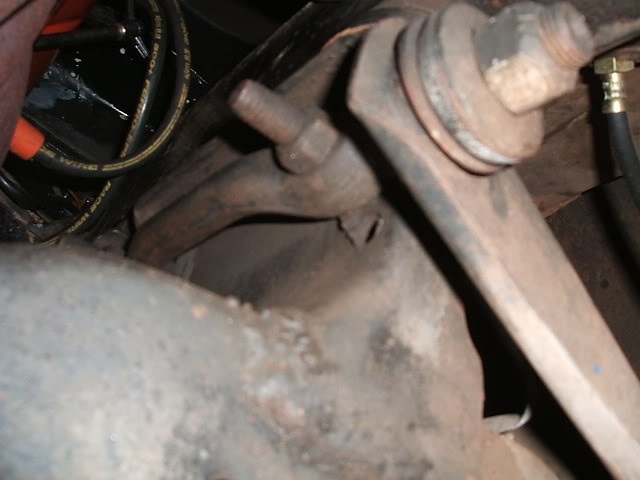

Posted 14 January 2007 - 08:52 PM
Can you post a side on picture of the crossmember with the wheel off? Also, does it have the offest balljoint upper wishbones? The right hand one will have an "R" stamped in the top of it, next to the balljoint.
Pictures as requested.
It does not have offest ball joint wishbones.
I do have some, i plan to install them this week.
Pic 1
Pic 2
Pic 3

2.  Yep all the Lower Control Arms have the same geometry.
I notice on the upper control arms of the UC there is a 'R' stamped into it, is this the driver or passenger side?
On the lower arms there are no stamps indicating right or left.
