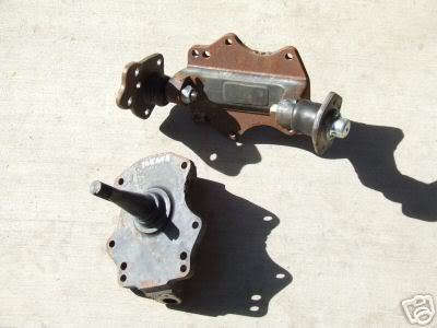

Some of the CRS stubs actually have 2 sets of holes for the steering arms - but you try to get some sense out of CRS as to which stubs have the extra set of holes
If you have the CRS stubs with 2 sets of holes for the steering arms, the ones to use would be the ones which position the tie rod end the same height above the lower balljoint as the original Torana stubs have as that is the critical distance, not the actualy height the axle is compared to the tie rod end.
M@

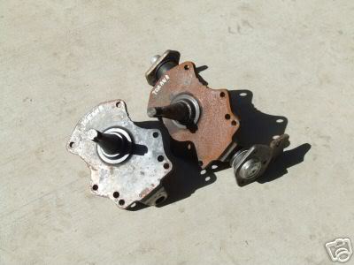

As you can see in the photos they have 2 sets of mounting points for the steering arms (as M@ has already pointed out). They also have front and rear mounting points for the calipers.
I would say the lower set would be for the Torana steering arms (LX and UC excluding A9X).
Now, from my limited knowledge (more a guess really!) I'd say the upper steering arm mounting points would be used if you were using these drop stub axles in a HQ/HZ setup (or an A9X with A9X/Harrop steering arms). As the standard HQ/HZ stub axle sits higher than that of the standard Torana stub axle (excluding A9X), using these 2" Torana drop stub axles in a HQ/HZ setup will effectively reduce them to only roughly a 1" drop.
Does that make sense? I'm probably not right, just speculating really!
