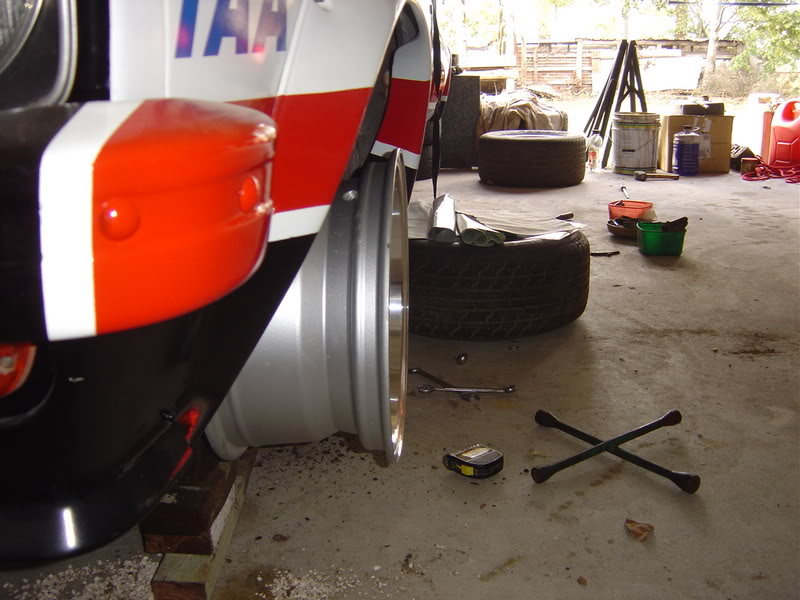

This is what I have done with mine, I know it looks like a ridiculous size spacer, but as you can see, it has been secured using the studs with a lock nut on each one, that way the studs are supported
Sams spacer
#132 _rorym_
Posted 13 August 2007 - 01:22 PM

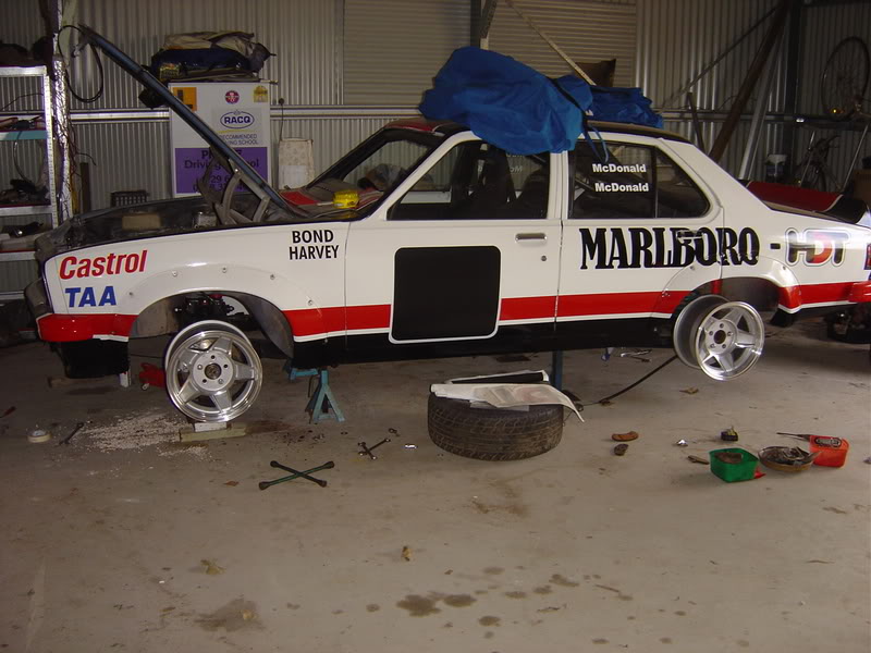

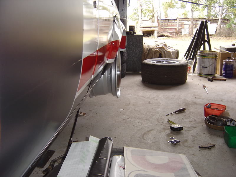

See here is the problem if you go Sams way..maximum out for the rim..nearly/probably touching the outer guard...these are 15 x 8...now add in 15 x 10..See my problem?..They are through the guards.
I just realised Sams spacer is about 2 inches...so pushes his front wheels out that far..if that is the case..15 x 10 should be close to being OK.
15 x 8 105mm backspace...95mm outer lip.
15 x 10 113mm bacspace....142mm outer lip.
These the 2 inches I need.

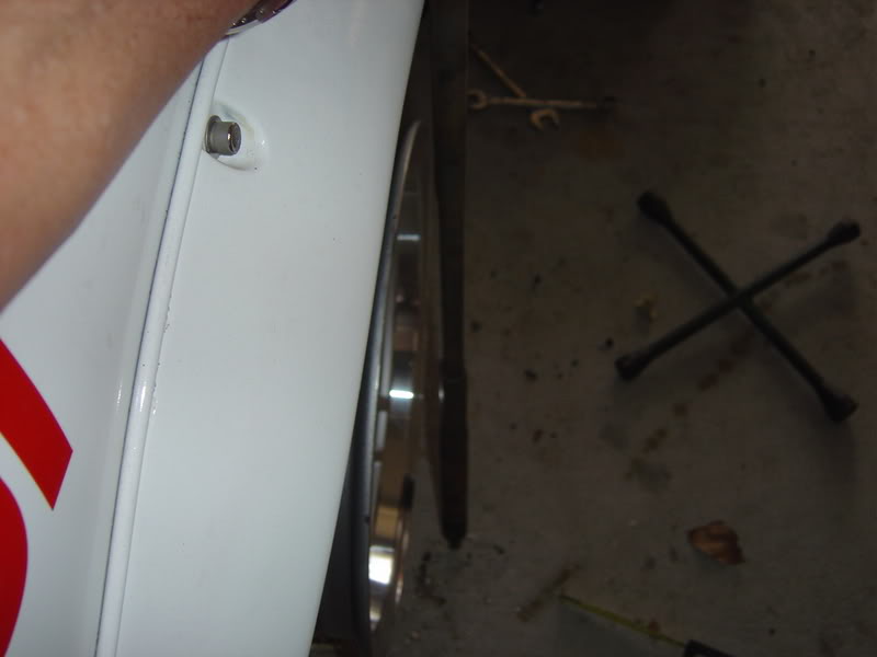

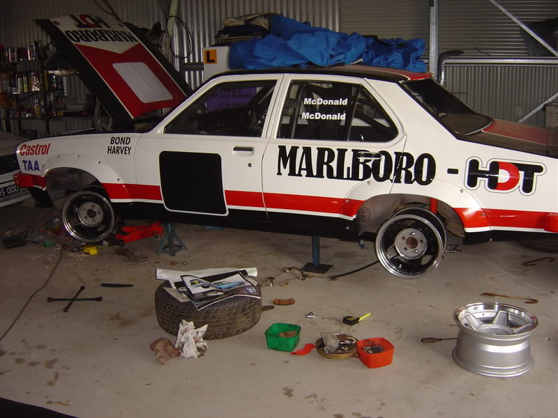

If you look at that Gough car up there ^^^ you will see they are struggling to get the 10s under the front...I think it is going to be a drama...will be nothing but a pain in the arse with rubbing..we will see...the fronts below will need 35mm added to the outside if they are 10s...thats level with the out side of the flares...The backs will just fit..
The rears below
Looks HORN!!

Yep...In the second pic I stood a straight edge against the outside of the flare...thats where the outer edge of a 10 will be on the front..I reckon we are 8 fronts ...uncut wets...and 10s on the rear with soft compound slicks. In fact on the Gough car...the fronts look a bit weird..like they are too big?..or is it just me?

My rear 8s have 2" clearance on the outer edge......fronts look the same ^so if you go the bigger fronts it will push the 10s out level with the outside of the flare...not a good look...See the Gough car back there..^^.
