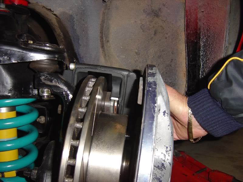

I will confirm
No they don't fit over our brakes
Close... but would need about a 5mm spacer or some machining of the wheel
And they don't fit Alex's Wilwoods either
Which are not the same as either of the 2 sets in this thread

We need an alloy hat that spaces it out or something similiar..Thats the B45s centre sitting hard up against the caliper and still 10mm or so short..
Suggestions Oh Great One? Interesting that the 14 x 8 Hotwires clear...dont make me go 15 x 10 hotwires..the wallet cant handle it.

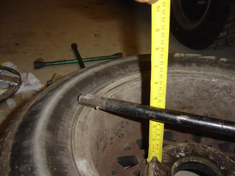

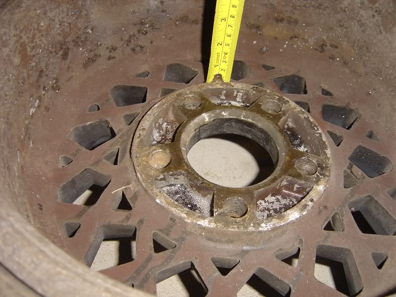

This is what I have done with mine, I know it looks like a ridiculous size spacer, but as you can see, it has been secured using the studs with a lock nut on each one, that way the studs are supported

Heres the answer...the hotwires have a built in 15mm spacer at the back...backspace is 4 1/2 inches on a 14 x 8.
