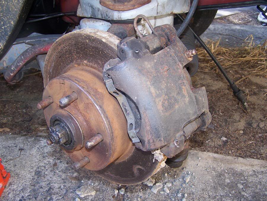

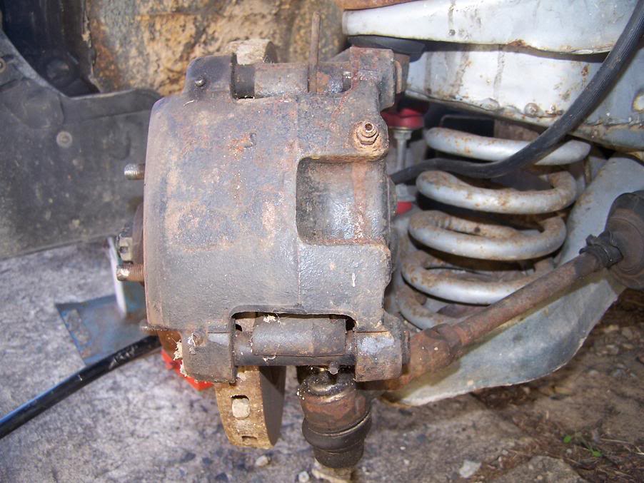

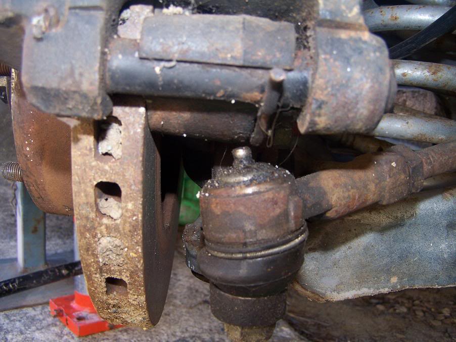

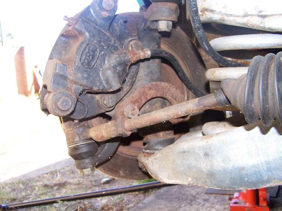

Rory heres the pics from that sedan Ive got here
Datto what brakes would these be?? Part number 9933233
#110 _rorym_
Posted 20 July 2007 - 02:34 PM
NO PBRs at the wreckers only Girlings..any problem with them?

#112 _MRNOS_
_MRNOS_
Posted 20 July 2007 - 03:45 PM
Rory the girlocks are bigger from memory and will need to be modified, PBR's are the go, 2 sets on ebay look under holden brakes, $15 and $25 starting bid

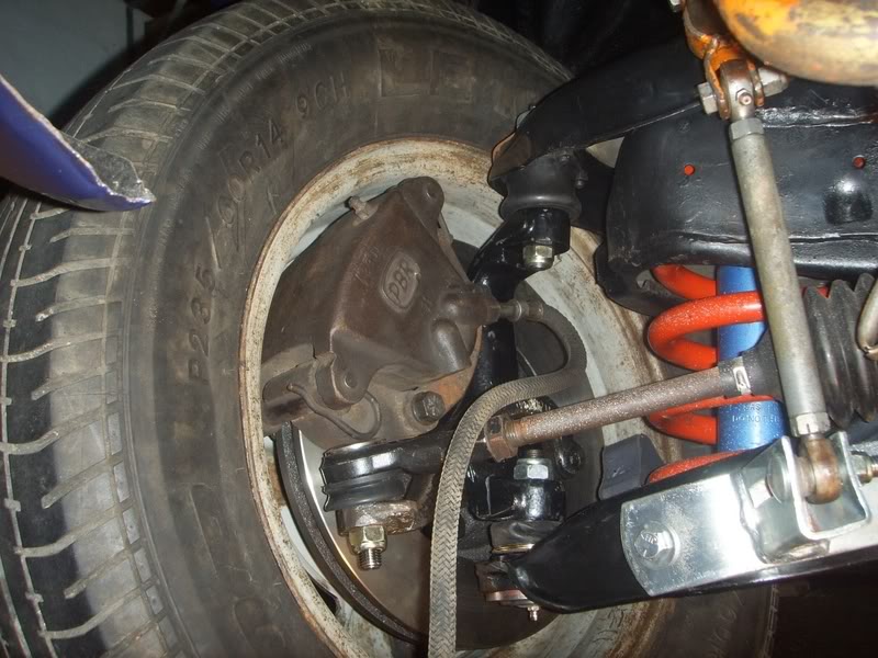

Like Arrimars..Mine sit on the steering knuckle...I reckon the Harrop arms would give them more clearence.
Arrimars HQ Front end.
