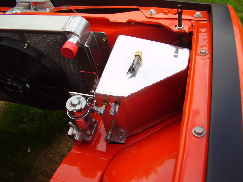

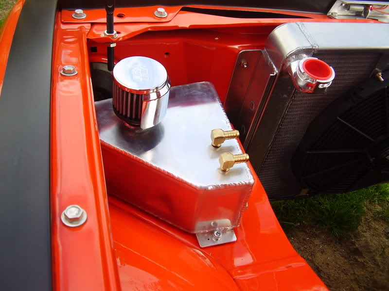

Sunday afternoon update.
Dummy fitted the oil catch can, radiator and fuel surge tank. They can come out when the engine gets here and will only take a few minutes to reinstall.
Pedal box is in, seat rails are finished,
Waiting on a crown wheel & pinion,
Waiting
Waiting
#265 TerrA LX
Posted 22 July 2007 - 08:17 PM
Loke the bonnet cable.
Fuel system in the bay is interesting.
Nice work, as always.

Posted 22 July 2007 - 09:18 PM
Very nice, who did you get to do the fab work on the tanks?
Something I've found, when you have an ally radiator with the straps welded to the tanks, make sure you insulate between the straps and rad support, otherwise vibration will cause cracks along the welds.

i always thought the fuel surge tank was fitted in the boot, interesting

Looking good Welby, looks like I am not the only person who is going to run a surge tank in the engine bay

KRL did the Alloy,Tanks, based in Maddington. I'll let you know my thoughts when they are plumbed in. :huh:
Floor mounted pedal box is in, however the pedals are not connected as yet. :rolleyes:
We have angle mounted the box to a floor plate and secure that to the floor. It was made to be removable for alterations / maintenance

Posted 23 July 2007 - 02:34 PM
I am not so sure about mounting the swirl pot right in the nose considering this area might sustain serious damage in a crash and obviously you have considered crash damage because of the roll cage.
I would think getting a swirl pot made to fit inside the fuel tank would be a better option and the vent line for internal swirl pot can be direct into fuel tank and pumps could fit up the back under the floor.I think it could be a much tidier option.
I know ATL make fuel cells with internal swirl pots and thats probably the way i would go for a competition car.
Nice hatch and keep up the good work and i think we all really appreciate the photos.

Havn't seen quality fabrication work in an engine bay like that since the ex Beasley/Lawson XU-1 here in Adelaide!!
Welby, you and your team ought to be commended for turning out such a great looking car :spoton:
