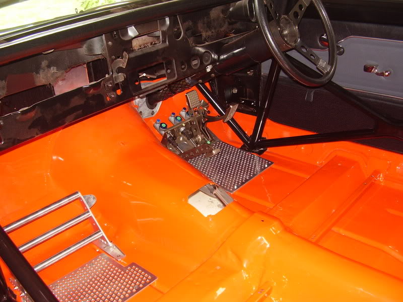

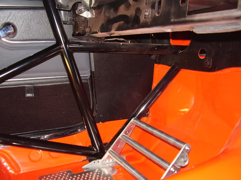

As promised, the pedal box
Mounted on a floorplate for strength, and angled for maximum distance from my seat.

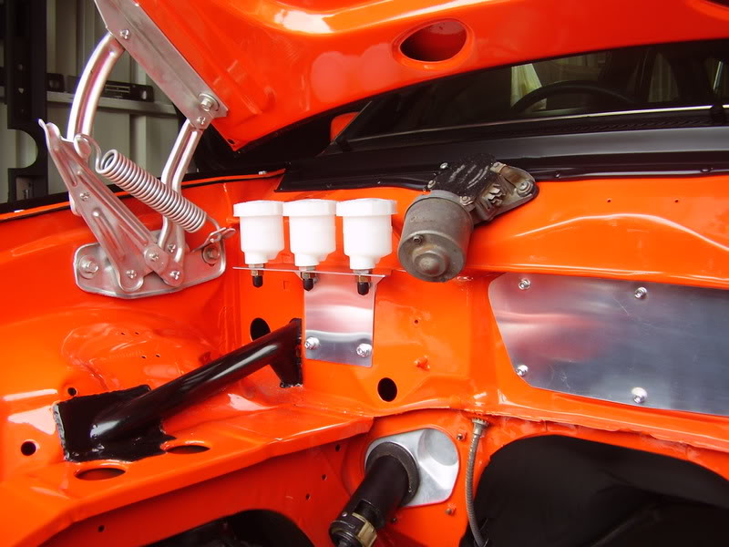

Reservoirs

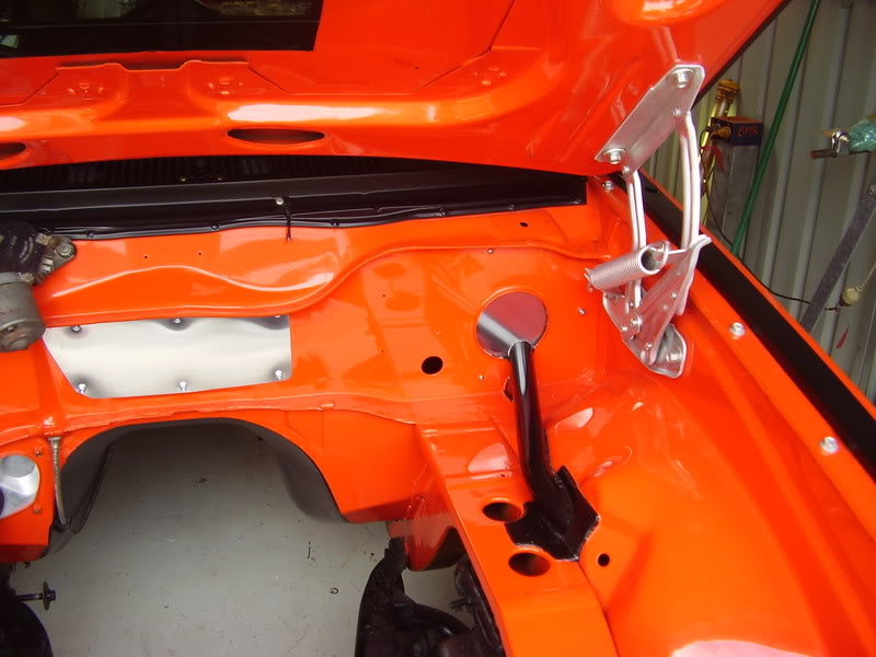

Firewall

You will notice the windscreen wiper motor is 'as is' complete with 30 years of tarnish.
I have left this in it's original state because, as Rory keeps reminding me, this is only a race car.
Last job of the day was to install the drop tank.
Every one loves a fatarse Torana.

I didnt think a pedel box could look so sexy, very nice mate, the whole car is very nice.Thank you for sharing, im hoping to do a similar setup to my LJ but use either Tilton or Wilwood, i like the look of the wilwood.
Are the master cylinders pull type?

Push type Bart
Datto for details.
Welby

Push type Bart
Datto for details.
Welby
By the way the push rods look on the master cylinders it looks pull, are they not connected to the pedals or something? Must be the way im looking at it.
Edited by Bart, 30 July 2007 - 12:59 PM.
#300 dattoman
Posted 30 July 2007 - 03:22 PM
They are not yet connected to the pedals
Somehow I have to make them work yet
Ask me again this time next week if it was such a good idea or not
