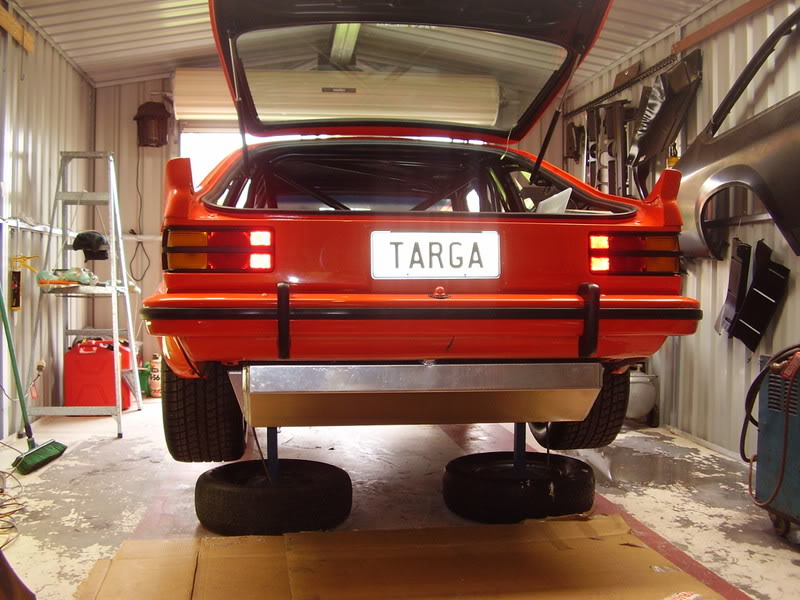

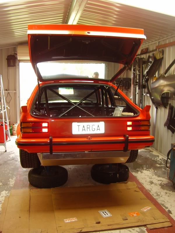

Anyway, I was wondering, and not meaning to sound like a dumb arse, what is the purpose of the winged bits on the side of the drop tank?

Winged bits on the side of the droptank are mounting gussets ,to mount the tank and hold the weight of all that fuel ,Davis Brown tank or something I think , Do they still run the internal blader like they did on the group c's? :D

I think around 1thou mark depending how larger and what mods you want when you order it ( eg rear centre lower fuel pod pickup ) but they dont leave good clearance for road going exhaust on the sides where the gussets are...

I thought they were filled with a big foam block or multiple foam blocks not a bladder. The foam was of a type that took bugger all of the over all volume.

They are these days with foam, Marcela foam I heard its been called I think .
I rang Davis Brown a couple of years ago about an exact group C tank , they stated that they the cam Group C rules of then required the tanks to have a bladder....but they could make what I wanted...
I can only say what I have been told ,can any one back this up???

the ones you buy from brown davis, are baffles and do not contain foam or bladder's, i spoke to the yesterday....

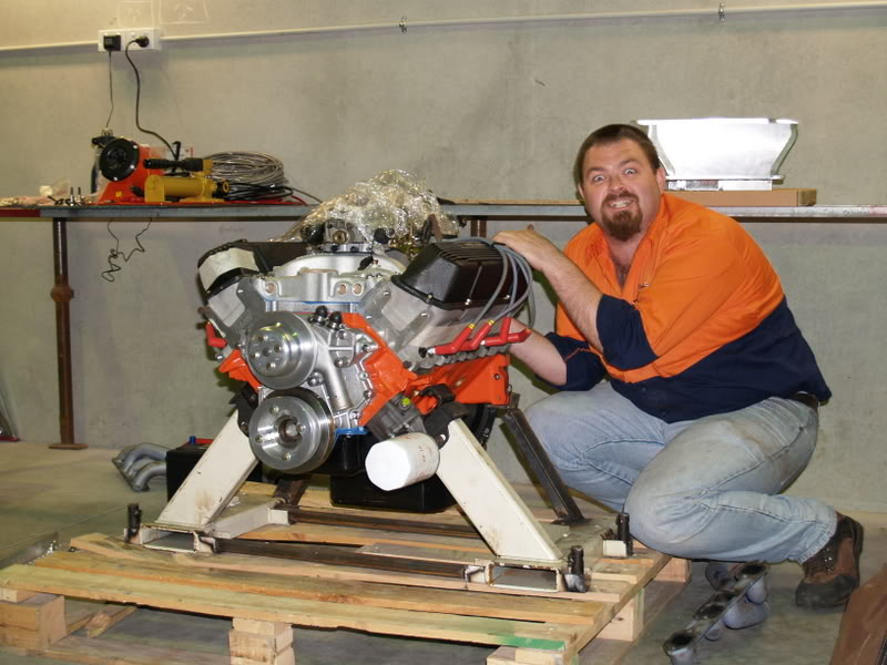

Happy to announce we now have the following
Tate 331 cube 435HP inplace on rebuilt crossmember
Crossmember in car
Tremec TKO600 box installed in car
Full floating 10 bolt diff installed in car
Kmac front and rear adjustable bars installed
All suspension installed
Almost all brakes plumbed and ready for fluid
Clutch hydraulics plumbed
Need to still fit a few hundred little items to make it actually go but were on track
Its a rolling (pending wheels) racecar now with most mechanicals
Welby has a couple of hundred pics to sort thru then he will pop some up
She's looking very sexy and on track for Aug 16 unveiling at the racetrack
Only another 10 days to go to get it driving (fast)

A friend who has since passed worked on many a car in those days and did a lot of alloy fab./roll cage work. He told me a few years ago the 77 patterson bathurst hatch fuel tank had a dummy made up and a latex bladder installed along with miracell at a factory near moorabbin airport. The tanks ran this way so there'd be no leakage if the tanks or welds fractured due to fatigue or damage. As for the special foam - apparently it's more absorbent than spongebob. Only loses %2-3 volume and practically eliminates fuel slosh.

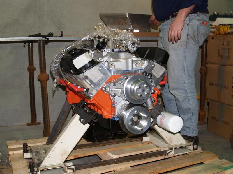

It's me that needs to thank every one, especially Datto.
Without his facilities and hoist, we would never have gotten this far.
A really big weekend put in by all, and we even managed to have a good time doing it.

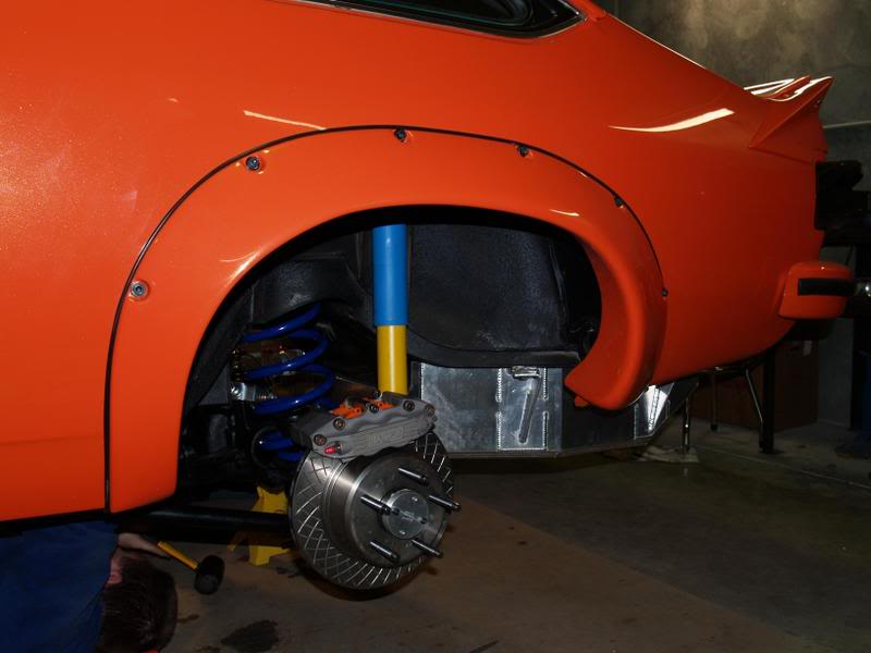

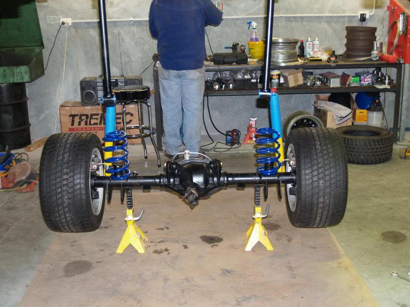

I've left photo's out that identify the lads, for their own privacy, but here is BJ and Friday nights engine unveiling from the crate.
Dan & Dave put in a lot of time getting the crossmember and diff assy ready for installation

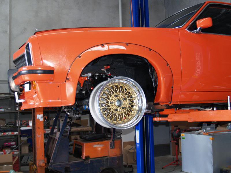

Hotwires are the ducks guts.
But being as we can't get 15 x 8 fronts, we'll settle for V5 Simmons.
