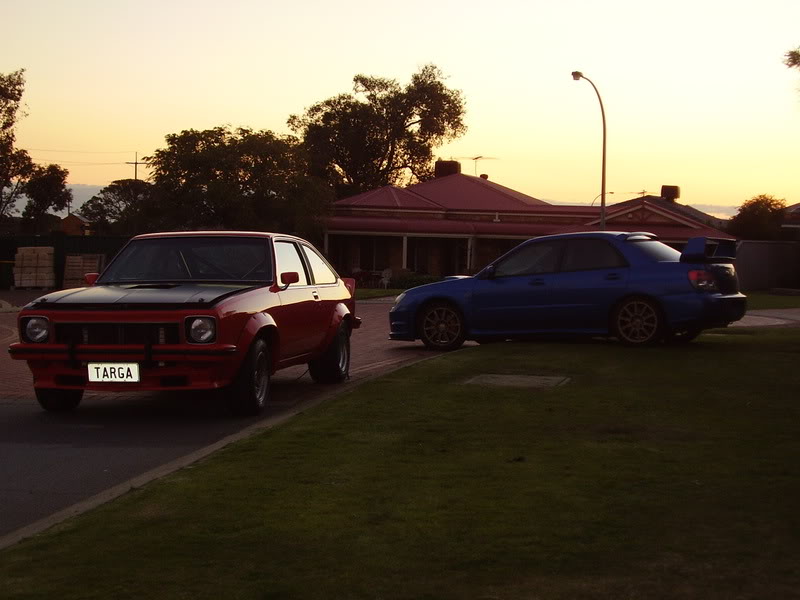

Posted 10 August 2007 - 12:29 PM
We don't have any cold air induction,
Yet.
Nice photo of my STi
Awaiting the tow truck
Awaiting the exhaust dude to open up.

Posted 10 August 2007 - 09:39 PM
eeeeewwwww
welby has an S.T.I you should go see a doctor about that you might just need a shot or some cream
