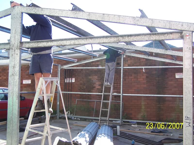

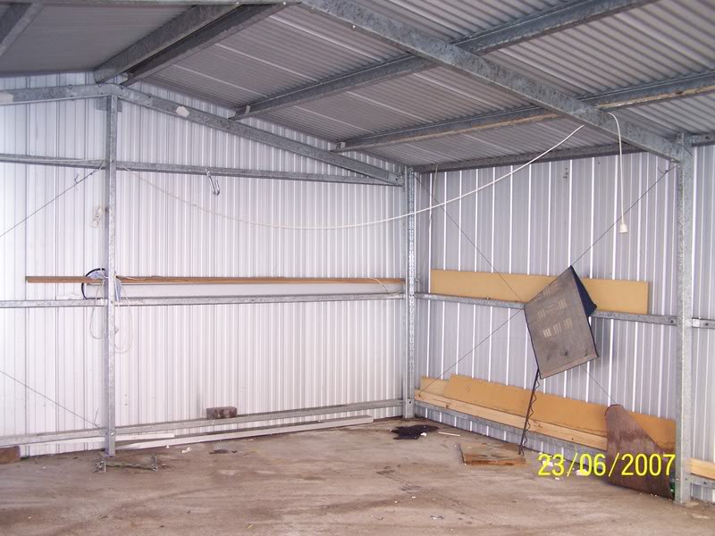

Thats a good idea, l had thought about using black plastic but this sounds as though it would work better, if its cut evenly to the right thickness and not as stiff it should mould well to the iron profile. This combined with the Black Tar ALX76 suggests would ensure no problems.I heard the same thing about the iron rusting away after some time. May take years but I didn't want to risk it so I ran some of that damp course plastic strip that is used under brick walls all the way around the bottom. About 300 wide so it was more than enough to cover the 100mm thick slab. It work rather well, it sat in place by pushing it onto the ends of the tek screws that were poking through the lower girt.

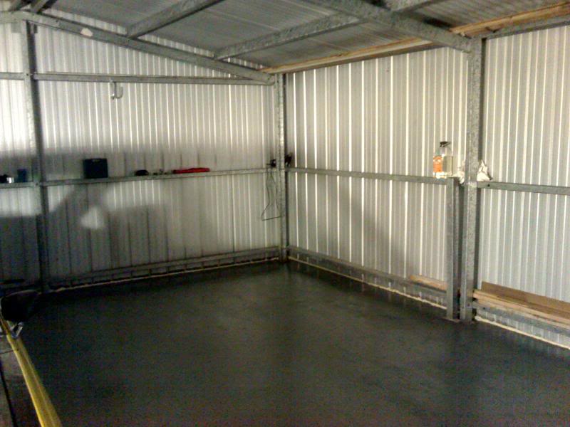

#35
Posted 05 July 2007 - 11:45 PM
before we pulled it down
pulling it down
and re-assembled slab painted ready to go, just needs some power
