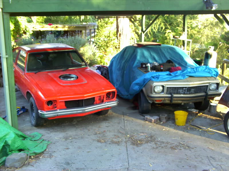

not much in my shed except a couple of old cars

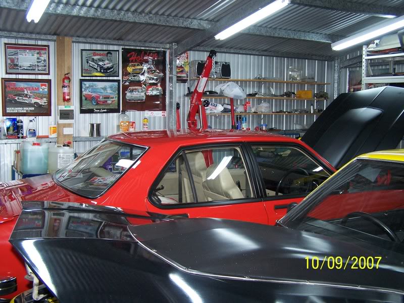

It's a little more cluttered now, but I like it. Once it's fully sorted it will be very workable and the red thing will be out of the way so I can get into the yellow one.

Never seen one on a car that wasn't worth half a house :rolleyes:
Like your shed - I've got that Holden race car poster on the right too - it's on the wall in my shed.
Looks like you won't be the only one 'getting into the yellow one' - it's home again for a while. Just finished an audit on my parts and spares.

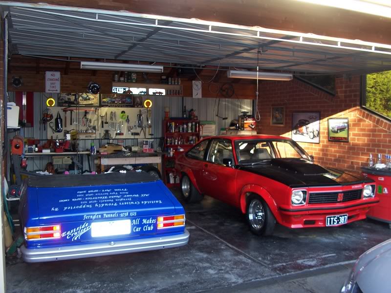

Thanks for the detail Dangerous.
I started on Thursday and was finished by Sunday afternoon. I didnt get a chance to see your post prior to commencing the job. I did pretty much as you have stated. I did not have much luck with the rolloer I initially tried and quickly ran down to Bunnings and purchased 4 foam rollors. They left a much nicer finish. the only hassle is that the glue they use to adhere the foam to the rolloer gives and I needed to replace with a new roller. I did two coats (24 hrs apart) and needed 2 rolloers per coat. I found it very easy to apply and it covered many hairline cracks and pinholes in the concrete.
In the end I had about half a litre left over for each coat. So far I am very pleased with the result.
Thanks again, Max
Finished

Nice looking garage - is that a really early 'show and shine' poster on the right hand wall? Looks like a Ralfus design.

You have a keen eye Dangerous. Right you are. Circa early 80's, Victorian 2nd S & S with a blown HR charicature.
Enjoy
Vic 2nd Show & shine
