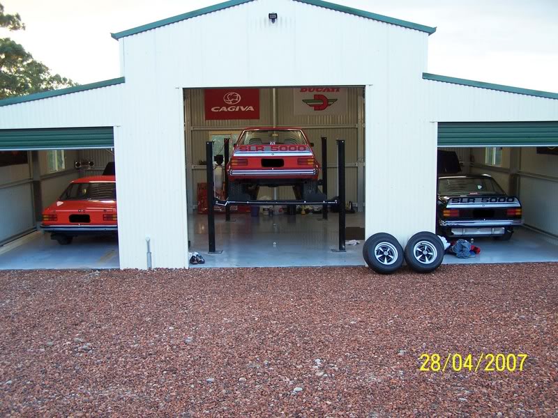

It was a fair bit of (weekend) work, but I'm very pleased with the results. The garage was bought in kit form, and although the parts were reasonably correct, the instructions were abysmal.How difficult was it to put it up yourself? Im going the 6x9m too but with the opening on the 6m side.
Luckily I had access to a theodolite and a few mates. We started with the back wall, assembling it 'horizontally' ie laid out on a flat surface. The theodolite was used to check that points along the back wall frame were all at the same height/level as we built it, and screwed the cladding panels on. Then we stood it up and aligned the heights of the end and centre posts, and because the rear wall was dead square to start with, once we got the heights of the three main beams set at the right levels, this became our datum, and we built the rest of the frame around it. once all the vertical beams of the garage were in place, we used the theodolite again to check their heights (side to side, and front to back) were correct by packing underneath with bricks and parts of bricks cut to the right thicknesses, and we concreted in all the beams. From there, because the frame was square, all of the wall cladding and roof went straight on. We ended up with 5mm tolerance over the 6 metre span, and 10mm tolerance over the 9 metre span. We built the garage dead level, and then sloped the gutters by 20mm over the 9 metre spans, and that is plenty for the rain that we are likely to get.

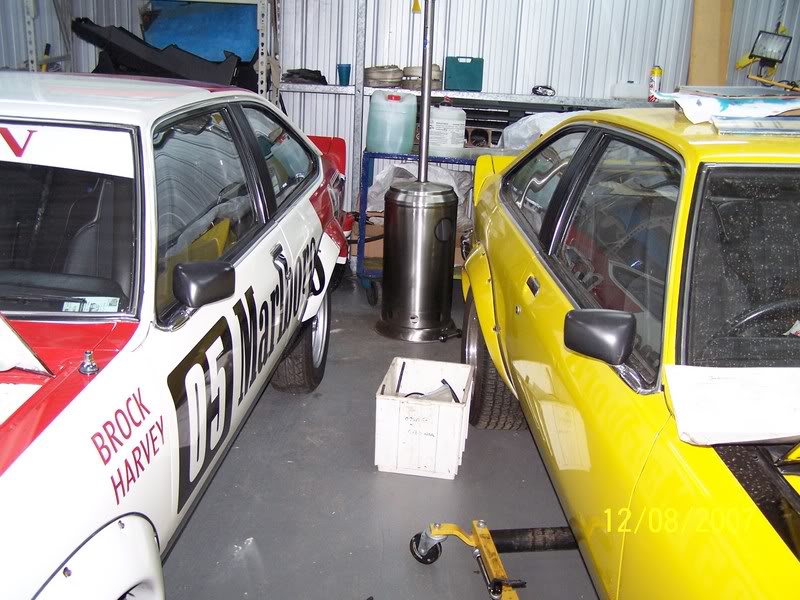

A privelidged moment then.you wish, everyone knows reds better and it's not mine

Re, it looks a bit deceiving in the photos, but it's 500 mm under ground level outside the shed, and 300 under the concrete slab, as per requirements. It also has the warning tape laid above it and all the other stuff.Dangerous. how far down does your conduit go, Mine had to go down 600mm by the law, yours looks half that
Yellow thing huh - what have you been collecting???

Ah, so you finally get to work on a real one - one with the right amount of doorsThe yellow thing is a certain members A9X hatch I am doing a little work on.

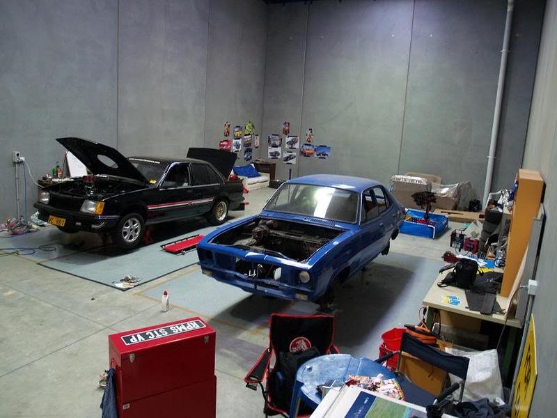

RpM, is your 'shed' basically just a small warehouse space? Or self-storage, something like that?
