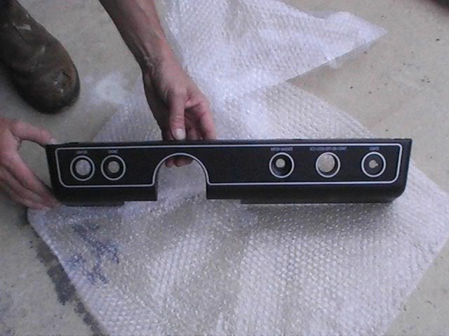

Such A nice car mate, how did you get your lower dash panel to look so good?
#79 _CraigA_
_CraigA_
Posted 25 April 2009 - 08:20 PM
Mine looks like that too - Dash Original in S.A do an awesome job.

tyre fryer - dash original did the resto work on the control panel
I sent a blue one down to be re-stencil...in all honesty it looks like I bought a brand new gmh one off the shelf .
