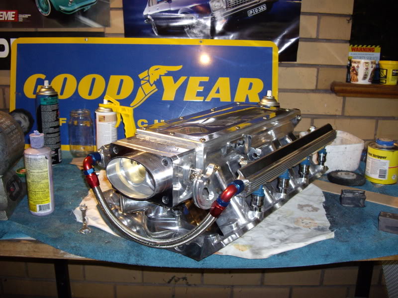

Posted 26 July 2008 - 12:42 AM
Heres another addition to the manifold,I Thought id share I got bored so i recond my injectors at work, and polished the bodies, used some of the metal coat clear gaurd, Come up a treat.

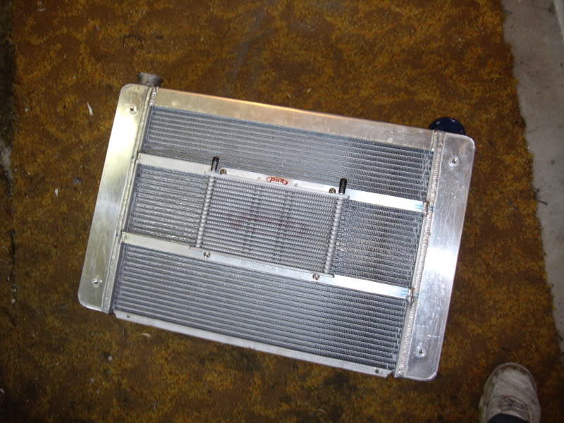

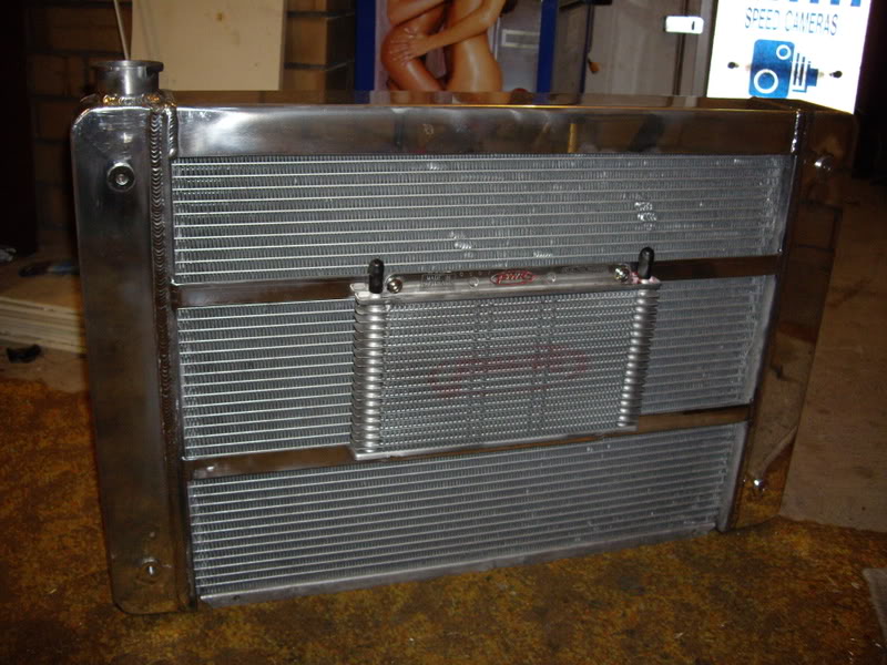

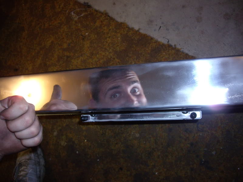

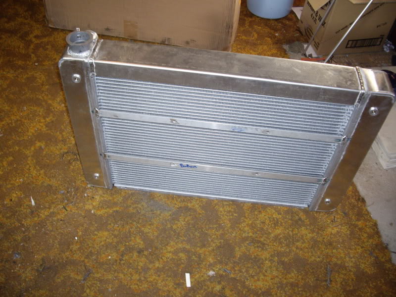

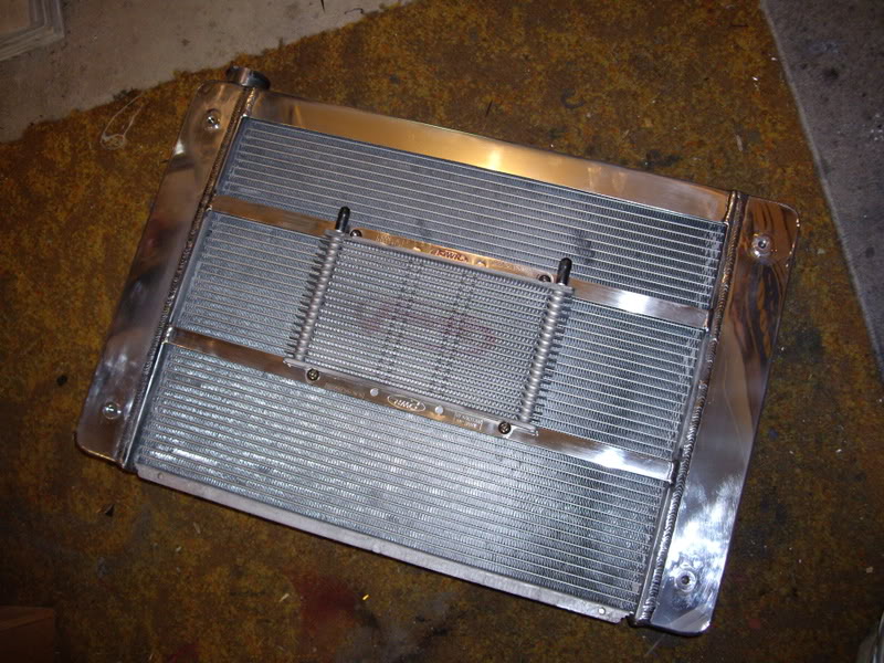

Its been a while ive slacked off a bit, figured i needed to save some cash to buy more stuff to polish,
Heres my latest piece, I Bought an alloy radiator for the hatch, A mate of mine tig welded 2 supports across the tanks to hold the trans cooler, i thought would look much nicer than stuffing plastic ties through the cores.
All up this took me about 10hours, Due to the fact that i havnt done much plate alloy polishing i #@$^%& up by rubbing back the surfaces 1200 grit,
hence why it took so long, I Found out later why i had such a bullshit finish, a local metal polishing mob told me NEVER EVER Rub sheet alloy to polish, it does not need it, not even the sisal cut wheel, just buff wheel with white compound and some pressure. cast is fine to grind sand and cut.
So i spent the next day fixing my f*ckups a long time on the cutting wheel to get the scratches out.
Im pretty happy with the results even though i done it the hard way.
And i think its time to find me a new grinder, might step the 6" benchy it up to a 10" the more pressure the better the finish
Heres in roar sheet
This is once id finished
Alloy dont crack like a mirror with an ugly face

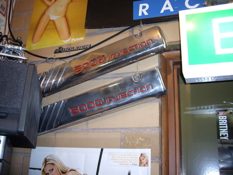

And a new home for the VN injector covers that i cant sell on ebay for even 20bux BUY IT NOW
Marc
