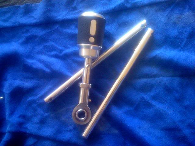

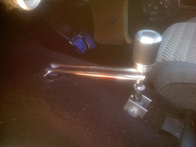

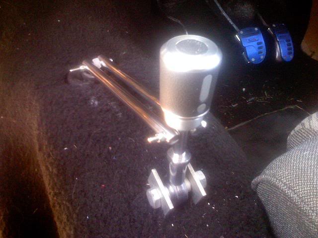

Hehe Ok I started off with something extremely Easy, But im very pleased with the results :D
My Custom remote shifter for the Gem... Heres the finished product:
And A couple Of before and after shots:
My new alloy intake manifold for the gem should Arrive this week.. Ill give that a shot :D

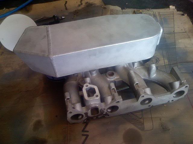

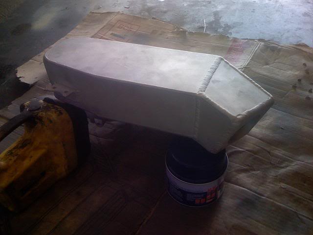

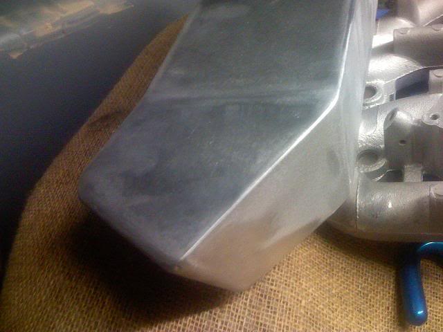

New intake manifold arrived today :D
I know its not a perfect intake manifold as it has square internal edges which isnt the best performance wise... But lets face it this isnt a top level drag car and the tiny ammount of Horsepower id lose wont be noticed... and Well I got it at a good price :D
But made a start on polishing it today, most of it is pretty flat so should be pretty quick and easy to do, bar the bottom half eep dreading that bit...
Before:
After 1/2 n Hour:
I only had sandpaper and some meguirs metal polish So could only get that hazzy sorta shine out of it...
there is about 3-4 spots on the top that are like chips (casting flaws?) and are about 1/2mm-1mm deep... Am I best to just ignore them? Or should I keep sanding and sanding and sanding till there gone?
I went 240 then 340 on the orbital sander, then 600, 800 dry with just a rubbing block then 1200wet then polish....
What do you guys recommend I do to get a mirror finish? Just get some of those Jasco blocks from bunnings and use the brown then white, then some Purple polish? or do some more sanding first?
Cheers :D
#111 _j7723_
_j7723_
Posted 03 April 2008 - 01:21 PM
Ithere is about 3-4 spots on the top that are like chips (casting flaws?) and are about 1/2mm-1mm deep... Am I best to just ignore them? Or should I keep sanding and sanding and sanding till there gone?
Cheers :D
Viper If I were doing that one I would go to the white with a soft wheel then purple
Top job so far
#112 _Viper_
_Viper_
Posted 03 April 2008 - 09:22 PM
Hey guys, I donno if you guys wanna see the progress I make every time I work on it?? if yas dont jus lemme know and ill wait till ive actually finished :)
BUT, spent another hour on it tonight, just working on the huge welds this time and got them down level, which has left with with a couple of questions... Pics first :D
Before:
After:

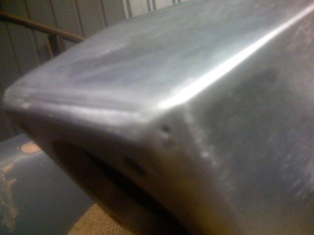

Ok questions time... anyone got any tips with working on rounded surfaces? and keeping it all even and nicely uh rounded? :D I found when I was using the little 2" die grinder I had to be really carefull otherwise Id make low points and the rounded edges would be all bumpy, Wasnt so bad when I used the 6" Orbital sander but yea, any tips would be great :D
Also found a couple of spots like this:
Not the best pic but you can see its a fairly deep hole in the weld. Now I could possible sand it down but would need to remove alot of material... Would it be best to find someone who can weld alloy to just weld the hole up and I grind it back down flat?
Cheers fellas :)
1.5 Hours work so far...
#113 _greenmachine215_
_greenmachine215_
Posted 03 April 2008 - 10:16 PM
Viper, Its comin along very well,
Tip: Get yourself one of them rubber sanding blocks from bunnings, put your paper in that and do your edges, this way you are sanding in an even pattern. where as by hand or rotary tool you tend to apply different pressure giving that ripple effect if you block sand the whole object i garuntee you will have an excellent ripple free finish.
I Know that imperfections and pours are a bitch, but look at it from a distance and you cant tell, if it was me id just put a touch of bog or something and cover the dot with a silver touch up pen, depends how hard you wanna go i guess,
Like how you smoothed out the tig welds One piece effect is awesome, cant wait to see it done and on the car
Are you doing the rest of the manifold runners?
:spoton:

Yea its just that that dot is right at the very front and very visable and probly stand out like dogs balls :/ So I cant get someone to weld the hole up?

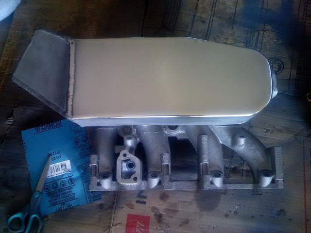

#116 _Viper_
_Viper_
Posted 03 April 2008 - 11:50 PM
Hehe Ill think about it, how bout the welding up the hole question?
#117 _Viper_
_Viper_

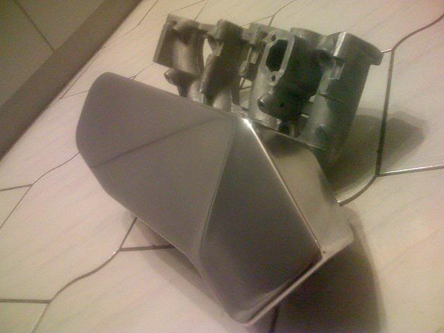

Posted 06 April 2008 - 09:11 PM
Spent some more time on it today, about 7-8 hours so far! Still not sure if im going to do the runners, they do get coverd by the thermostat housing, radiator hose, injectors, fuel rail... and is alot of effort to only cover it up :(
But here's where its at now anyway :) Still needa go get some purple polish...
When your doin the very final polish ie with purple polish etc... whats the best thing to rub the purple in with? and is it best to rub it in by hand and push as hard and fast as u can.... or as slow and soft.. or fast and soft?
Then whats the best thing to give the final rub down? and yea hard n fast etc...
#118 _greenmachine215_
_greenmachine215_
Posted 06 April 2008 - 09:27 PM
Viper, Mate top work so far :spoton:
I always use flannelette bed sheets (the ones for winter) They are very soft and semi fluffy, no grain in the material,
Always work in a circular, figure 8 pattern be it sanding or polishing, This way you get an even finish and when the light angle hits there arent any Directional lines, With sanding you also get even finish No high/low spots.
thats the ways i do it, But if anyone else has tips that work lets hear it.
marc :spoton:

#121 _Viper_
_Viper_

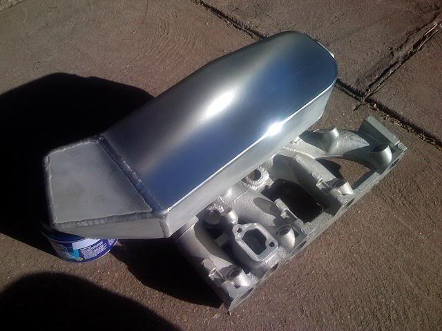

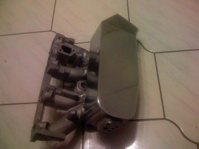

Posted 06 April 2008 - 11:52 PM
its still not 100% mirror shiny, well it you put something up close it is, but say I look into it from about half a meter away its a lil hazy...
I jus used some autosol I had, will the purple polish fix this? or should I attack it more with the white compound? or is that the best u can expect...
oh yea and the welds all came up hell shiny, like 100% mirror finish, is this jus cos different alloys shine more or wha?
#122 _Herne_
Posted 07 April 2008 - 07:24 AM
I would suggest using a very soft buff and more white, the purple is very good but wont removing the haze you have. Once you have finished with the white then use the Purple for a final hand polish. Do not use the Autosol after this process or you will scratch the mirror finish.

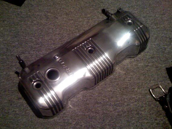

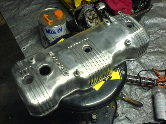

#125 _Viper_
_Viper_
Posted 18 April 2008 - 12:05 AM
Had a go at my rocker cover :) I actually first had a go at this awhile ago, But thought Id give it another shot since Ive learnt abit more and its turned out quite good :)
Here how it was originally:
Bout half way:
And as it is atm:
I tried to use just the white compound on the soft wheel straight away, but didnt come up with a mirror shine and can see very very slight scratches.... gonna have another go with grey and rougher buff, then the white again... Aiming for the full on mirror finish :D
Thanks for the tips guys, im getting there..
