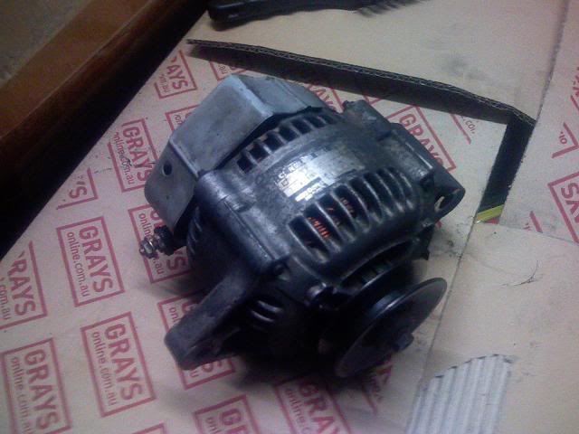

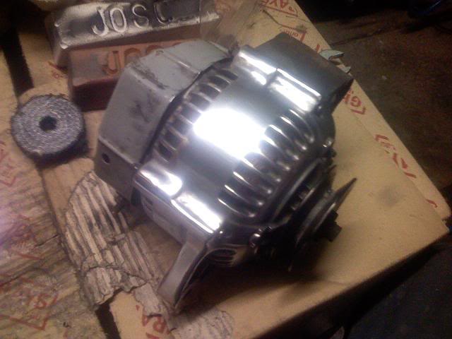

I also did my Alternator today, But all I used was the dremel with the lil colord discs, brown first then red then Blue... Then some Brown jasco then white then purple polish... Didnt use sandpaper at all unlike how I had been previously and was alot faster... But I can see it would be very easy to make low spots and rippes as its only a 1.5" disc...
Just trying different things..

Viper, one thing.
You mentioned you were gonna hit your rocker cover with the grey compound. This is good for removing big scratches but also leaves some sizeable ones of its own. Going from this to the white is a no no.
You also need the brown compound, which is about half way between. Perhaps even your rocker cover would go ok with brown then white, no grey.

Yea bomber I actually realized this lastnight when I was doing the alternator, I thought it went Brown, Grey, White, Then I re-read the description and relized I mixed it up haha, which is why I got an awesome finish on the intake (when I did it the right way) and not so good on the rocker :) but yea Mental note taken! :D

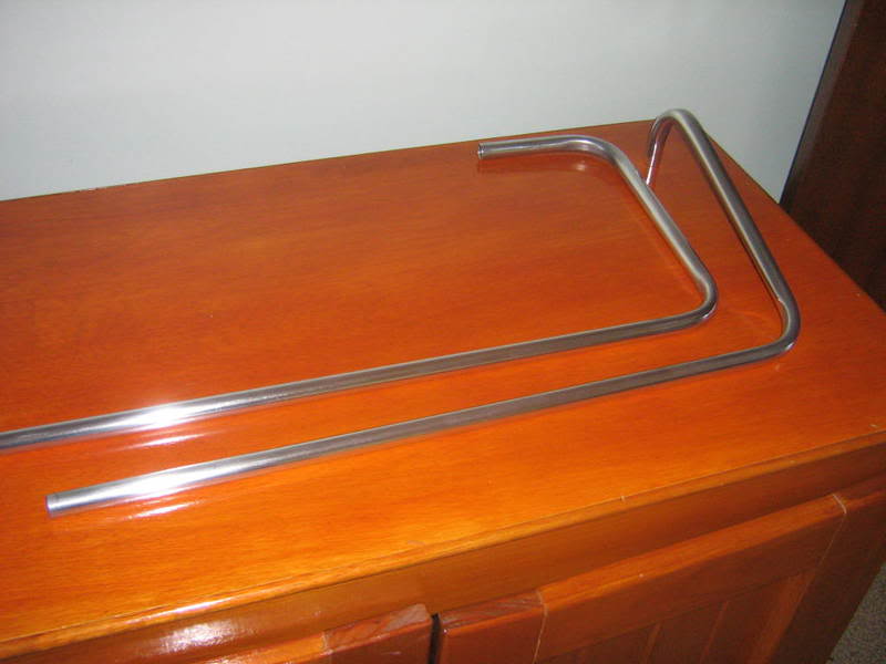

These will be my heater hoses soon.
and after bending and a quick polishing:
More polishing to do then to see how they look fitted.

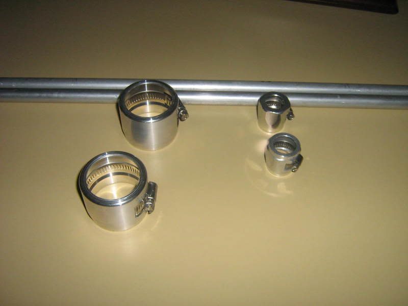

Nice thread on polishing something I have been doing for many years as a sideline. I have bought most of the buffs etc from the US through EBay but these there is one company i recommend Jestco Products www.jestcoproducts.com there service and products are top notch. Also there is a porting kit available on EBay US that i bought that makes getting into the hard to get places much easier www.standardabrasives.com. I polished all the aluminium on my LJ myself as well as all the aluminium covers etc i made. The latest is the fuel lines cover as shown below.
I have started polshing my Transmission housing also so will post some picks on that soon.

Hi Dags350, what an amazing job, I bet that catches the judges/peoples eye.
No expense spared either on fittings I see.
Excellent work.

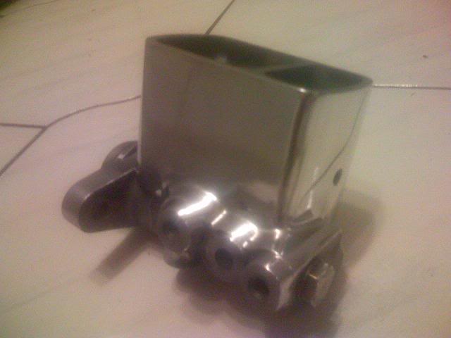

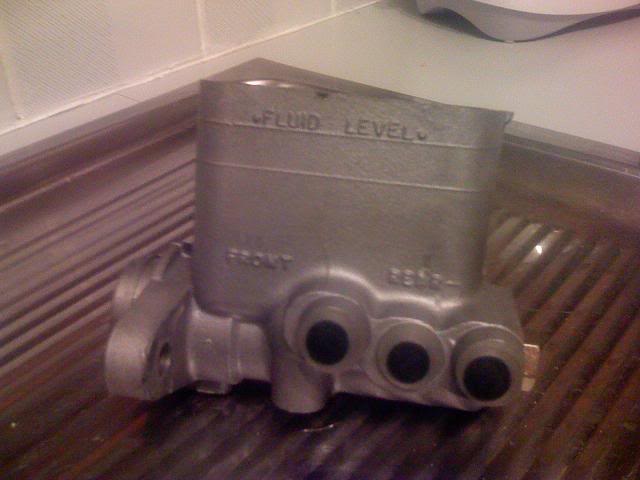

Donno if anyones interested but he's a couple more pics of things Ive polished, Starting to get the hang of it and be more efficient :)
Master Cylinder:
