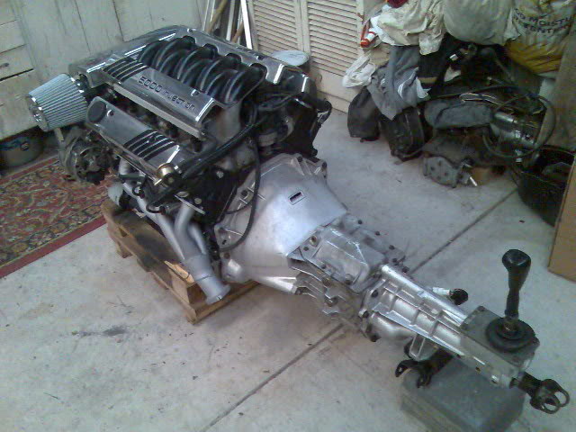

Alright guys its been a few weeks since ive updated but really not alot has happen! it was my 18th last week so went out all weekend as u do when u turn 18 so didnt do much!

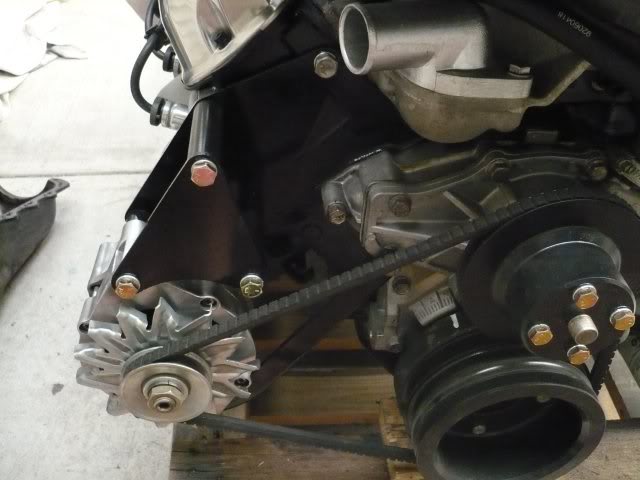

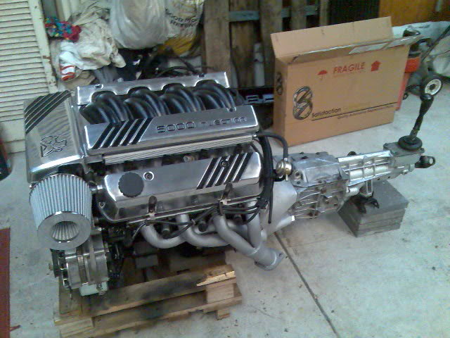

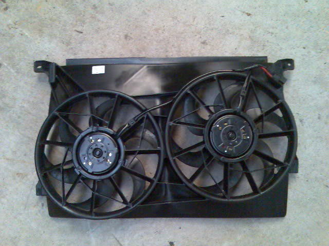

A few parts arrived in the post including the twin thermo fans and low mount alternator bracket.. i'll show some pics in a bit! the week before we also connected the gearbox to the engine to make sure everything fits sweet! and it did lol dads bought me a 3 core radiator but hasn't gone to get it yet and the wiring loom is yet to return from castlemain! :(
Tell me this is all the right stuff?
brand new twin thermo fans a bit of alteration and they should fit?
a few pictures of the motor all together!
a few things i need to sort out is the tail shaft, with dads help i worked out its going to be about 100mm to long! so what would be the best a new tail shaft or get that one cut and balanced??

Hi, i've done the same engine conversion in my lx sedan, with the th700 auto gearbox.
What is the diameter of your tailshaft?
I went to a local engineering workshop and found out that the best bet was to get a new one made from scratch. The pipe they used was 3" 1/4' and all i had to do was source the flange/yoke that bolts up to the b/w diff i have.
All up it cost me around $400 dollars.
If your tailshaft is out of a v8 torana it may be ok just to get it cut and balanced, i think they're stronger than the six cylinder ones??
Rhys.

yeah its currently got a standard tail shaft so i might do as u did and get a bigger one made up to suit cheers for your help :)

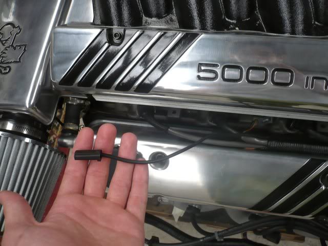

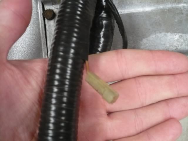

anyways yesterday we got the wiring loom out and hooked everything up all fits right! however there are two things i have no idea where they go or what they go to... heres some pictures!
this one is on the end of the injector part of the loom! anyone got any ideas??
and this one
its near where the loom enters the engine bay i got no idea what its for!
everything else seems to have a home atm!
however i was a little disappointed when they didn't wire it so the ICM and the other little box thing are mounted inside! :furious: hmm hopefully i can hide them somewhere...

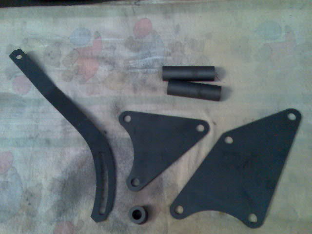

i mounted my low mount alternator bracket and it seems to all fit nicely! good little kit i bought of ebay however they forgot to send the bolts lol

Ben
#120 rodomo
Posted 20 April 2008 - 03:29 PM
The wire in the top pic. might be for the temp sender?
#121 _UNVSM8_
_UNVSM8_
Posted 20 April 2008 - 03:40 PM
yeah thats what i thought but then there was another one for that... and plus it doesn't reach :<_<: i much be missing something...

#125 _UNVSM8_
_UNVSM8_
Posted 20 April 2008 - 08:58 PM
and this one
bump :D any ideas ??
