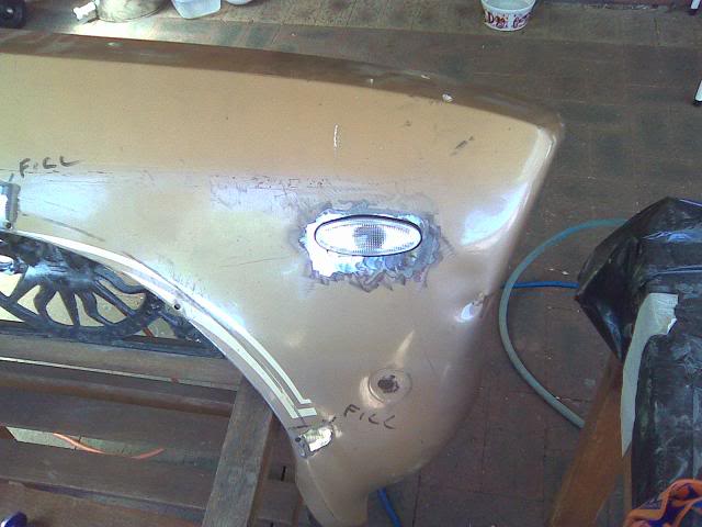

Filled a few of the dings on the drivers door today... starting to get better with bogwork now :) then I spot primed it ready for hi-fill..

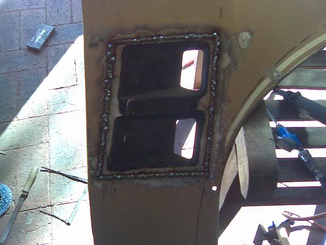

Welded the aerial hole on the passenger guard.
I bought a pair of VX Clear side indicators, but rather then hunt around the wreckers for some fkd guards to cut the section from I used some carboard and took some measurements making a template then transferred to steel and just made up a section to weld into the guard.
Then stripped the little bits of paint that were left and gave it a coat of Epoxy

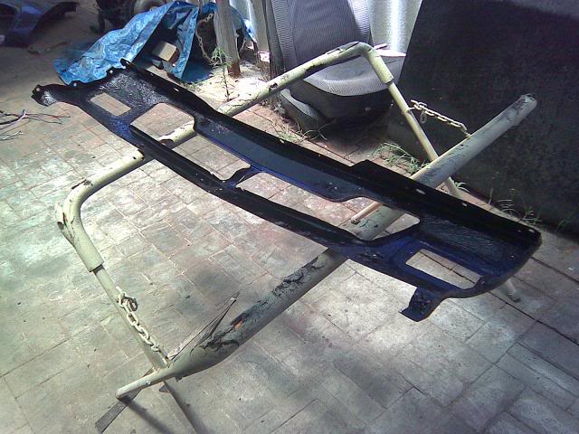

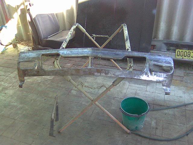

Stripped the front apron and cut out what was needed for clearance of the front spoiler, then coated the inside with POR15
Welded in the drivers side guard flutes and Clear indicator mount
Hi-filled the flares and front spoiler
Stripped the drivers guard and coated the baremetal sections inside with POR15

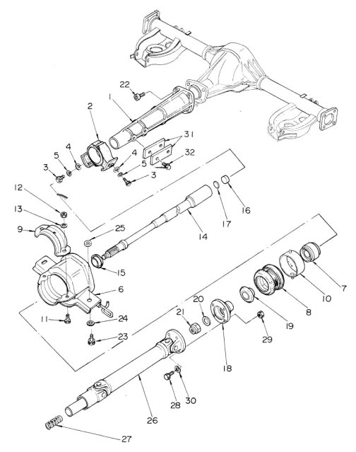

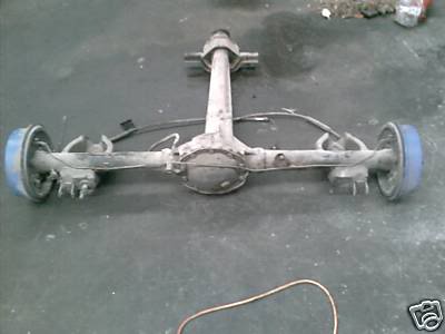

Maybe someone could shed some light, When I was launching alot of the times the rear end would bounce and shake about a fair bit, Whats that caused by? I thought that only really happened with leaf spring cars?
this might fix it

Not street registrable tho... and not the best handling kit either...

Agree, but my point being that to me the gemmy's seem to suffer from the diff winding up like a spring and when you take off this is transferred to the tyres so maybe look at some form of better restraint.
You only have to jump in an auto and stall it up to see what Im talking about.

They have a central torque Tube tho which is mounted to the front of the diff and bolted to the floor as a 3-link setup..... so its already pretty much the same as the McDonalds kit, except the mcdonalds link has no bushes.
I dont see where there is any allowance for it to wind up :S
Anyway I fitted semi-slicks after that first meet and it was launching heaps better, .2 second faster 60ft, even got a PB Trap speed of 103mph... but had issues with the tune after they tweaked it and everytime I changed gears it would bog down so not PB ET :/

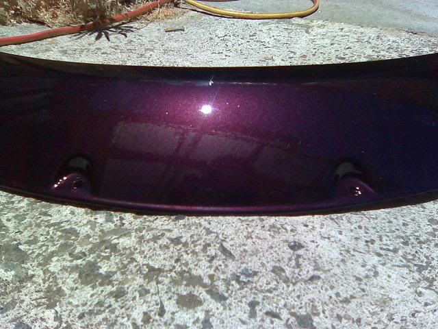

But all the bolt on panels are ready for paint, just need to finish the shell now and my Paint was finally ready after having to wait a week for the right tinters to come from east states and I was keen to get a preview so I sprayed one of the flares :) and mmm I really like the color, it really is 2 colors. in the shade its just a nice gloss black but out in full sun is when it really shines and brings out the cherry metallic.
Was pretty hard to capture the effect with my crappy phone camera but here's the best I got.
Came out a fair bit orange peely tho which I wasnt happy with.. I think it was a combination of me not putting it on wet enough, my gun not being set properly (i still go no idea how to do that properly) and cos I used Normal thinners which are rated at 20-30'c and it was about 35' on the day which means it dries faster and doesnt have time to flow out nice and level.
But when I spray the rest of it in the booth ill have my mate with me and he will show me how to sort the gun settings and choose the right thinners etc :)

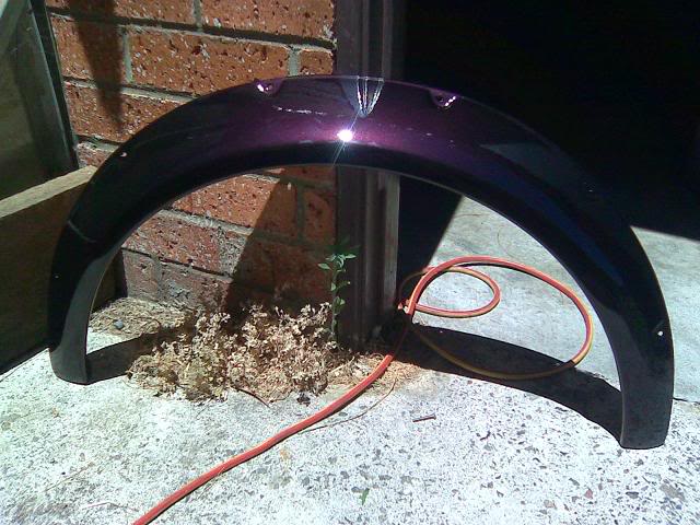

Anyway he didnt get stuck into it untill about 4 weeks ago and the shell is just about ready :D I went and visited him on my break and we rubbed back the flare I had painted earlier (too much orange peel) gave the lot a rub quick rub down with 800 and set up the booth, he sprayed 2 flares and give me a few tips and I sprayed the other 2... and wow they turned out awesome, Even he was very impressed (he usually uses protec paints, where this is PPG.. he said he would NEVER get a finish like that off the gun with protec paint... We could spray it alot wetter (then he normally could with protec... he said if he had done it that wet with protec it would of all ended up on the floor)
My reflection
His reflection
We had the flares laying flat tho, gonna wait and see when we do a panel standing up (ie doors) and see if we can still spray it as wet and not get any runs.

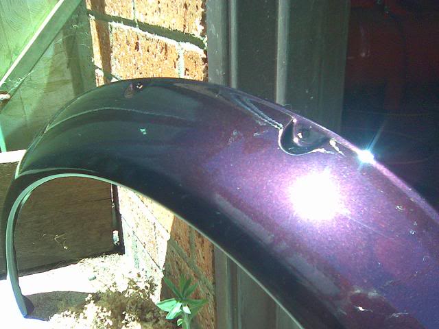

We sprayed the doors this arvo, did the same thing... he sprayed one door while I watched then I sprayed the other copying what he did as best I could, hehe we both got a small run in the same spot (the bottom of the handle indent) but only in the clear so will easily be able to sand it out.
Doors didnt turn out quite as good as the flares... you can just make out the slight orange peel in the pics, Think it was because they were stood up and we couldnt put it down as wet. But there straight as which was good considering how bad they were when I started.
