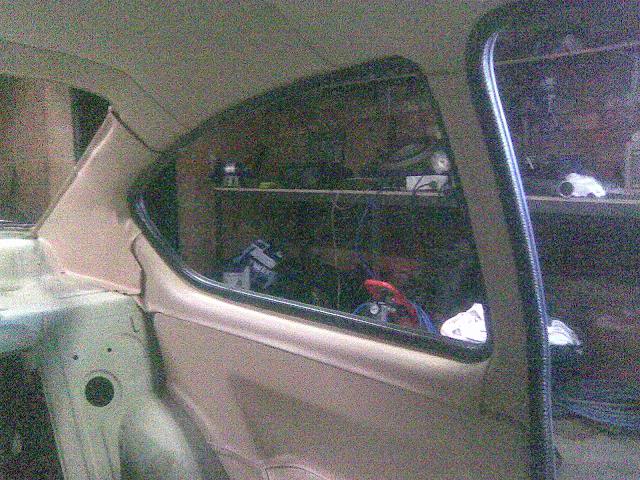

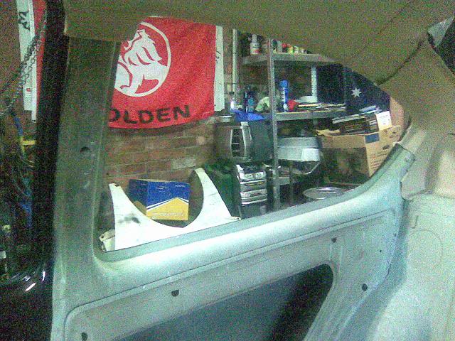

Well I had asked the trimmer to trim the B-pillar and the section under the rear 1/4 window also, but he rang me yesterday and said he couldnt do it because there is nowhere to tuck the materiel under because the slot where the rear trim panel slots into is too tight and another layer of vinyl would stop you from fitting it... So I jus said oh ok guess ill have to paint that area.
But was looking at it and thought nah its do-able so I gave it a shot today...
Before:
After:
All I had to do was to bend the lip out a little more to allow for the extra layer of vinyl and it turned out pretty neat. altho It took my like 4 hrs to do that one side haha, making sure I cut the vinyl right... but ive got a template now so the other side should be easy :)
See people, dont be scared to give something a go... even if someone tells you its not possible...
