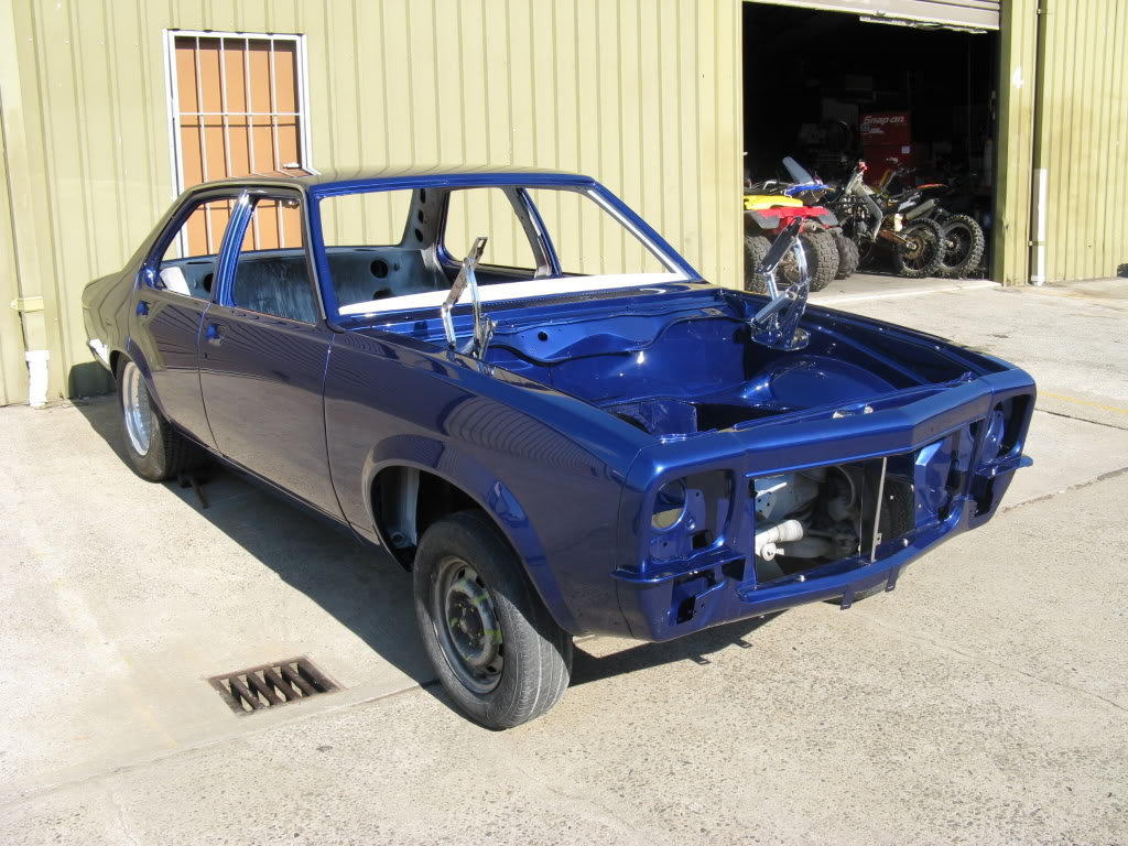

Moot that engine bay is awesome, and didn't realise till I looked but it's going to be very similar to ours, the 2 firewall seams removed and chassis seams trimed, flat plates in both the sections where the battery and charcol canister were, brake line holes in the guard smoothed, heater box section smoothed, mate theres a lot of work in that engine bay, looks fantastic. Can't believe you thought of selling it, keep on it moot it's gunna be an unreal car when done.

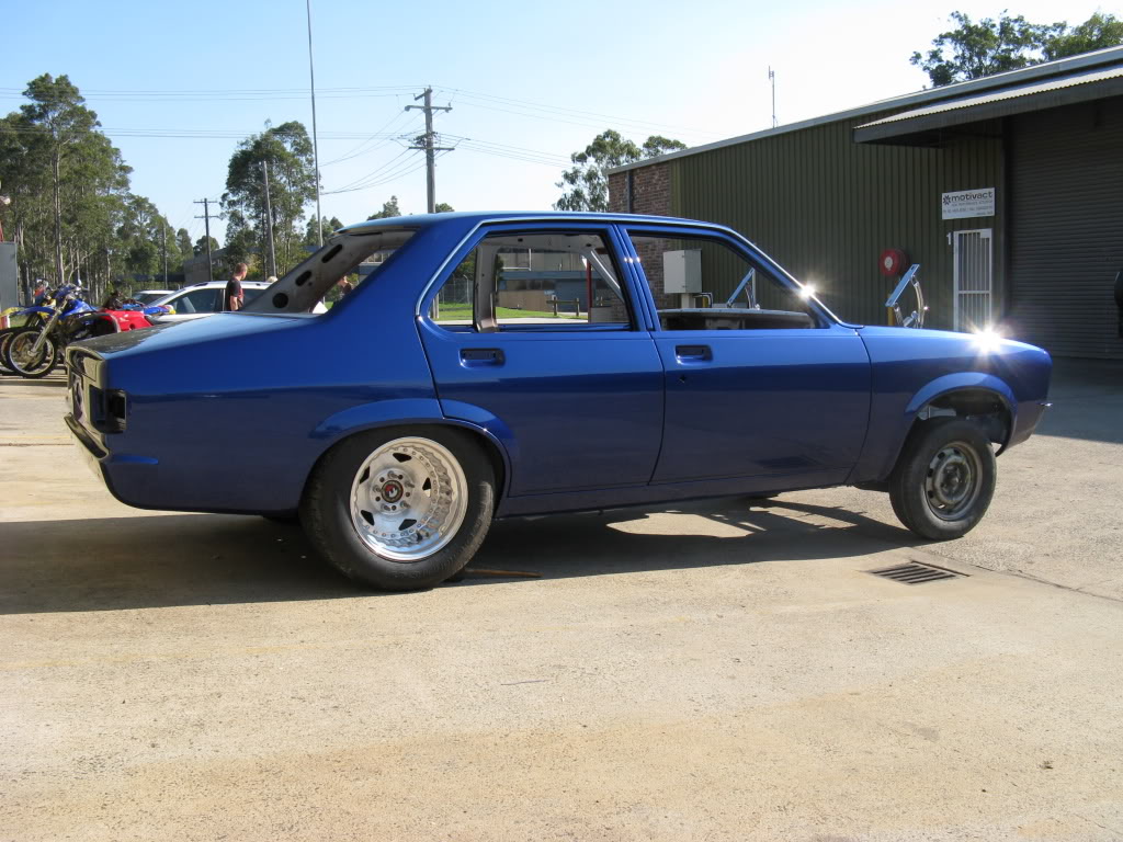

is there something going on with 2Tough interior wise? or is it coincidence that it is in that picture when i last saw you you were saying something about a new interior
#155 _HRV74_
_HRV74_
Posted 26 April 2009 - 10:01 AM
Just a coincidence that one. Went for a cruise down to Moot's workshop to catch up with him and meet the touring Garth (fatslr).
Perhaps later in the year the interior changes will become reality.
Cheers, H

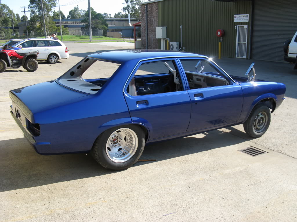

#156 _HRV74_
_HRV74_
Posted 26 April 2009 - 04:52 PM
A few more......
#157 _moot_
_moot_
Posted 26 April 2009 - 05:07 PM
thanks for the pics mate :spoton:
the one peice roof linning should be in it tomorrow, and all the front end is ouf of it getting powdercoated.
